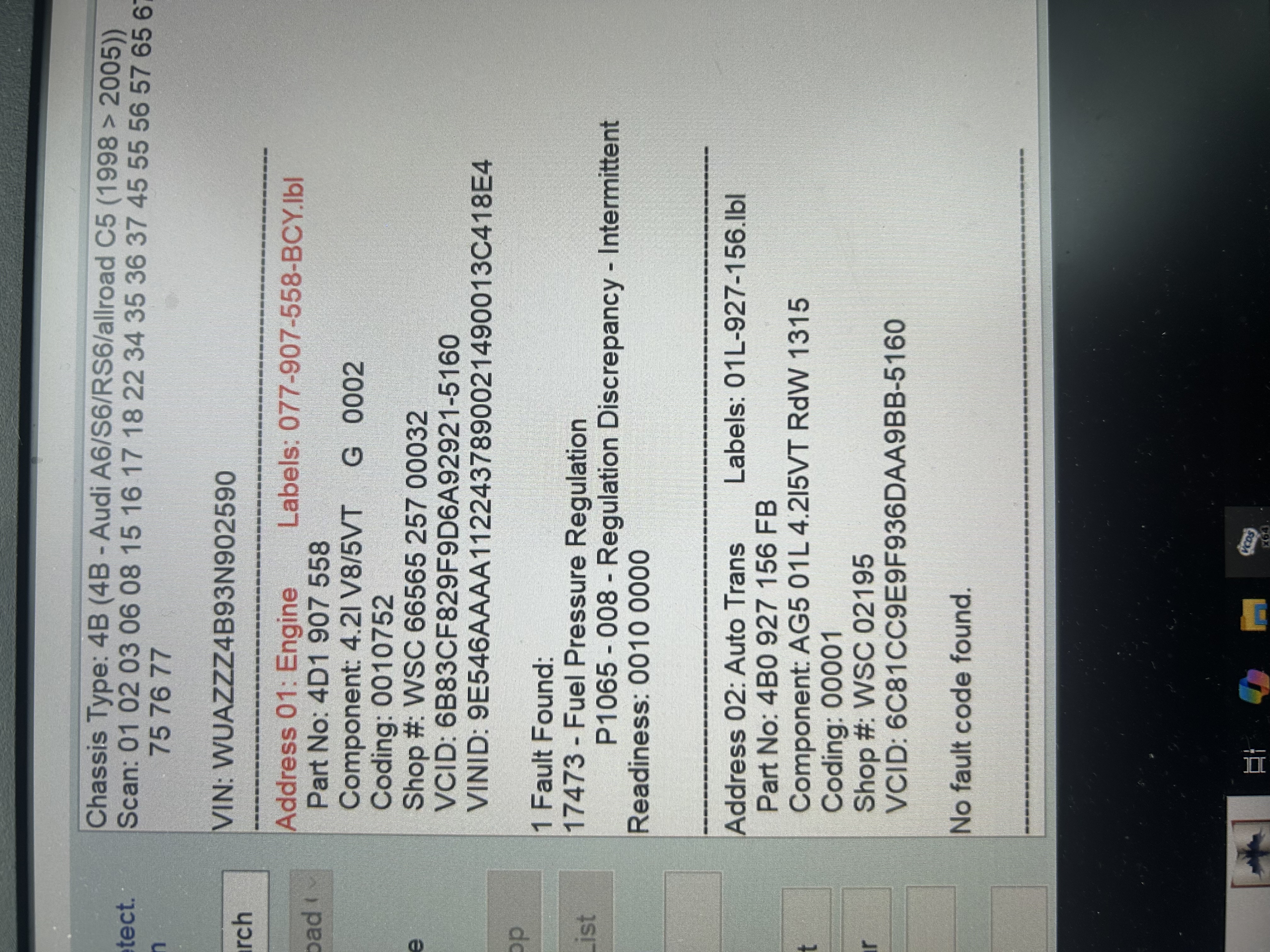

Re: Breakdown
This is the error message.
On start up uneven revs and an intermittent noise that you can hear while sat in the cabin.
I am wondering if it’s the pump inside the fuel tank.
At the moment it’s settled down and even revs and no noise.
Re: Breakdown
Yeah, if the lifter pump isn’t feeding properly that could cause the main pump to be starved. Good job you’ve got a spare in-tank pump now.
I’m not familiar with that error code. I’m going to look it up.
