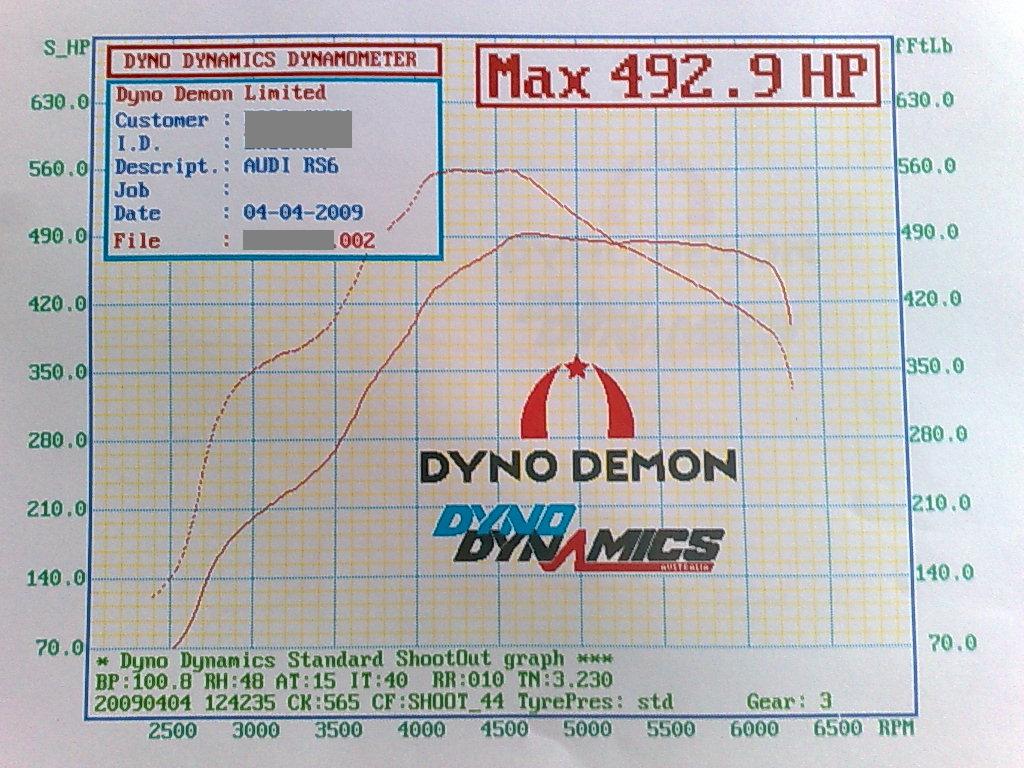

el_ringo
Posts: 1482
Joined: Thu Feb 15, 2007 9:45 pm
Location: Now in W Yorks
Post by el_ringo » Sun Apr 05, 2009 11:49 pm
Hi,
I put my car on the rolling road yesterday and got the following results.
I have the Custom Code Phase 1 remap with standard cats and exhaust. When the map was put on last summer (by Grizz) I had new MAF's, DV's and N75 valve to make the most of it. A service and two new intercoolers also helped.
The run was done immediately after a 4 hour drive so the air intake temperature was sky high (>50oC)
I am very pleased with the torque figure of 560ftlb (760Nm) and I am sure the power of 493 BHP (367Kw) would easily pass 500 with some time to cool the engine bay.
Boost pressure was good, peaking at 1.1 bar and slowly tailing off to about 0.8. It is a shame just under 100 horsies are lost in the transmission.
R
Joules
Posts: 377
Joined: Sat Mar 08, 2003 6:45 pm
Location: UK Chester
Post by Joules » Mon Apr 06, 2009 7:25 am
Looks very good!! with an excellent profile for power. Could you post the boost profile too.
C63, (C6) RS6 Avant, (C5) RS6 Avant, (B5) RS4 Avant, RS2 Avant, S4, S2, EVO IX 400 BHP
