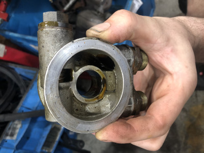

Shoppinit wrote:
Sat Aug 12, 2023 7:39 am
I have a feeling that there is a mechanical thermostat in the oil cooler circuit. I need to check the workshop manual.
I would replace the oil thermostat. If it's not available separately, then get a whole new cooler. I bought one for my Golf once. Not very expensive:
Mɐʇʇ
Posts: 2727
Re: Normal oil and coolant temperatures
Post by Mɐʇʇ » Fri Oct 20, 2023 4:11 pm
Agreed. And looks very accessible - it might fall into that small subsection of the workshop manual that does not start with "Remove Engine".
Steve2003rs6
Posts: 2968
Post by Steve2003rs6 » Fri Oct 20, 2023 7:18 pm
Had the seals replaced at unit 20 last time I was there.
The large seal had gone really hard over time. Took ages to persuade it out with a hammer and appropriate screwdriver. Eventually came out a small bit at a time. Thankfully lee had a spare seal.
