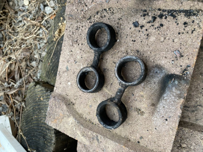

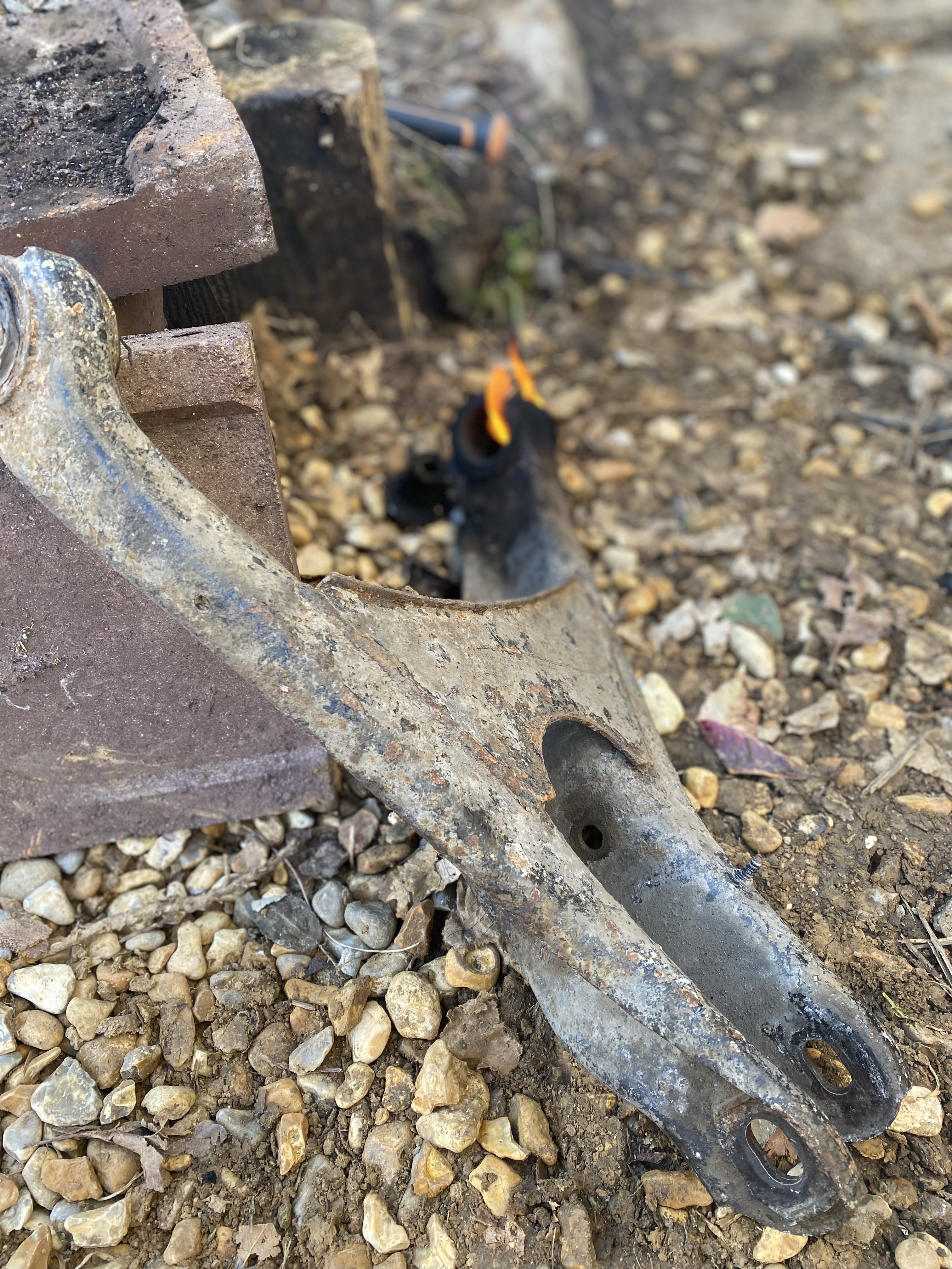

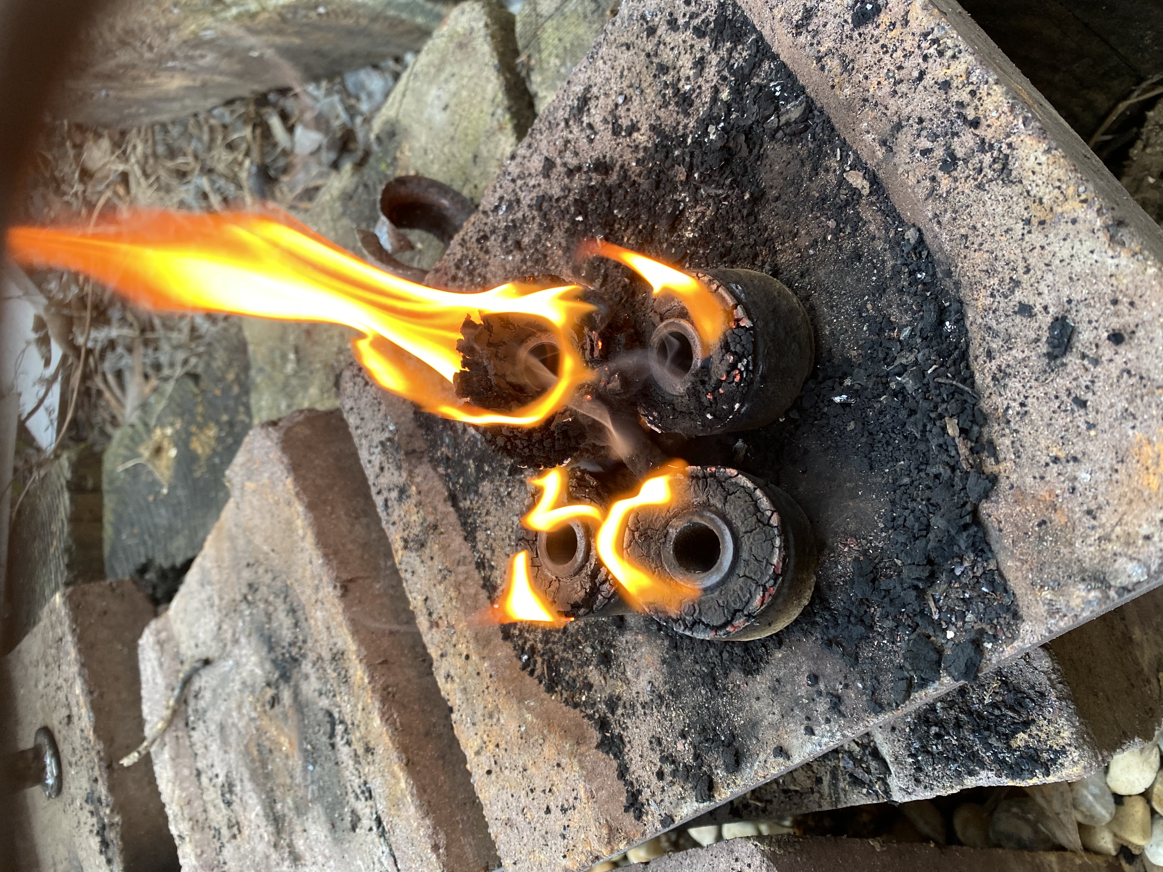

I made a little more progress finally removing all the bushes from the upper and lower control arms along with the ARB links. Big thanks to Matt who has been reply to my texts asking for help. 👊
Mɐʇʇ
Posts: 2725
Re: Rear end suspension rebuild
Post by Mɐʇʇ » Sun Feb 26, 2023 7:00 pm
It's not often I get an opportunity to tell people to "burn it with fire"
ChrisA
Posts: 809
Post by ChrisA » Sun Feb 26, 2023 7:42 pm
You were very enthusiastic with you encouragement to perform said tast. 🤣
Mɐʇʇ
Posts: 2725
Post by Mɐʇʇ » Sun Feb 26, 2023 7:44 pm
Made even better by the fact that I was telling a fireman to burn it with fire.

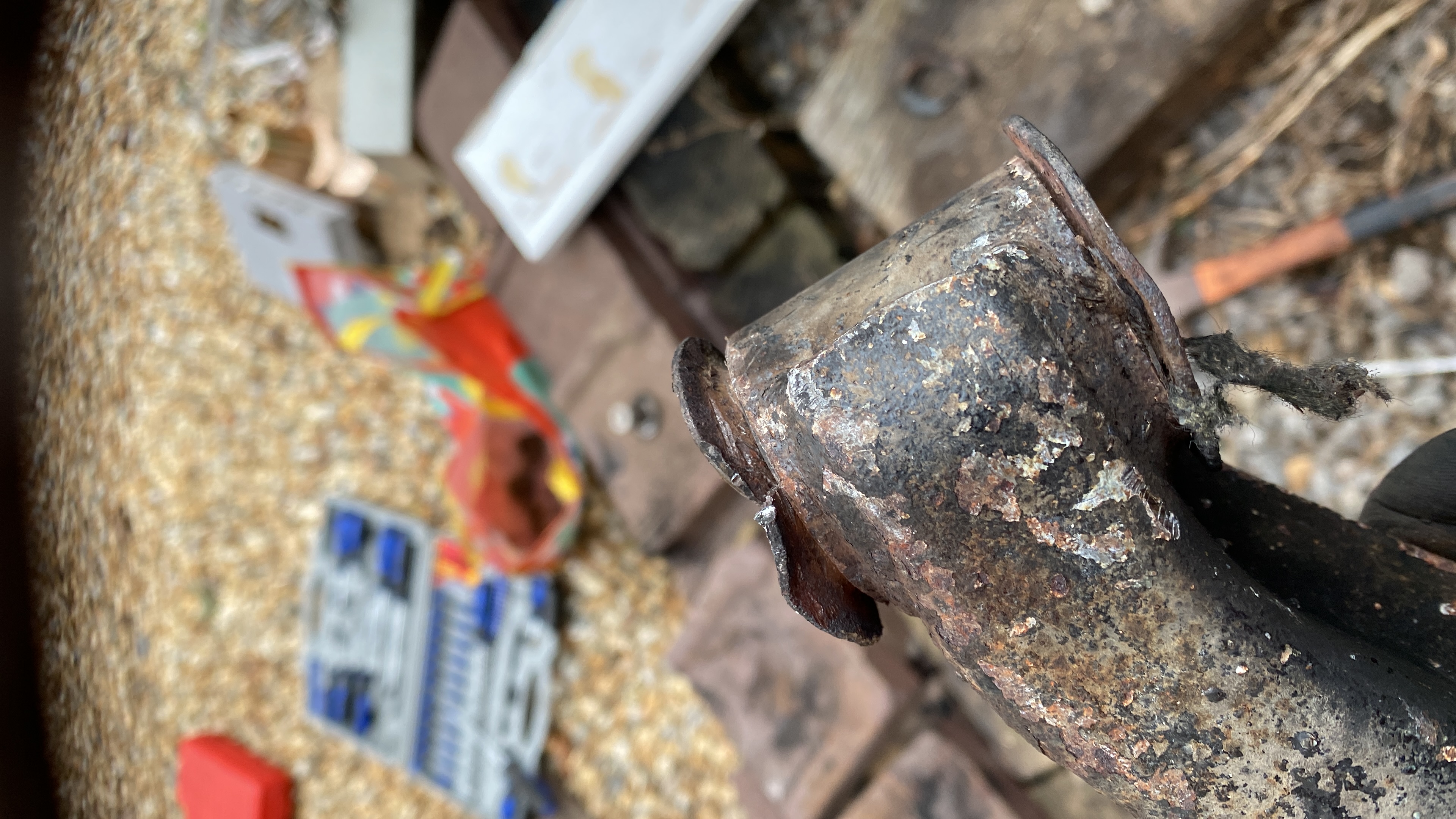

ChrisA
Posts: 809

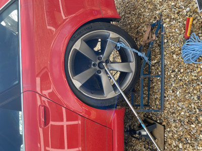

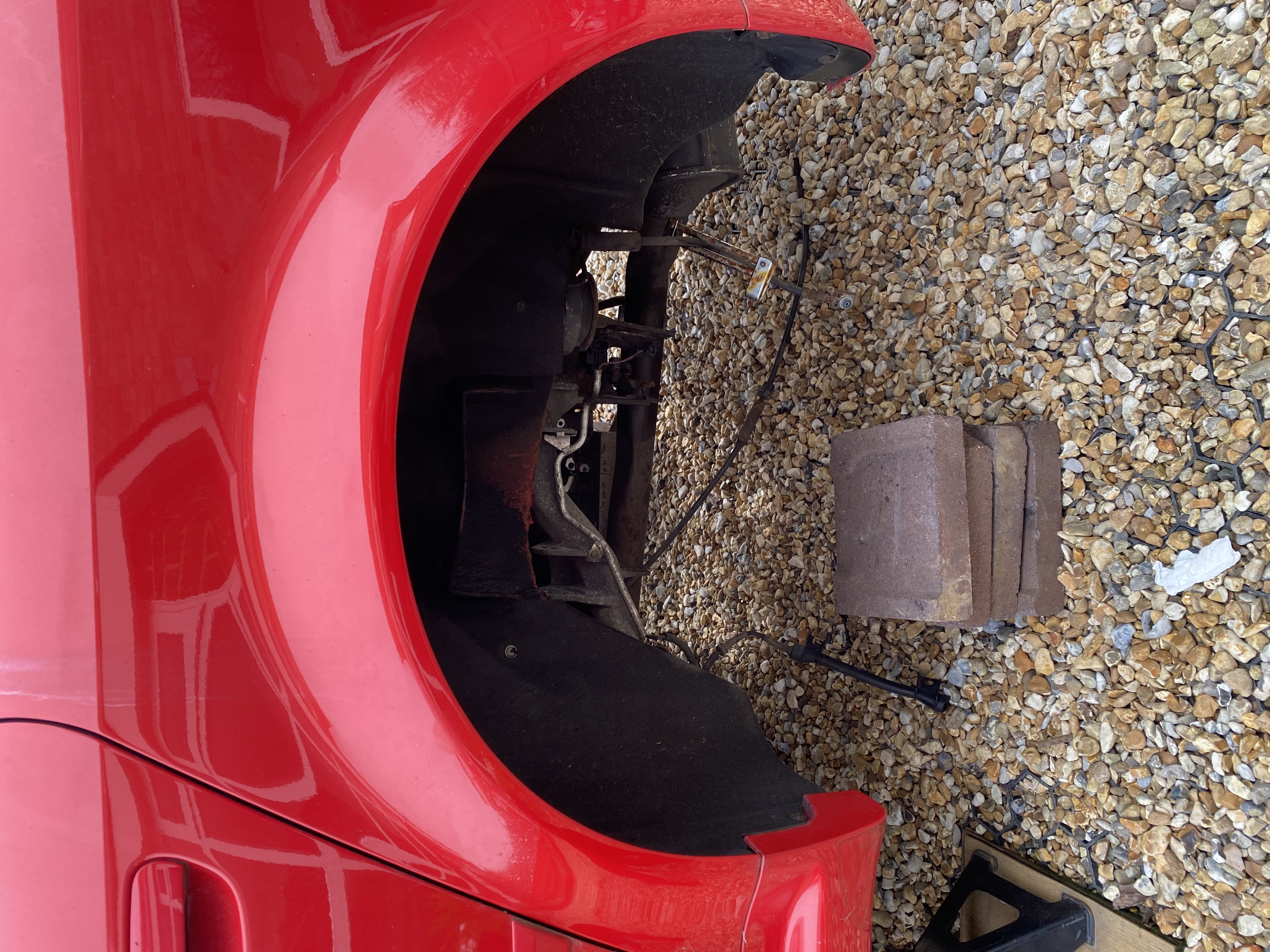

Post by ChrisA » Mon Mar 13, 2023 4:30 pm
When your refurb goes further than you intended and you realise you should have to loosened the collar before taking the coilovers and control arms off. Improvise, adapt, overcome!
Big thanks again to Matt!!! 👊

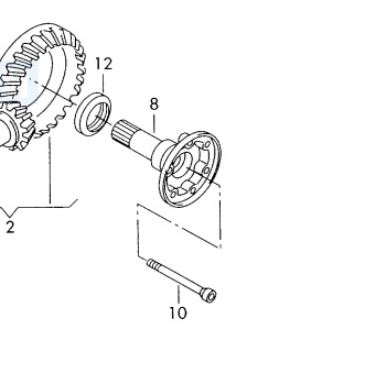

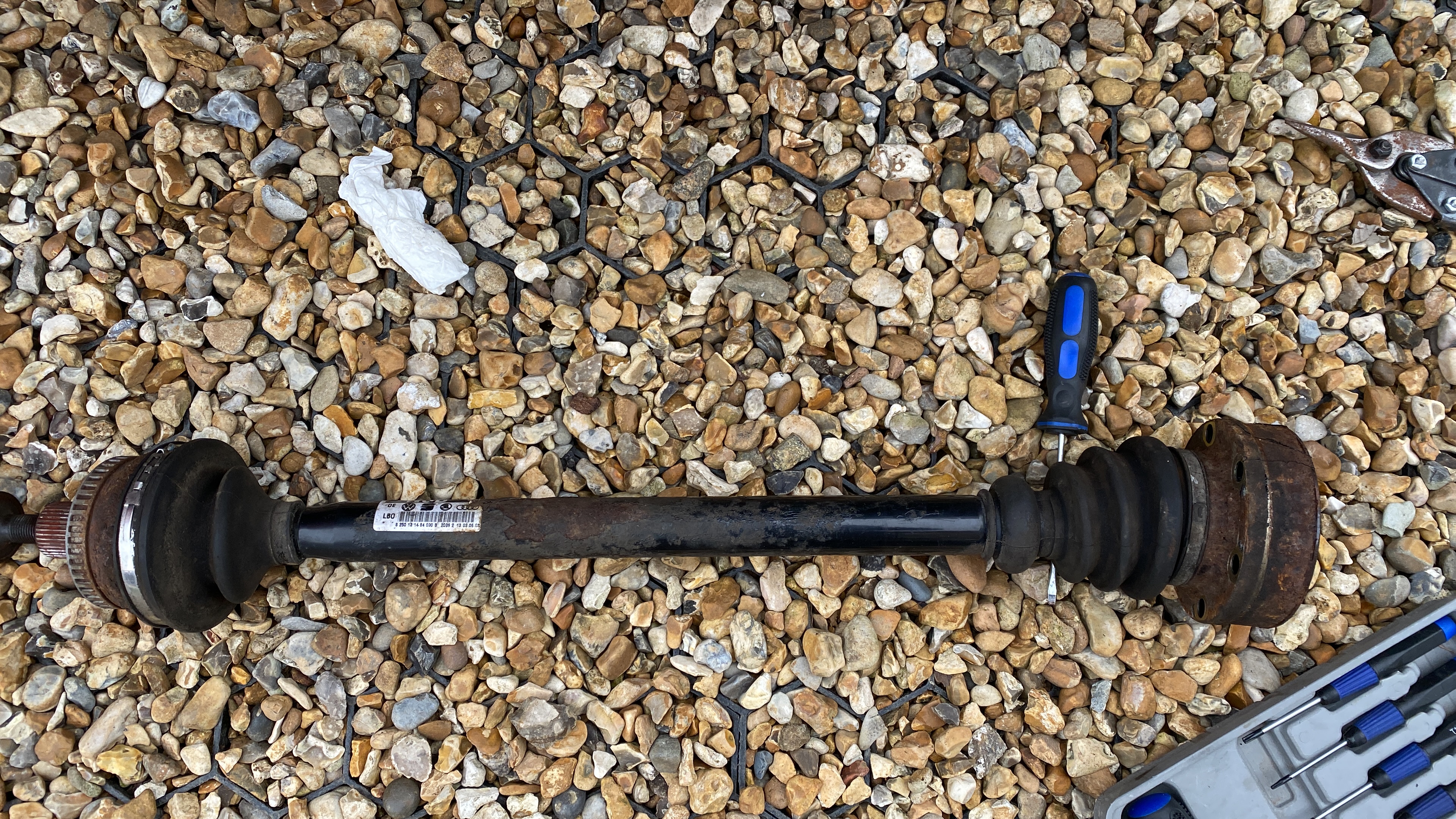

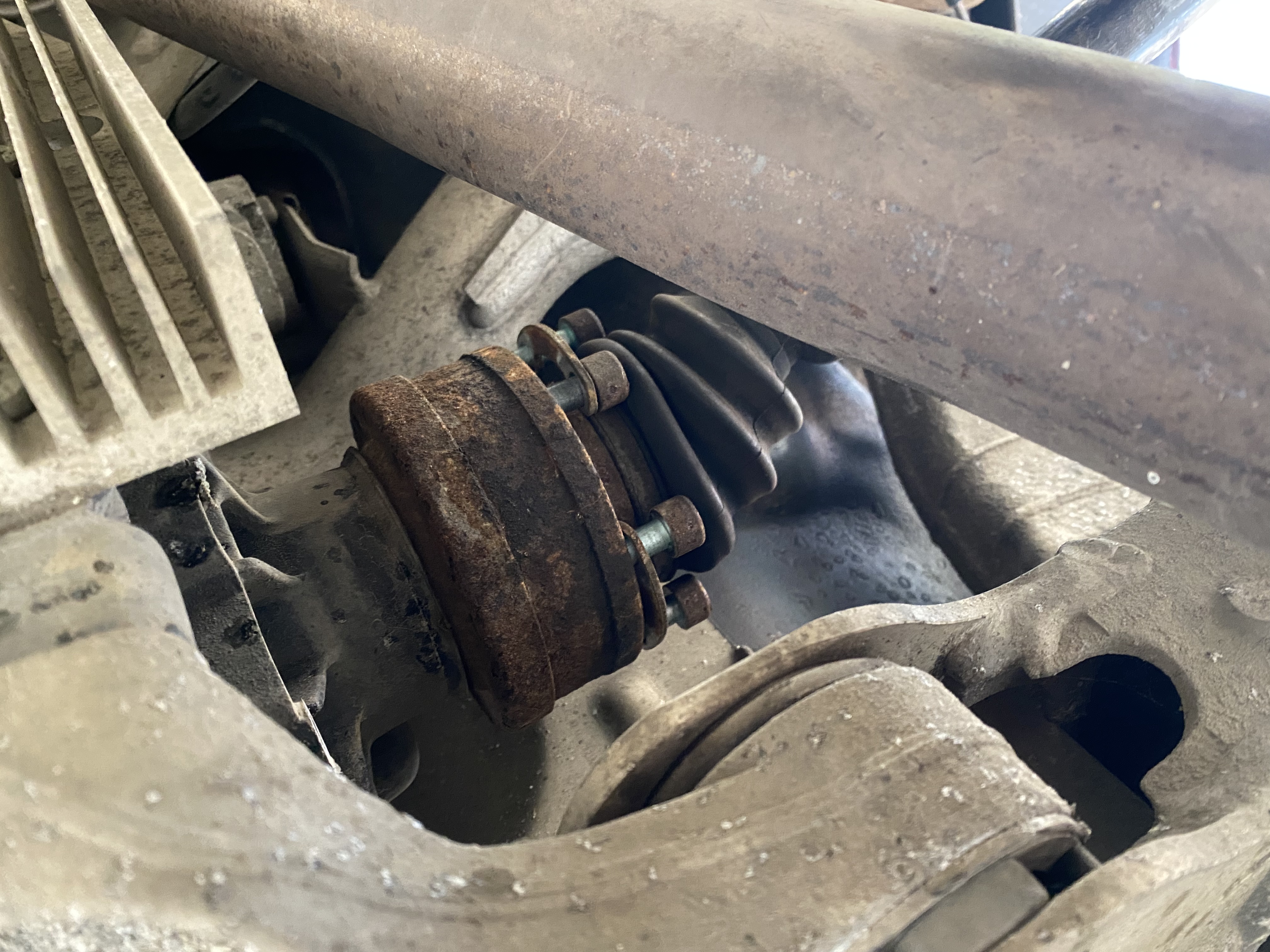

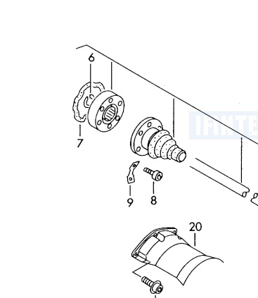

I’ve loosened the bolts holding the drive shaft to the diff but they’re not parting. Is there something I’m missing or am I just being a pussy?
Mɐʇʇ
Posts: 2725
Post by Mɐʇʇ » Mon Mar 13, 2023 6:34 pm
Give it a tap. 20 years of rust sticking them together.
Where should I tap it, do you think it splits after the disc closest to the diff?
Also any recommendations for the replacement?
https://m.autodoc.co.uk/car-parts/oem/4d0598103
Mɐʇʇ
Posts: 2725
Post by Mɐʇʇ » Mon Mar 13, 2023 7:29 pm
This should help explain. So the inner flange stays where it is, but the middle and outer should come off.

ChrisA
Posts: 809
Post by ChrisA » Mon Mar 13, 2023 7:50 pm
Cheers Matt, that does make it clearer. (Must resist withdrawing bolt 10 to clean up the flanged shaft). 🫣

Post by ChrisA » Wed Mar 15, 2023 2:28 pm
