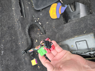

Post by Frazz82 » Thu Feb 29, 2024 7:25 pm
Is the harness under the seats linked to the CCM at all as I was messing around with it prior to the battery dying an the door fault was not there before the battery died and I messed about with the harness.
