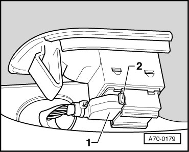

It took me ages to move the images and convert them to be viewable here, hope you appreciate the effort...
Vehicles with hole on underside
– Insert screwdriver -3- in hole.
– Use screwdriver -3- to press retaining tab -2- in direction of arrow -A-.
– Take out window regulator switch unit -1- in direction of arrow -B-.
Vehicles with no hole on underside
– Mask door trim with adhesive tape -4-.
– Take out window regulator switch unit -1- in direction of arrow.
All vehicles:
Press retaining tab -2- and pull off connector -1-.

Check the underneath, there may be a hole, if not then the second picture applies.
Mind the work Shop manual is written for left hand drive vehicles...
