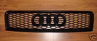

Etching primer is a primer that eats into the surface of whatever its being sprayed onto to give you a better key! The surrounds and badges are actually plastic but are somehow coated with metal! Dont worry though, the etching primer doesn't eat in as far as the plastic! As I said though its a good idea to give them a light sanding before priming as well to give them an extra key! Especially the badge which is like spraying glass if it isnt prepped properly!
Heres a pic of my spare grill that was done......it never actually made it onto the car, I ended up sticking with standard!
