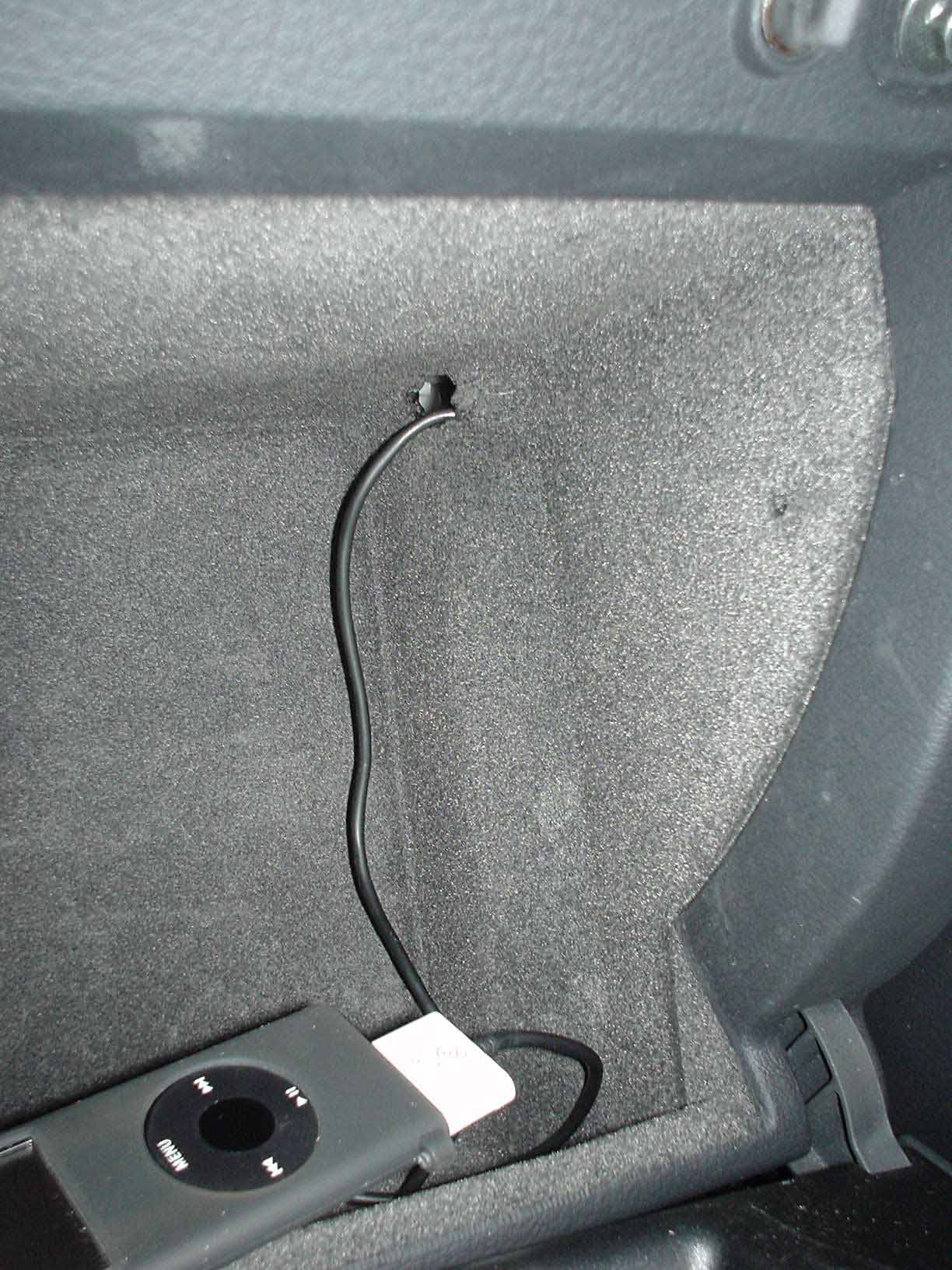

Hi Phil,
Mine connects directly to the ipod via the socket in the bottom (the icelink plus has the same plug that is supplied with the USB cable with the ipod if that makes sense).
As i said, I had to make a hole in the glove box side so the connector fitted through.
You can get other 'dock' units but I wanted to hide mine in the glove box.

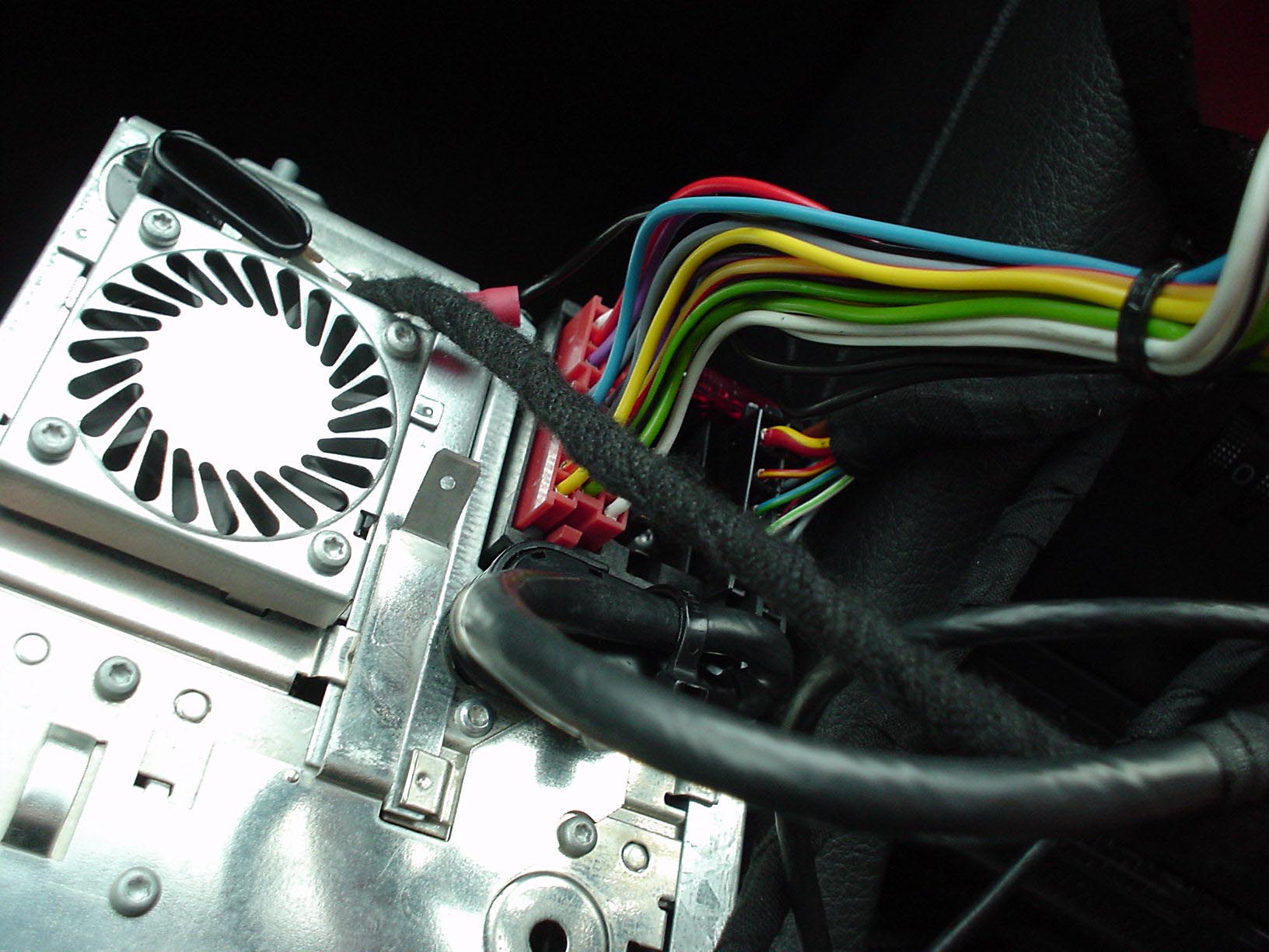

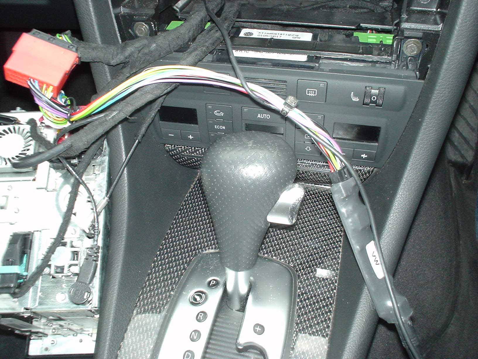

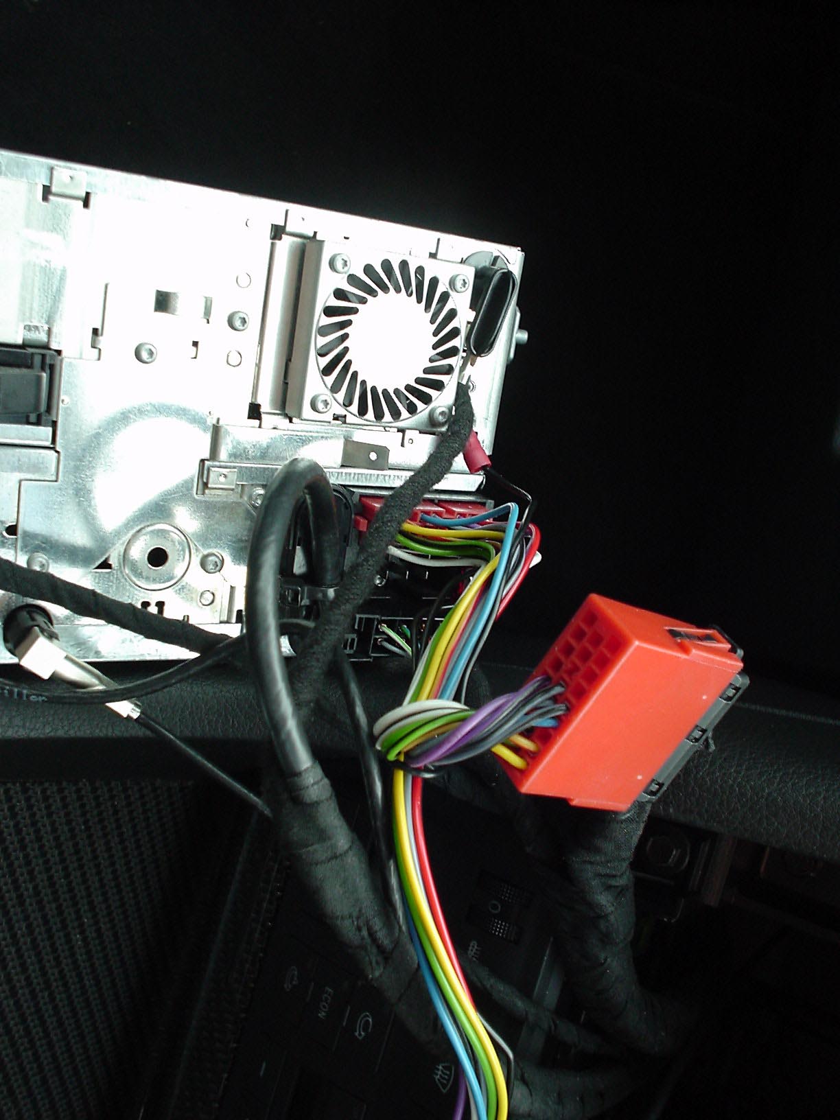

Hmmm, I am confused now??!!
What I have is the Dension Icelink Plus v2.x. This consists of the electrickery bit (long tube box with dension sticker on) - which acts as the interface and is about the size of...well about 10cm long x 2cm wide x 2cm deep. One end of this has hard wired cables which plug directly into the socket that the CD plug goes in and there is a second single wire that plugs to ground. The other end has a small round din socket. Now I have a wire which at one end has the iPod plug which plugs directly into my Nano and the other end has the small round din plug which plugs into the Denison bit so i had to make a small hole (around 1.5cm diameter) in the side of the glove box to feed the cable through.
Getting the RNS-D unit out is easy just 4 'keys' and it slides nicely out you just then have to unplug the CD, plug in the Dension and the ground lead and then feed the wire from the glove box (I had to drop the glove box - about 5 screws) into the centre console so it plugs into the Dension unit.
Fairly simple I would say - the difficult bit is supporting the RNS-D head unit while you connect everything and put loads of wrags everywhere to protect your gear stick and trim!!
Now for the functionality - It is very limited and took a while to get used to!! You basically have your 6 CDs listed on the display as usual but the first 5 are your first 5 playlists and the 6th CD is to access the Denison\Ipod display on your iPod but because this is in the glovebox is useless!!
What I have done is set up 5 playlists Rock, Dance, Indie, Male and female vocal and then I put on a few CDs in each playlist. You could put loads on but then you have to skip to the next album which can be annoying as there is no indication of album names just numbers, for example if you have 10 albums in Rock each with 10 tracks on there will be 100 tracks on CD1??!!
You can also have shuffle on the ipod but it is difficult to stop this while you are moving as you have to go to CD6 (which accesses the Denison menu on the ipod and turn it off).
I hope this helps????
Cheers,
Lig.
Cheers,
Lig.
