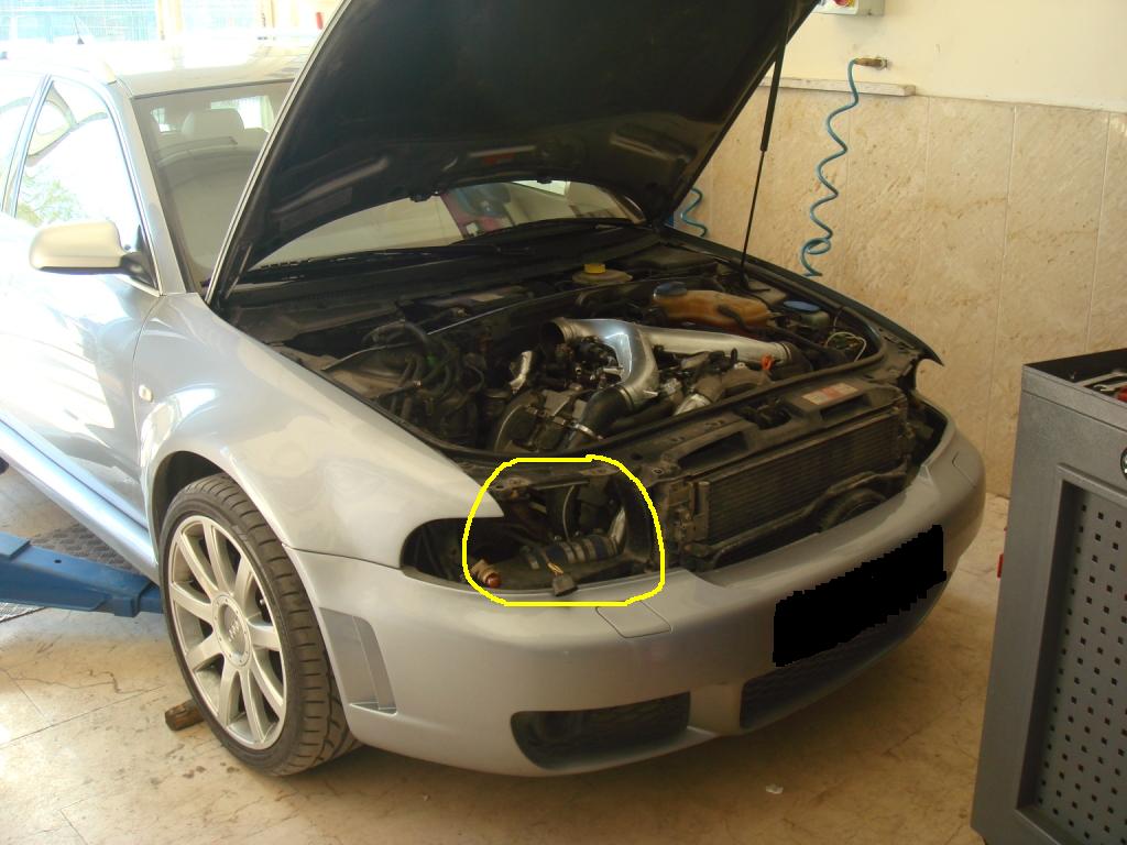

Any pictures of your install?
Mark
tolga
Posts: 5
Joined: Wed Mar 23, 2005 10:24 am
Post by tolga » Tue Aug 07, 2007 9:07 am
I found this, hope it helps...
