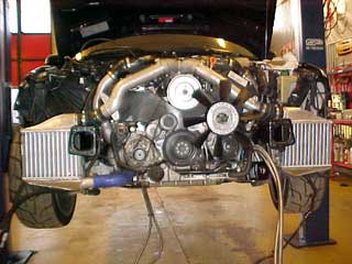

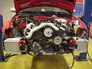

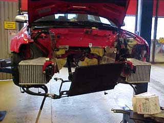

I believe Sportec did bigger Rs side mounts can any one help with this? Supplier Cost and dimensions.
Also Dahlback appear to have a solution and I expect this is also utilised by mtm, but I cant find any info from the net. Again Supplier Cost and dimensions if any one can help.
Here are the big babies on the 570 bhp Dahlback car. Huh...

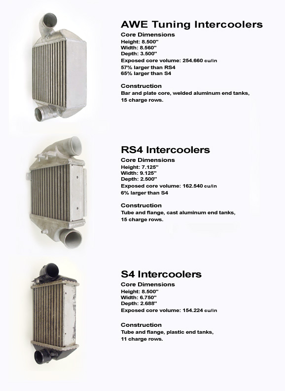

The AWE IC's are something like 57% larger core surface area than stock RS4 - is this not big enough for you? How much bigger are these bad boys..?

I think the AWE coolers are good but they get their surface area from being deeper which isn't all good, the air getting warmer as it travels through the fins. I think these guys are wanting a larger frontal area...

When I was reading the AWE site, I got the impression (from AWE's own tests) that the AWE ones are only marginally better than OEM RS4 - is that correct?
RE: up rated side mount intercooler B5 Rs4 MTM Sportec Dahlb
Yes, I'd like to better understand what is going on here.
Although the RS4 IC's are only 6%(?) larger than S4, the RS4 IC pipework is larger resulting in better flow? The AWE pipes are same size as S4.
The pipes on this look RS4 size...

David,DavidT wrote:When I was reading the AWE site, I got the impression (from AWE's own tests) that the AWE ones are only marginally better than OEM RS4 - is that correct?
The AWE site shows some pretty impressive graphs, but I'm not sure what to conclude from them, to be honest...
Clive
RE: Re: RE: up rated side mount intercooler B5 Rs4 MTM Sport
Correct assumptionI think the AWE coolers are good but they get their surface area from being deeper which isn't all good, the air getting warmer as it travels through the fins. I think these guys are wanting a larger frontal area...

Will be interesting to see how it compares with these :
