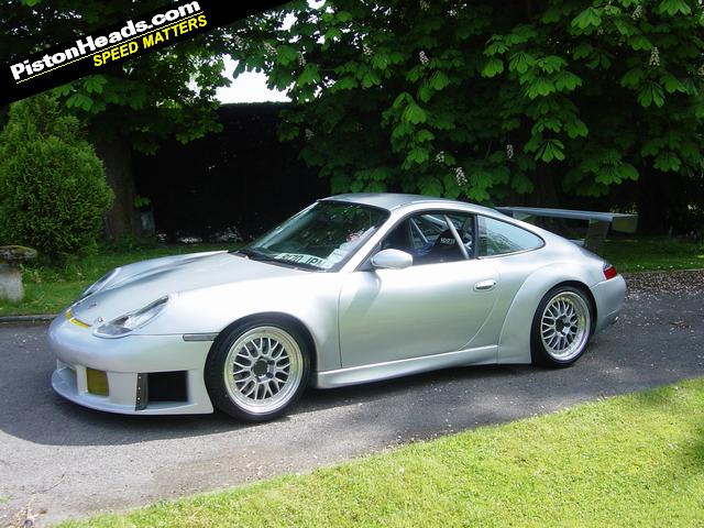

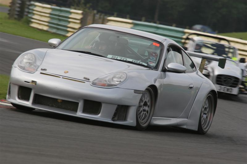

Post by Andiroo » Mon Feb 04, 2008 8:06 pm
True :( Always leave unpainted in that loverly matt finish IMHO :wink:
Althought the 996 Cup I had had a light silver finish over the carbon front and rear, looked quite nice as you could see the weave thru the paint.

Major drooling going on over those pics Andi :thumbs:
