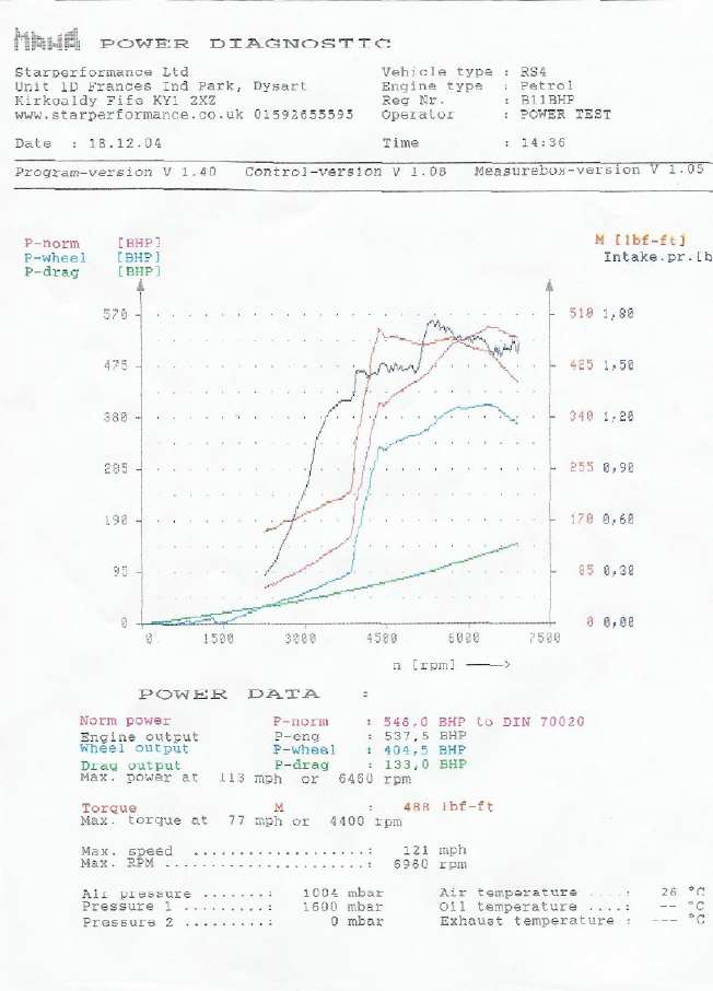

I have just had a look at the Star website, their RR is a Maha one also.
It would be very interesting to see a copy of your plot barry to compare things
such as the rotating mass and correction factor figures.

Running very similar boost to the MTM map 1.5bar peaking at 1.7. The boost wasn't the issue with the MTM map in my car it was the over fueling which inturn affected the power.

The main difference with the boost on the StarP map compared to the MTM one is when that peak of 1.7 comes in. The MTM map had a quick burst at 1.7bar lower down the rev range where as the StarP map actually bears a stronger resembelance to the standard RS4 map where the peak boost is higher up the rev range.
Graph attached - appologies for the crappy scan my scanner ain't up to much!

Post by bjacks » Fri Jan 07, 2005 4:40 pm
Laaaaaaaaaaagggg, wait for it, bang! :D
Right, got the chart out, now need to find the scanner.

Nope it doesn't feel laggggy at all tbh. Makes and holds 1.5 bar and then rises to 1.7 at about 4500revs feels like a cam coming on -really nice to drive.
