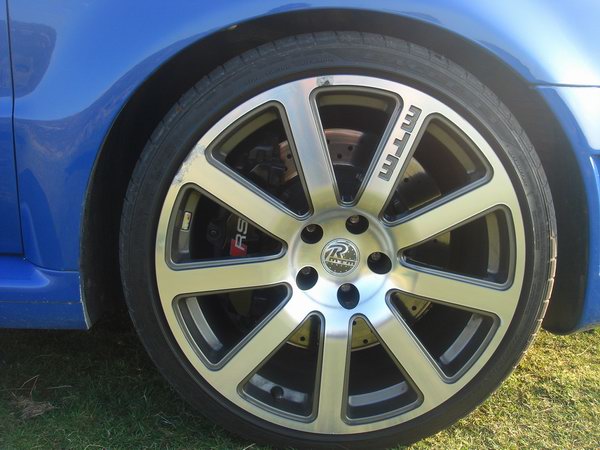

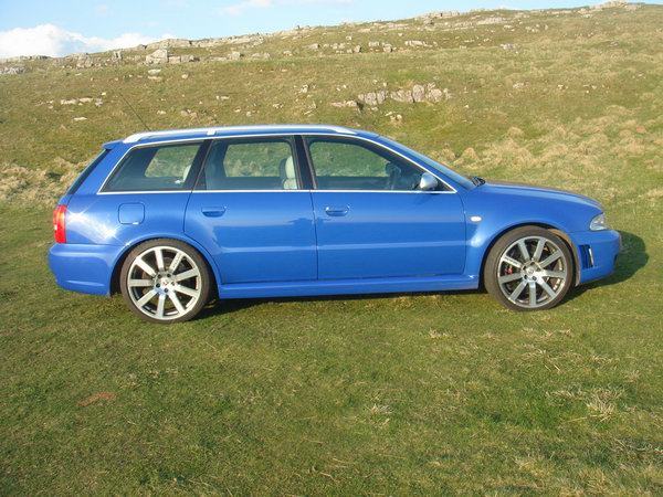

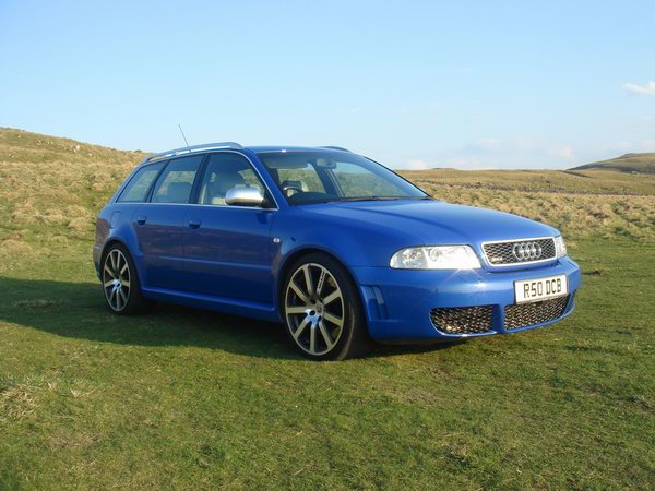

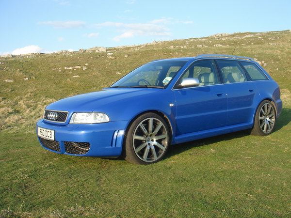

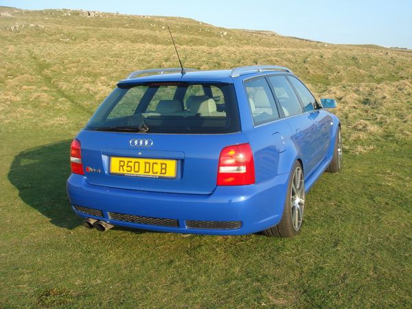

thought it was about time i did a few pics and spec..
engine..
rs4 engine
itg air filter
cut out airbox
2.4 heads (standard)
front mount intercooler
710n,s
1.0 comp dropping gaskets
std bottom end
phelonic spacers
ceramic coated mtm ex manifolds
straight rs6 turbos
heat wrapped milltek catless downpipes 2.25"
dual milltek exhaust
tanoga flywheel
uprated helix clutch
side mounted mocal oil cooler
welded up intake-throttle body pipes
boost is about 25 tapering to 22 psi
27 degrees of advance on the timing
the maf was showing 430 gs
9.5x19 mtm wheels
275 30 19 goodyear assymetrics
esp 10mm spacers
h+r fat arbs with mrc strenghening brackets
tanoga short shifter
awe dts bar

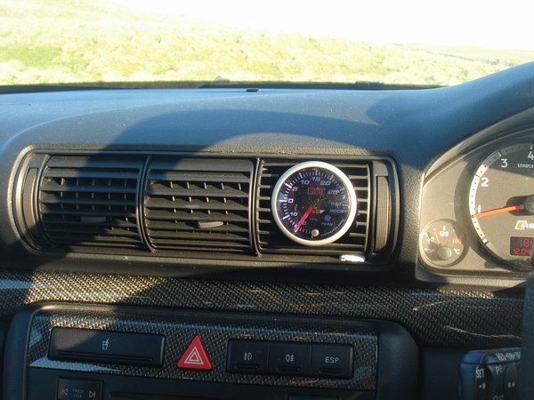

dash mounted boost gauge
carbon steering wheel
b7 brakes all round
20 gb phatnoise
laser park pro
roofrack
towbar
tracker
