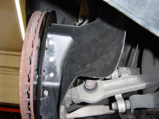

Ordered mine too this week Gav...although I'm looking at another solution too...will post details on how I get on...
Found a picture of the Phaeton ducts on the RS4...
DaveP...
