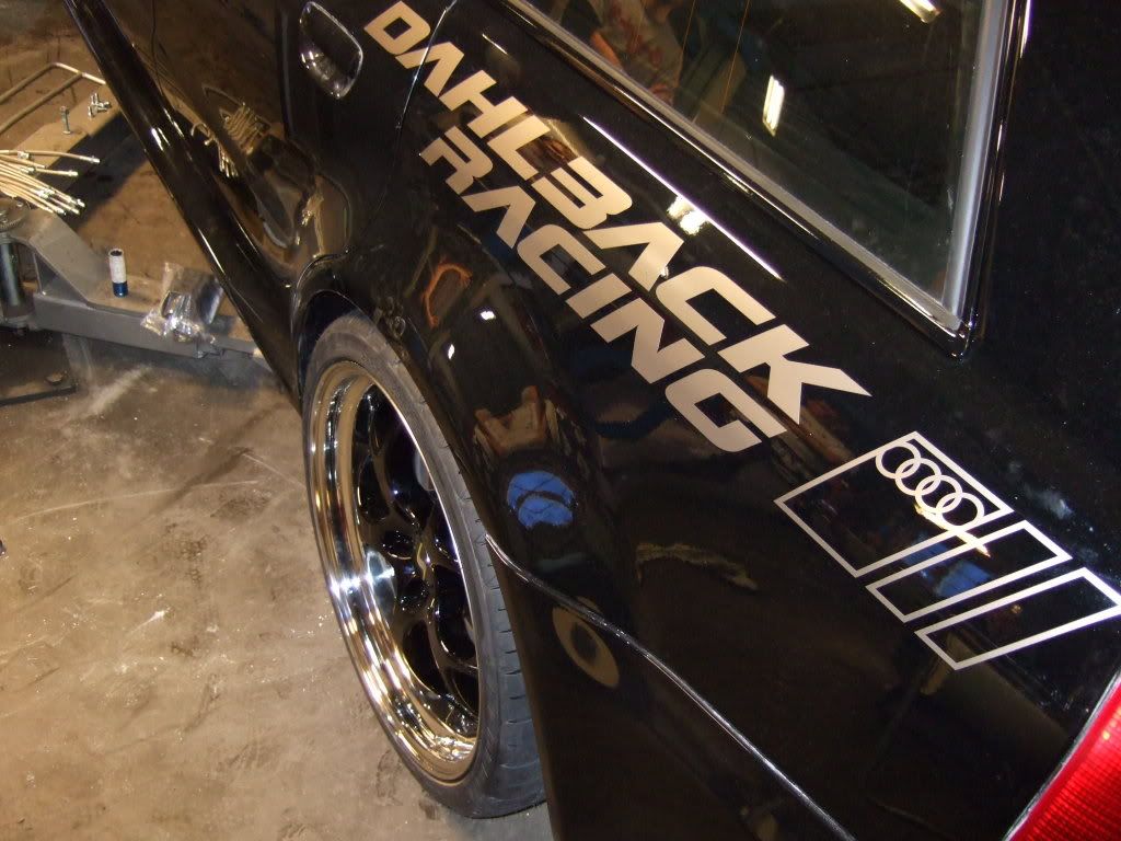

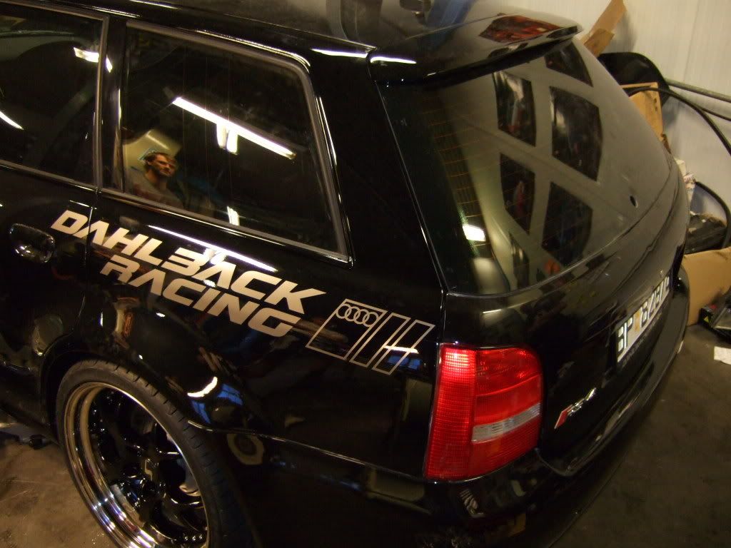

Forgot to tell you that the rims I bought for my car in the first place did not fit. The MTM Bimoto rims will have to do the trick...
It looked a little like this when we tried them on the back. The brakes in the front are just to big, lol.
Schmidt Revolution VN-Line Radinox. Special ordered with a black center. The olny set of it's kind in existence so far.
