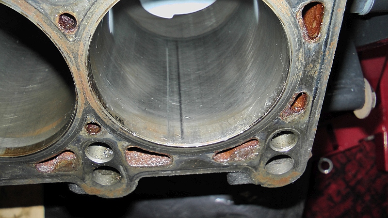

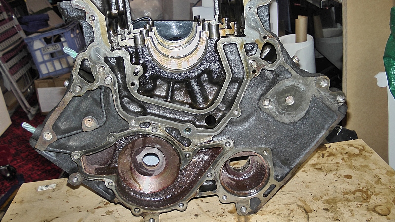

I'm in a happy place where my RS6 requires no work..at all! I have had a spare complete AZR engine for the RS4 since 2015 and it's about time it was refurbished and waiting to be used. It ingested a foreign object in the PO car and did a piston and lightly scored the bore of No 6.
A quick strip down. Very lucky to have all the more unusual tools to hand so it was a very easy task. Surprisingly the bearings exhibited a little wear which is a bit unusual but the crank was perfect.
The block is now ready to head off for machining. I'm have 82mm Woessner pistons ready to go. All expectations are that machining will remove the score and other superficial damage. I have most parts for the rebuild, bearings, full set of ARP studs, new turbos, new heads, loba cams, most seals and gaskets, tube manifolds and so on. Just a matter of joining the various queues for machining etc.

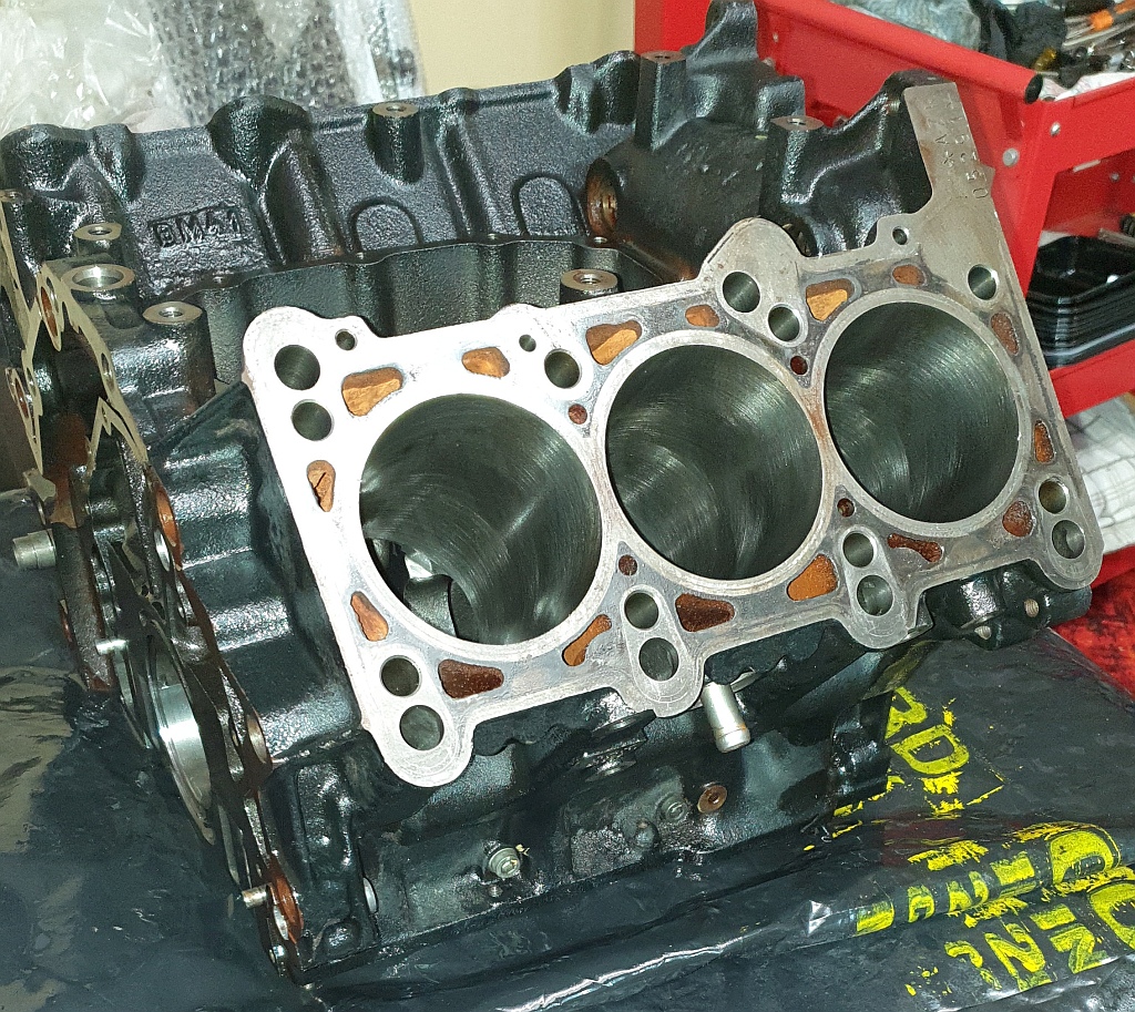

and it's home again
New capacity 2737cc.
Big clean first and then will get the bottom end and Woessner pistons in while procrastinating about whether to use the Loba mechanical cams or the originals.

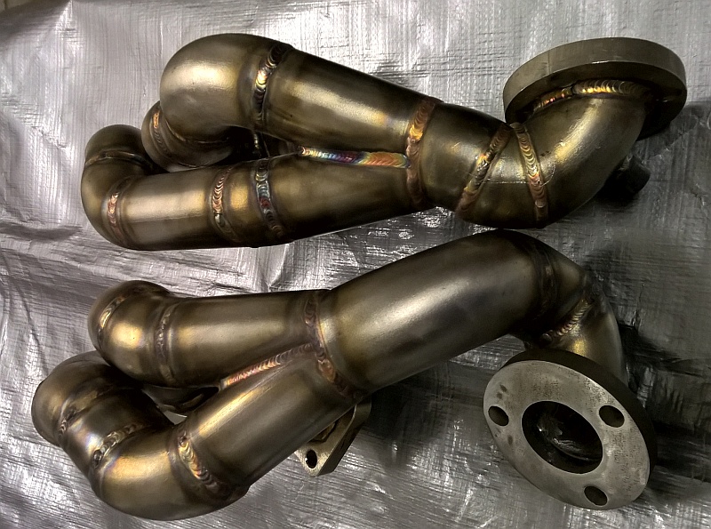

UK manifolds

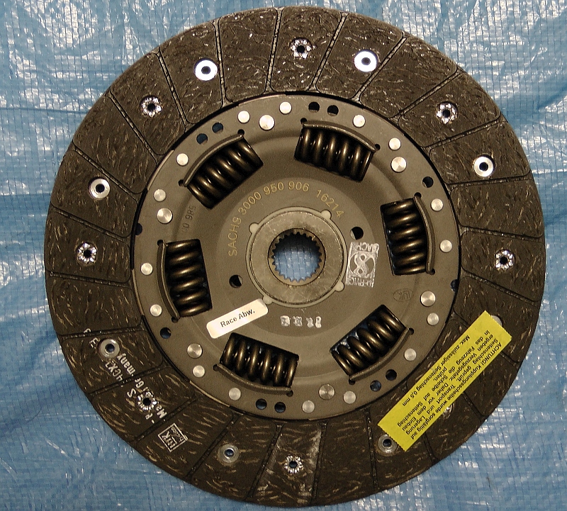

+15 clutch

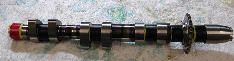

The cams are a yet to be confirmed option at this stage as the added lash adjustment is a PIA.

Slight delay in progress while I fitted electric garage doors, learnt how to do mirror art, fitted a few reversing cameras and found out that the chemical clean of the block wasn't anywhere near as good as it was supposed to be. Basically there are a lot of internal O 'rings inside the engine and none of the sealing surfaces were up to my standard so tiny wire brushes and a dremel tool needed to clean the sealing surfaces before progressing further.
