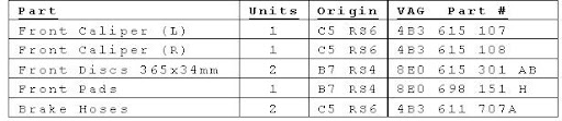

Post by TopBear » Fri Sep 07, 2007 10:55 pm
Apologies for being anal about this, but does this pick list look OK, everything I need?
Also, brake pad sensors... do they connect up without any modification to the B7 pads?
