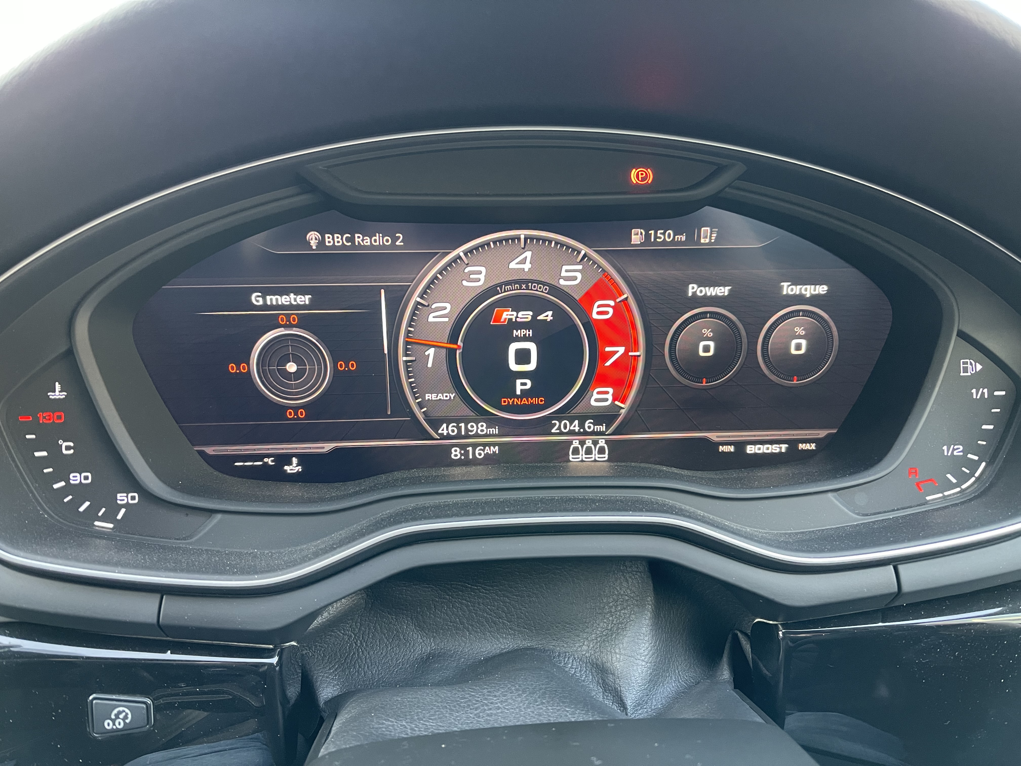

I have a 2018 RS4 B9 and my water temp is fixed on the outer section of the LHS of the main screen of the cluster shown by white LED's above your odometer reset button behind the LHS horizontal bar of your steering wheel. The opposite side to your fuel gauge.
Now as to where the oil temp is depends on which screen view you are using.
I have attached an image of my normal dynamic driving screens which focuses around the tacho and speed displays.
You have 4 layout displays in the LHS of the screen which you can move through by pressing the left and right arrows on the LHS bar of your steering wheel.
You can then press the view button on the LHS bar of your steering wheel to swap to the comfort screens, this swaps the information around and pushes the tacho and speed displays to the background
The oil temp is at the bottom LHS of my screen.
The oil temp also appears in my head up display (HUD), the display options of which you can scroll through using the HUD control button, top right on your lighting control panel. This is behind your RHS horizontal bar of your steering wheel. Push the button briefly to scroll through I have 3 options, off, speed and satnav directions lastly speed gear and oil temp.

Audi dropped the physical water temp gauge from B9.5. They kept the digital oil temp just like in the pic Jools uploaded (in the left bottom corner of the screen)
but you only see it when the car is in RS1/RS2 or dynamic mode with the hockey stick tacho on (by changing the default screen setup to 'RS performance' the hockey stick one
in the MMI I think it will stay on the screen all the time). The water temp gauge... I couldn't find any except the RS monitor in the MMI which only tells the temp range by
changing the colour of the radiator. If there's any way I can get the water temp to show on the VC I'd love to know (other than plugging in crappy devices in the OBD2 port).
I remember the HUD on B9 had water temp gauge, but I don't know if B9.5 kept it as mine doesn't have a HUD. Maybe someone who has can chime in.
