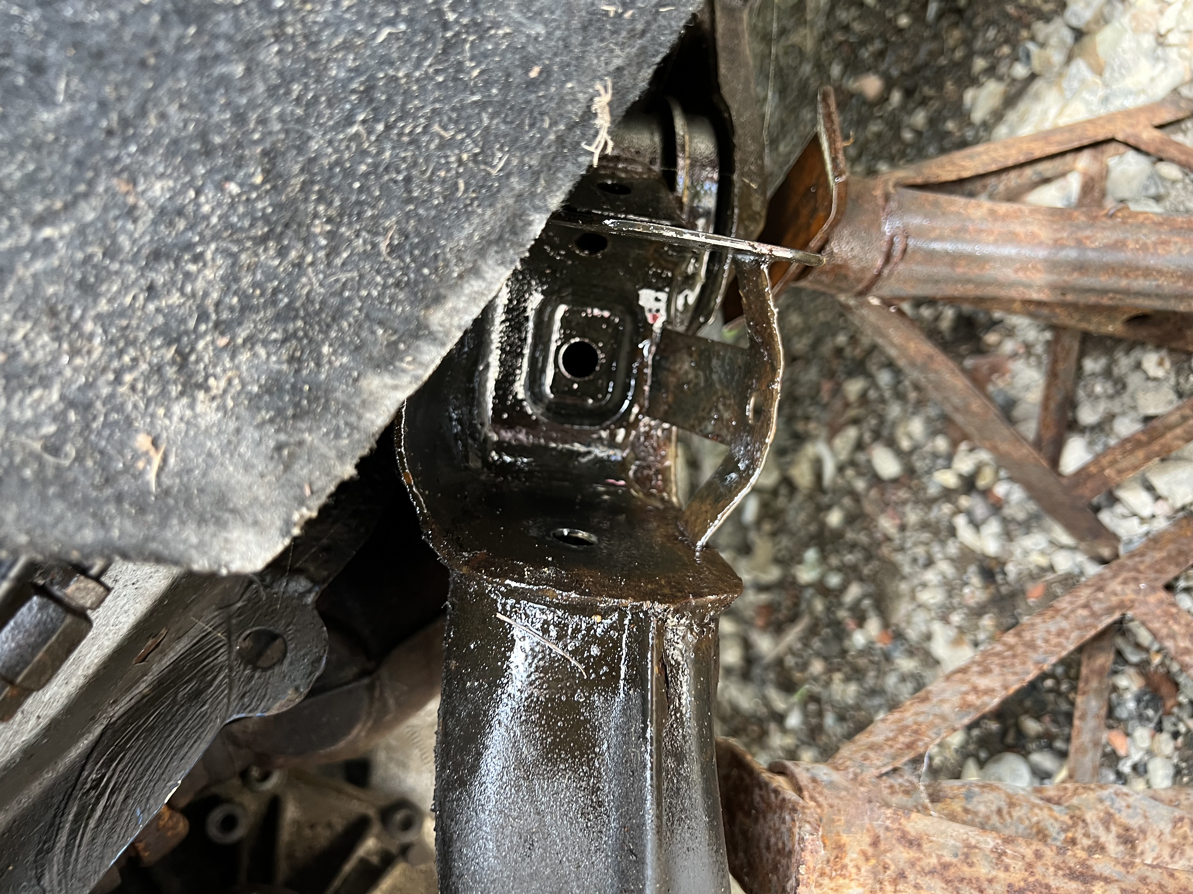

Heres my problem, i think the new PN is correct, but its come off with a spacer and cant get that off (yet) !

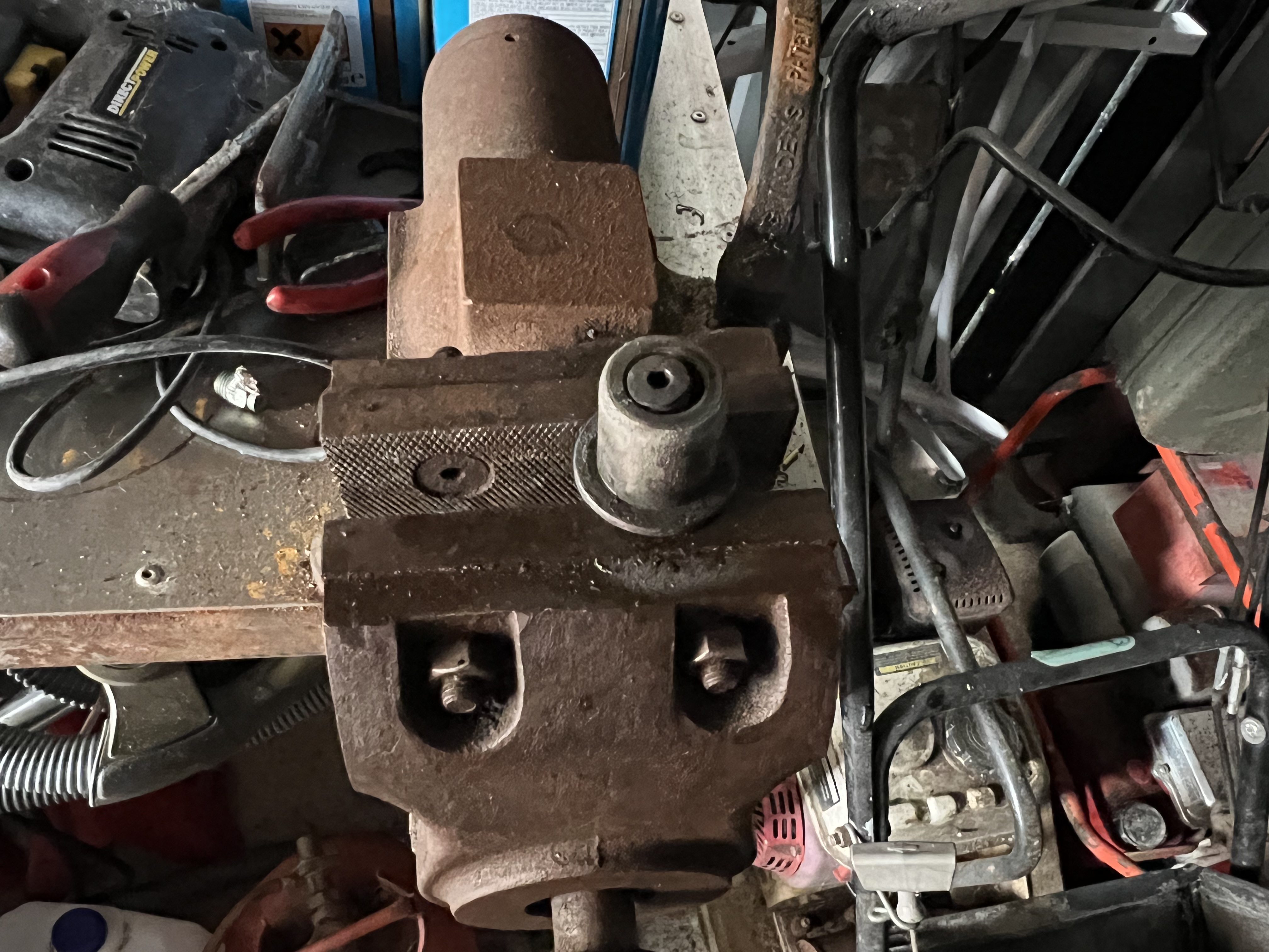

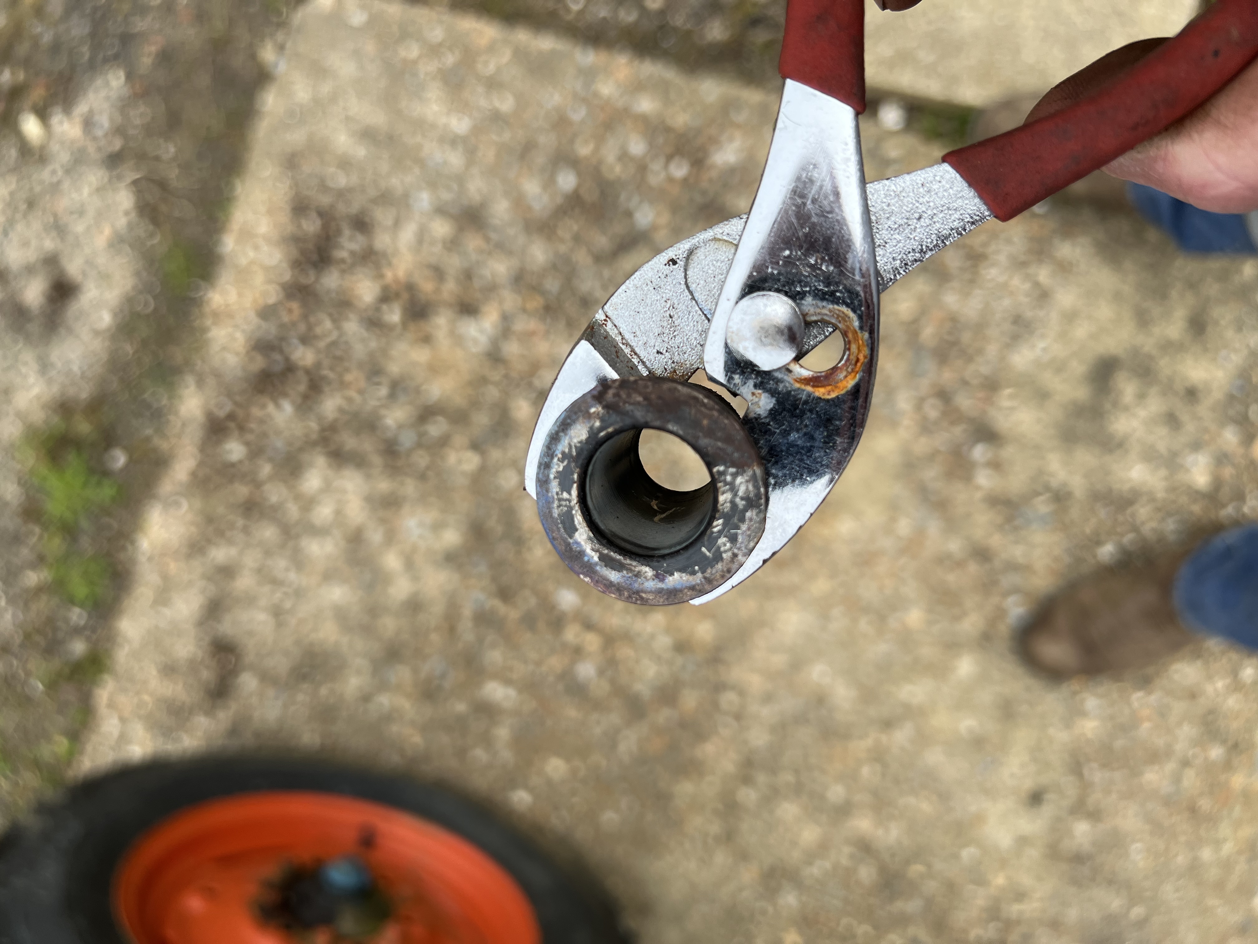

My pullers wouldnt touch it, so had to cut the ball joint, heat it up and hammer it out in the vice.
Wasnt expecting all this, just hope its the right arm after all.......

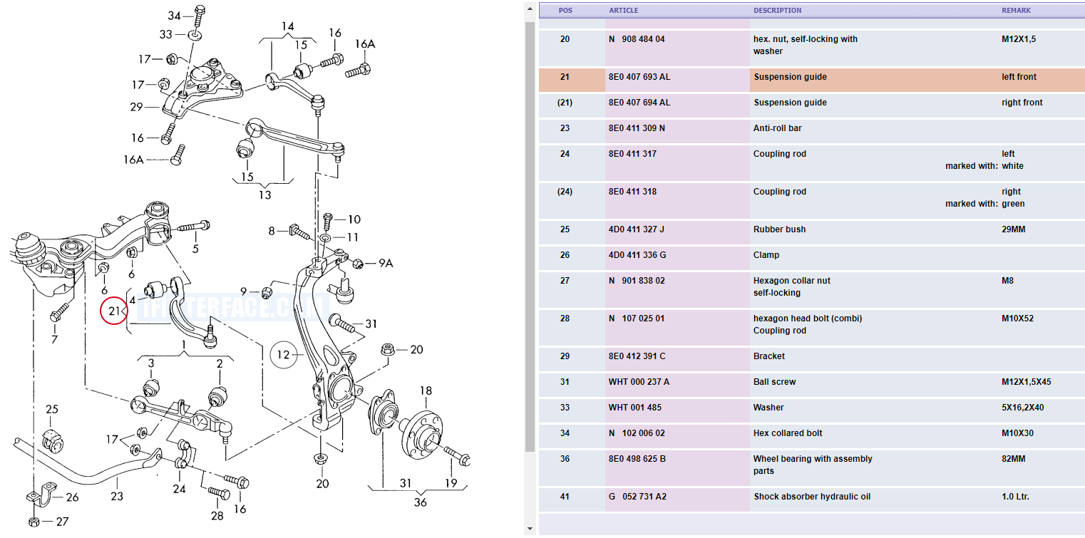

Well that Part # for the Lower Arms is correct : 8E0 407 693 AL
aka.
LEMFÖRDER Control/Trailing Arm, wheel suspension 29855 01
Although, the Previous Revisions are:
8e0407693n
8E0407693AC
8E0407693AJ
8E0407693AK
8E0407693AM
8E0407693T
So, not sure where your old arms : 8E0 407 695 E fit into that.?
anyway.. curious , was that spacer / sleeve part of the Steering knuckle that came off with the old arm?

Thanks, it is odd.
I beleive the spacer is part of item 12 in your image above. But it can come out. Went back in fine. All back together and looking fine.
