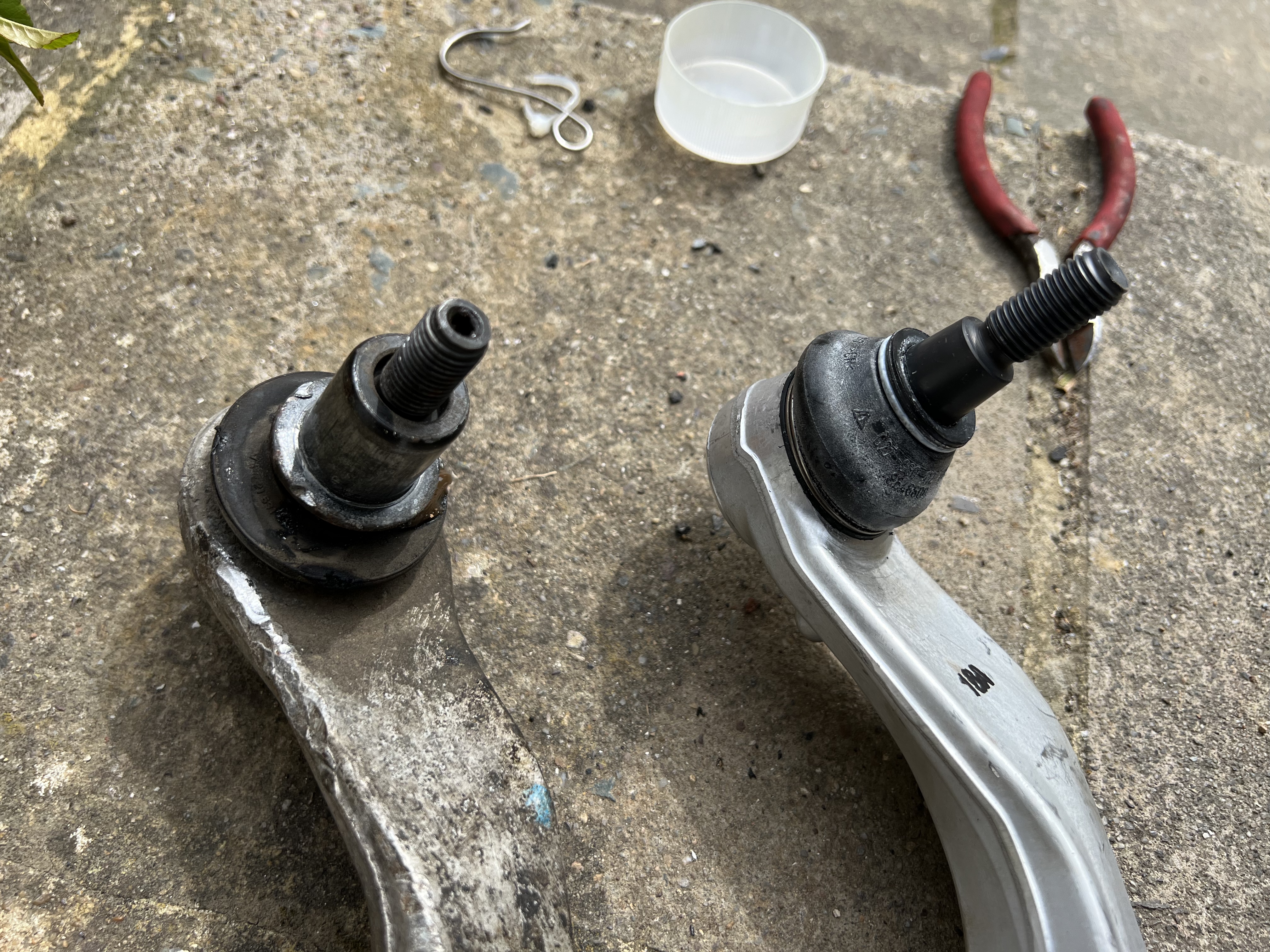

Heres my problem, i think the new PN is correct, but its come off with a spacer and cant get that off (yet) !

My pullers wouldnt touch it, so had to cut the ball joint, heat it up and hammer it out in the vice.
Wasnt expecting all this, just hope its the right arm after all.......

anyway.. curious , was that spacer / sleeve part of the Steering knuckle that came off with the old arm?

I beleive the spacer is part of item 12 in your image above. But it can come out. Went back in fine. All back together and looking fine.
