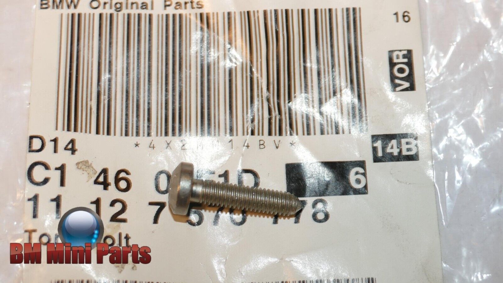

look like this,

Post by Nobbsy » Tue Dec 19, 2023 5:00 pm

I'd be worried that they'd corrode too quickly. Think I'd go for the zinc plated versions.
I thought they were smaller than M6, but you can soon check by measuring.

I believe they are M6 x 23mm. If you are replacing with your own ones, you'll need socket head, not hex head - if I were replacing mine now (I actually DID replace all mine with OEM a few years back) I'd also consider stainless, and you'll need 26 of them. But why not just go with this - if I were replacing mine again, I'd probably just use these :
