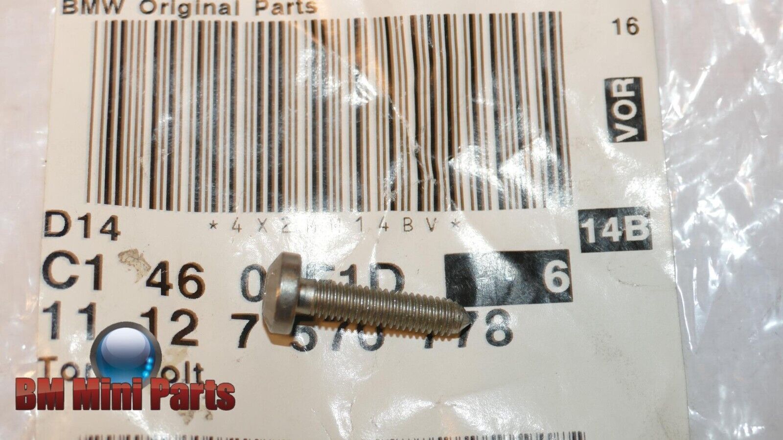

Afternoon all, decided to change oil and filter in transmission today. Got a kit genuine ZF kit from auto doc with new magnets, o rings and gasket, had seen some from other suppliers with sump bolts. I can see why now! 3 were already round before i started, managed to get them out with a little heat and butchery. Good news was fluid all clear and no rubbish on magnets, bad news i have to source new bolts. They appear to be t27 torx and 27mm long and there's 26 of them. Had a look online and there are some crazy prices , anyone know if there is an alternative? Worst case, i have a spare gearbox that i could borrow some bolts off but would be good to replace them.

They do look like m6 bolts, was checking as they have a taper on the end and don't want to bugger the casing. Some places are £3-£4 a bolt, god only knows what audi would want!

look like this,

I'd be worried that they'd corrode too quickly. Think I'd go for the zinc plated versions.
I thought they were smaller than M6, but you can soon check by measuring.

I believe they are M6 x 23mm. If you are replacing with your own ones, you'll need socket head, not hex head - if I were replacing mine now (I actually DID replace all mine with OEM a few years back) I'd also consider stainless, and you'll need 26 of them. But why not just go with this - if I were replacing mine again, I'd probably just use these :
