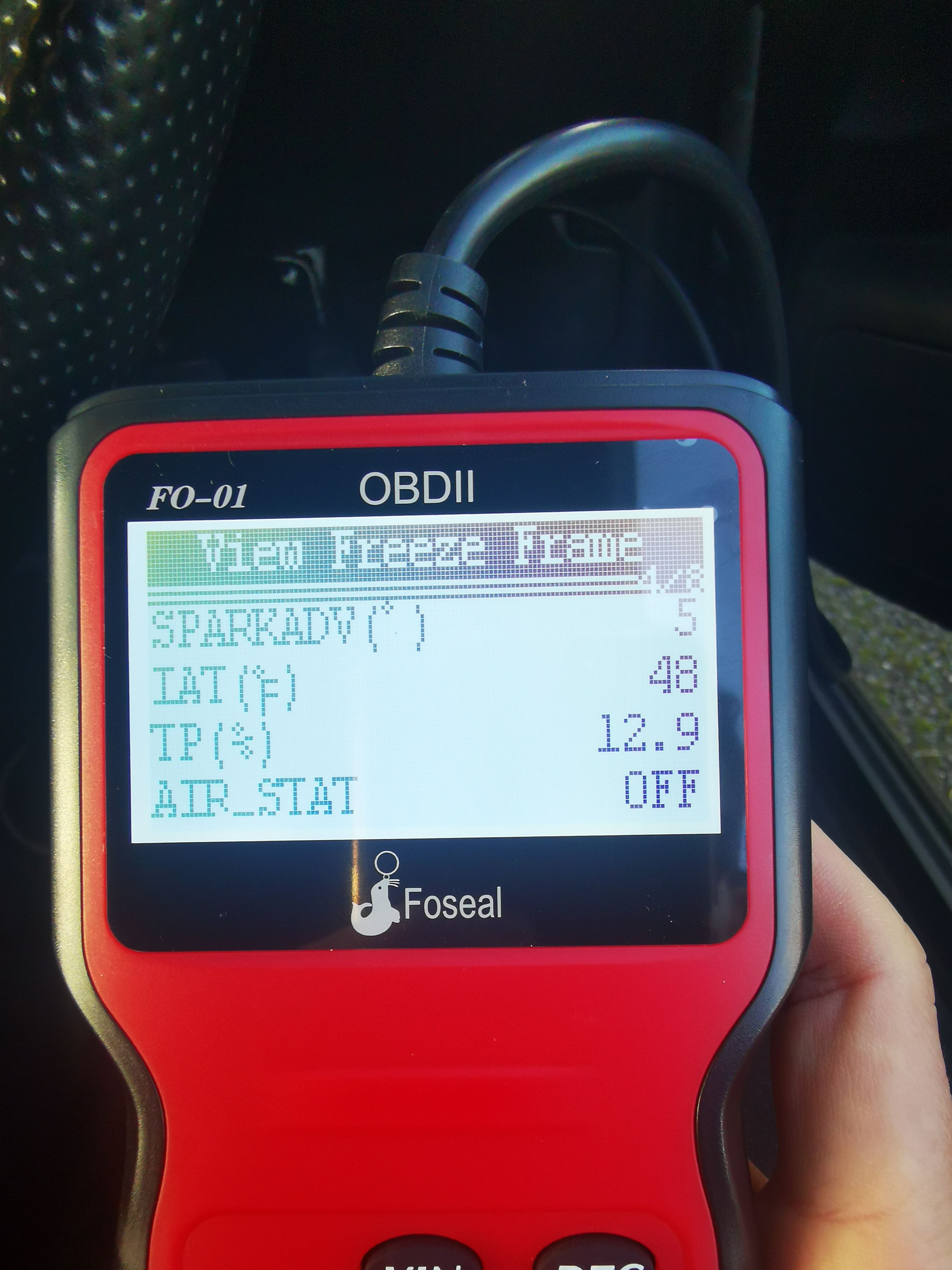

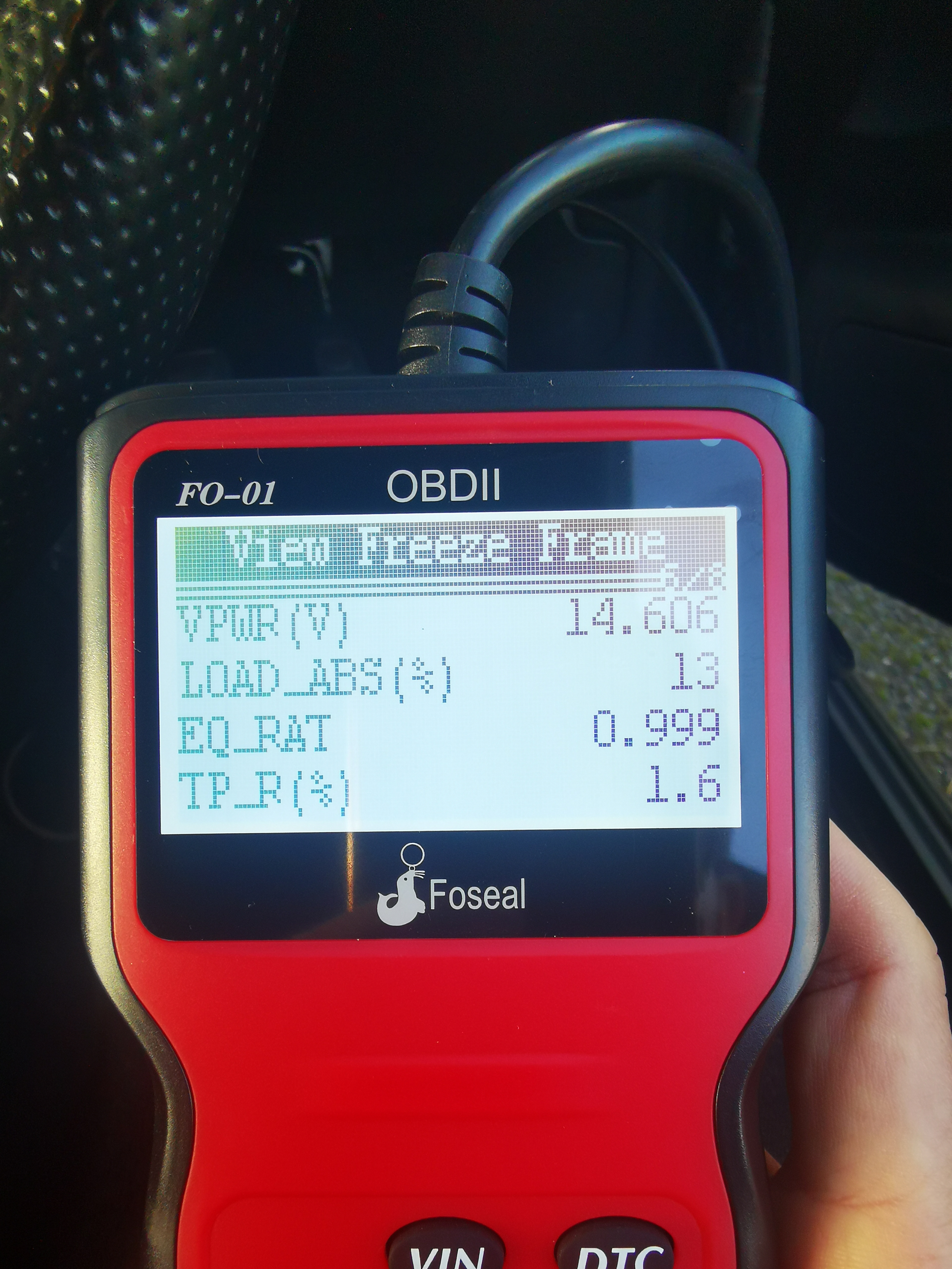

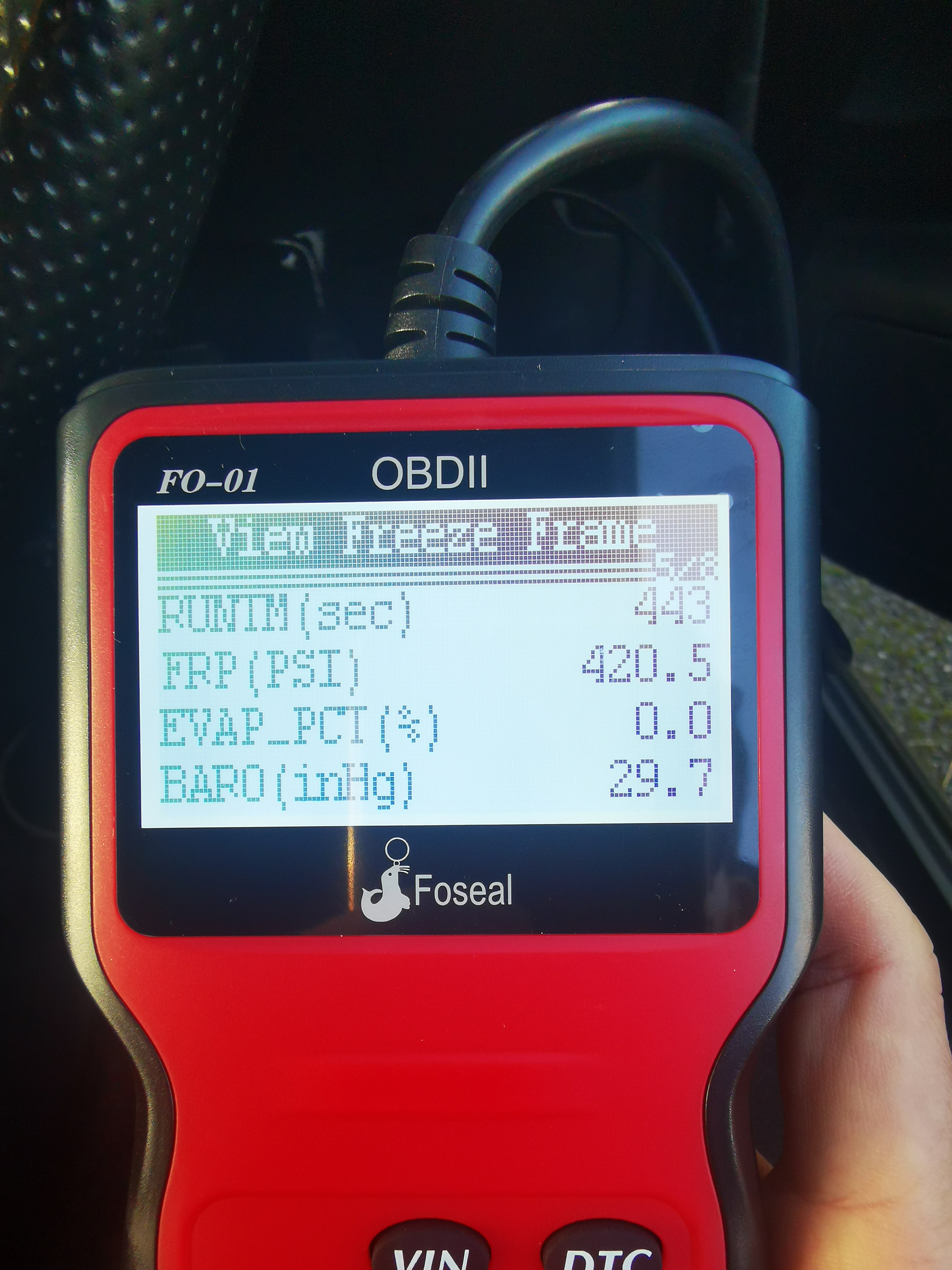

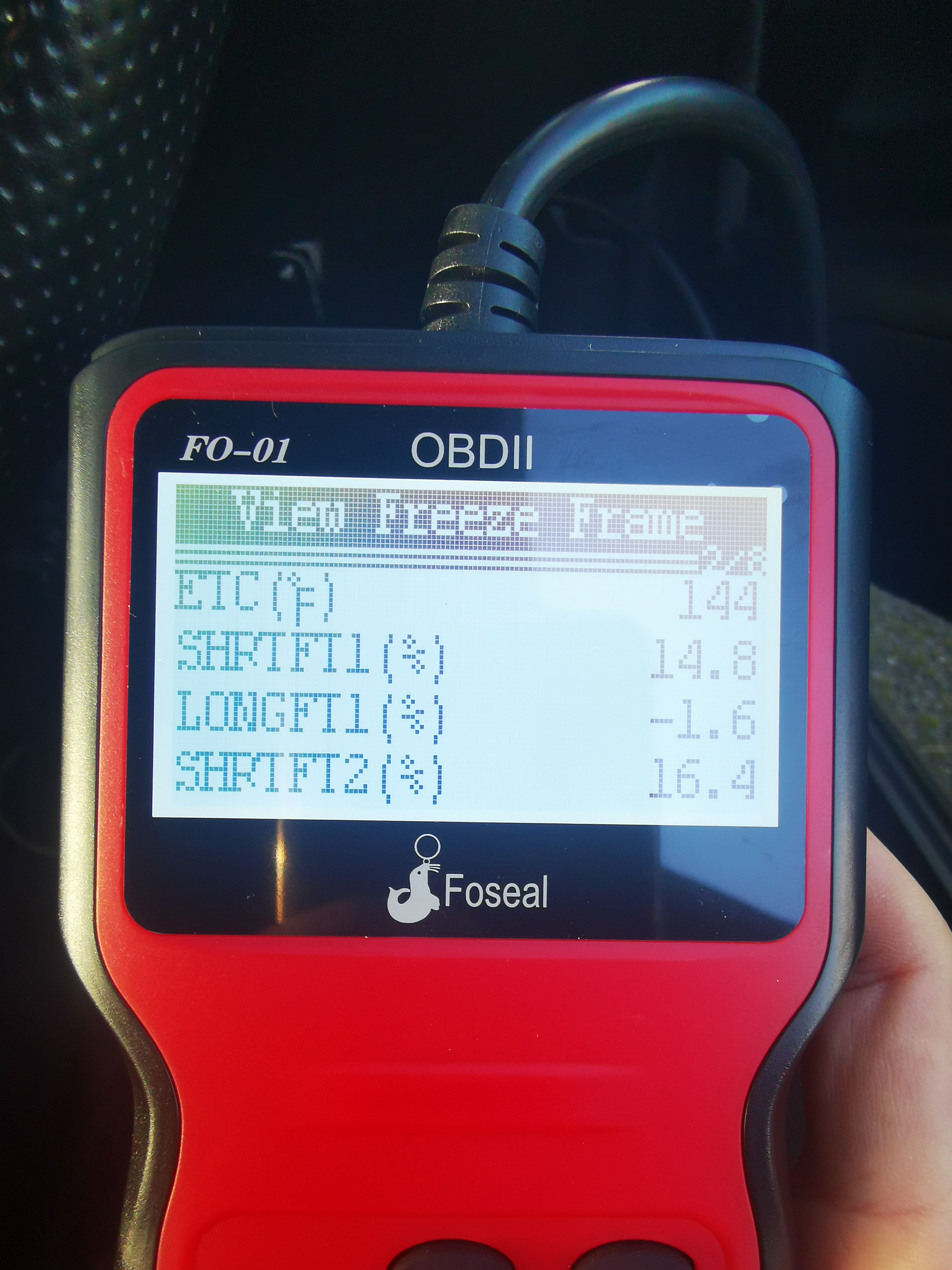

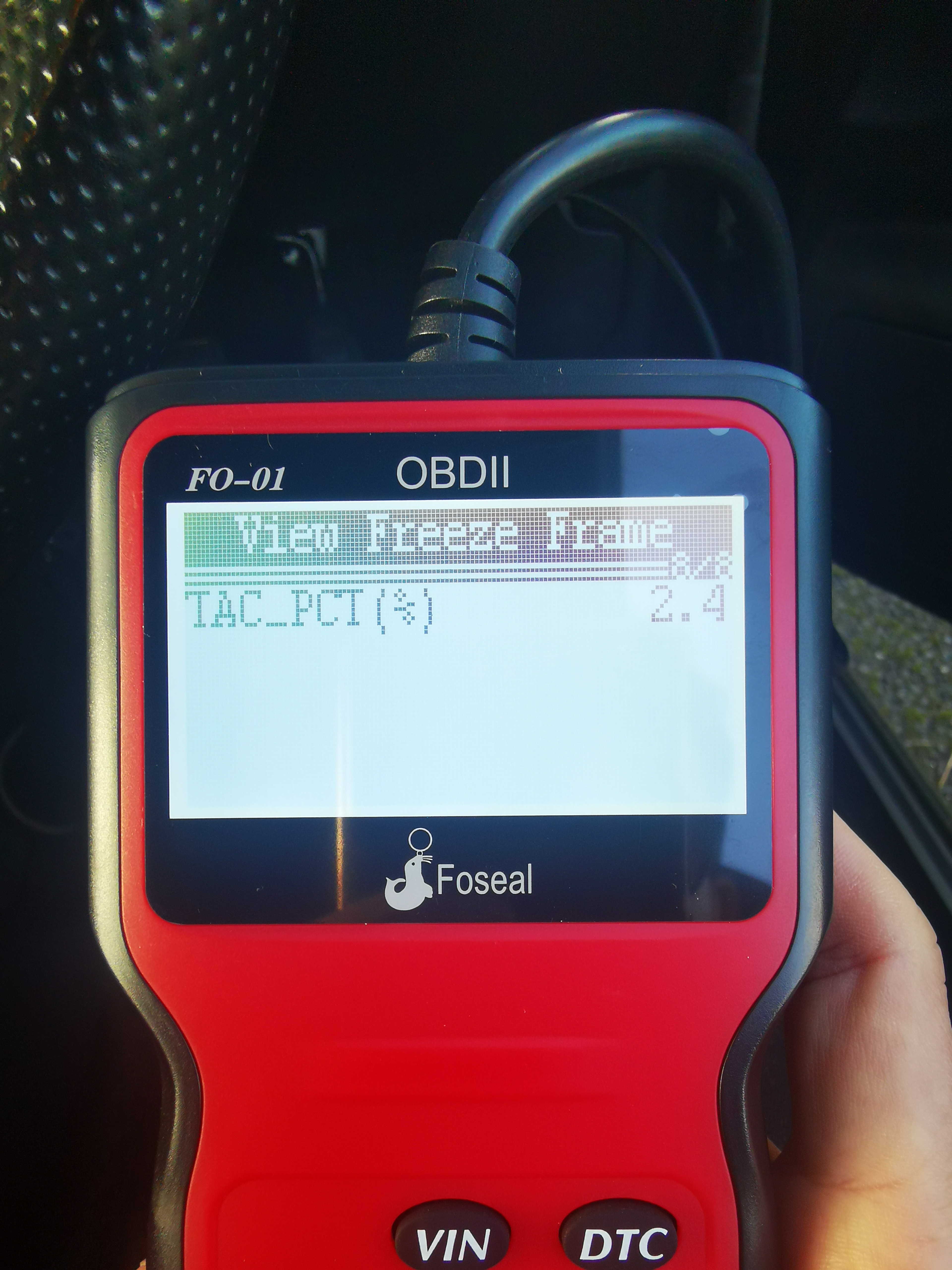

Any technical people make sense of the data in the photos?
I must've missed this one off the hilarious-things-to-go-wrong-with-the-car list.
