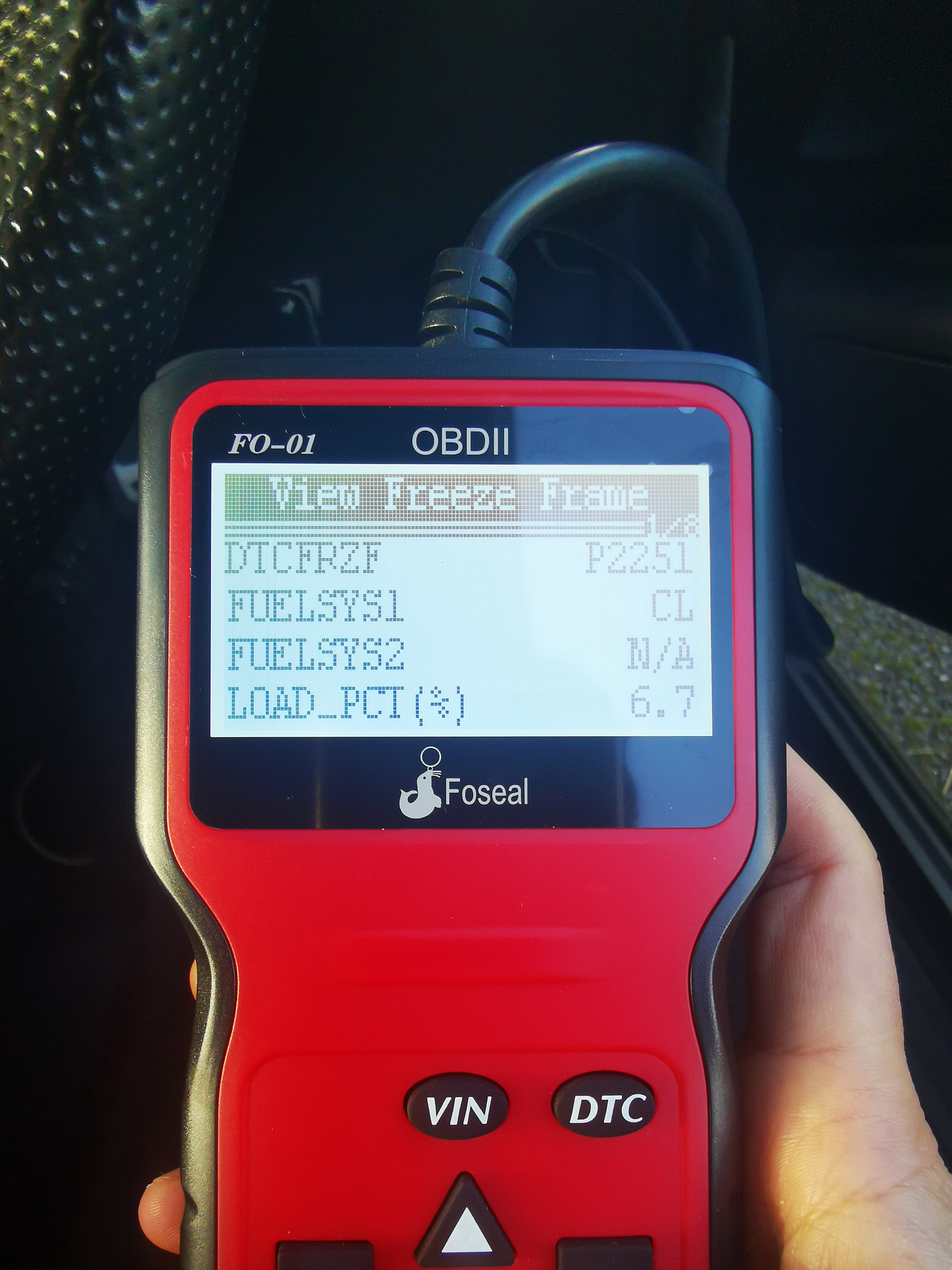

I have an intermittent issue with an O2 sensor (bank 1 sensor 1). Had the EML flash up a couple of times with the error codes P2251 and P0130. Car seems to be running OK. Idles fine, no misfires or flat spots.

Any technical people make sense of the data in the photos?
I must've missed this one off the hilarious-things-to-go-wrong-with-the-car list.
