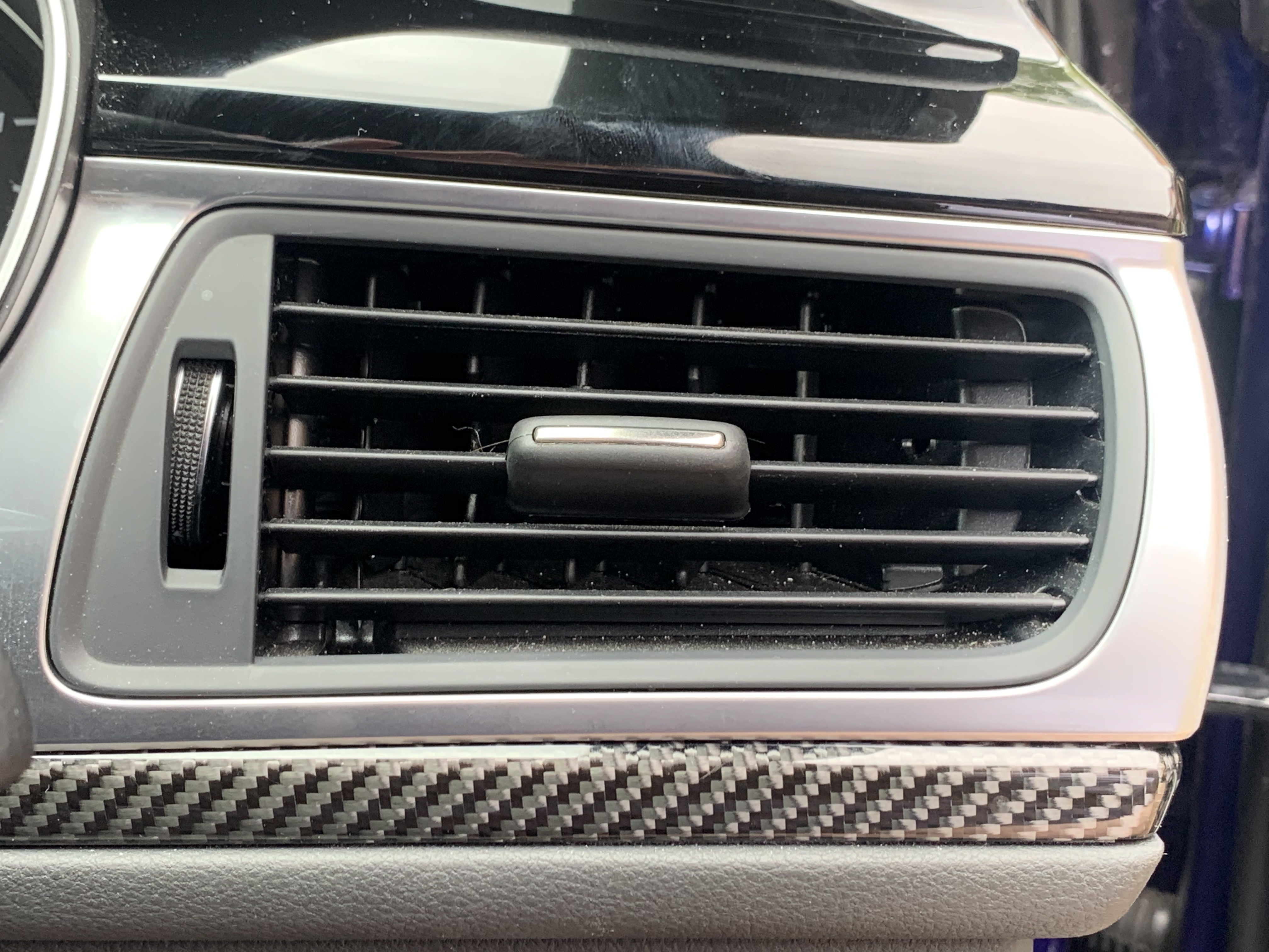

The control wheel on my drivers size air vent has come loose inside the housing - so I need to remove it and reseat the wheel.
I’ve tried the instructions here (http://davidhkblog1.blogspot.com/2018/0 ... t.html?m=1) and bought a hook thing, but even pulling pretty hard I cannot get the vent out.
Has anyone managed to remove their air vents?

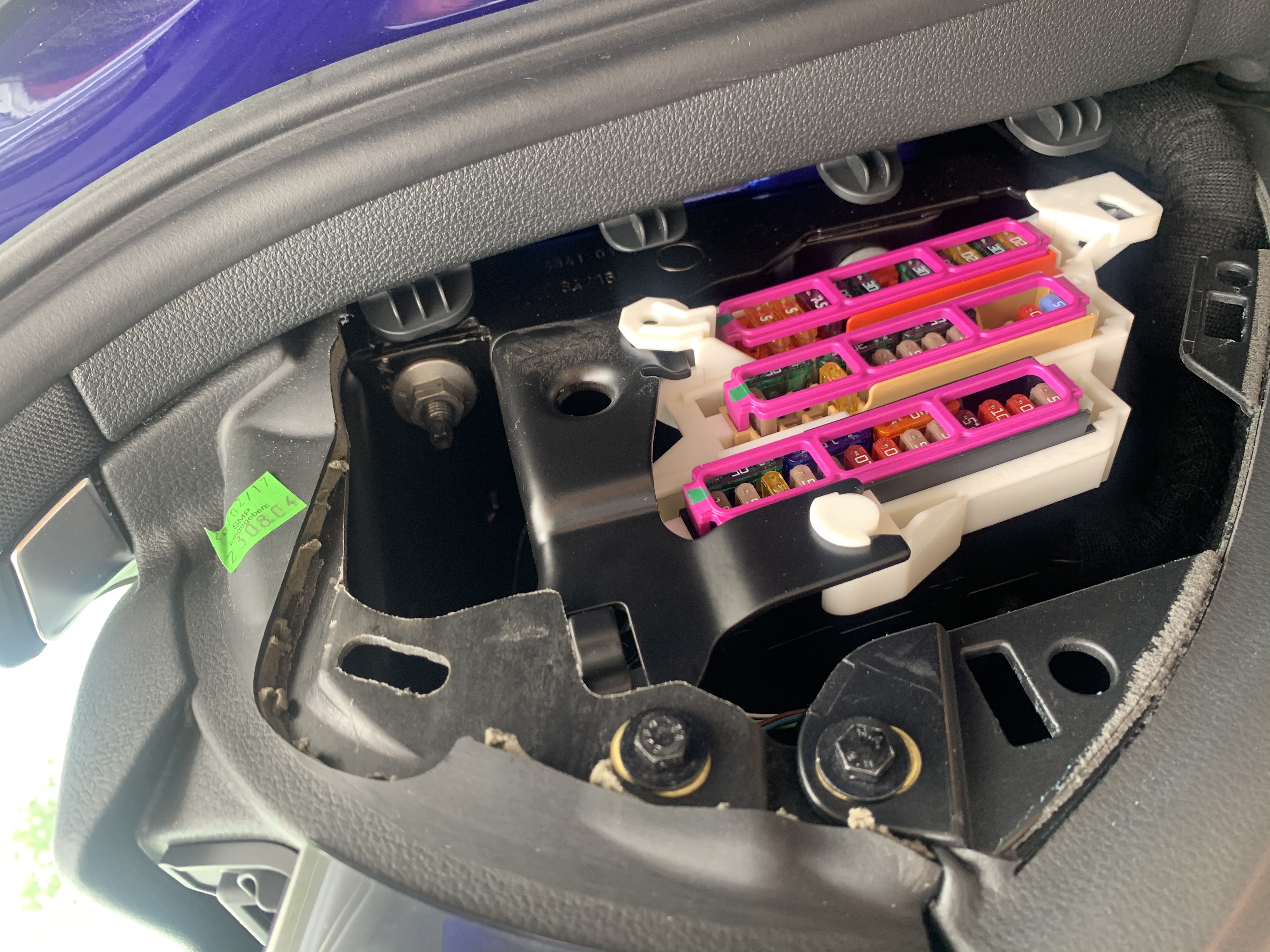

You need to remove the side fuse box trim panel and the 8mm bolt and also the gloss black trim above the vent and iirc there is another bolt there. then you can use the hook to pull it out but watch for the sensor cable as its short

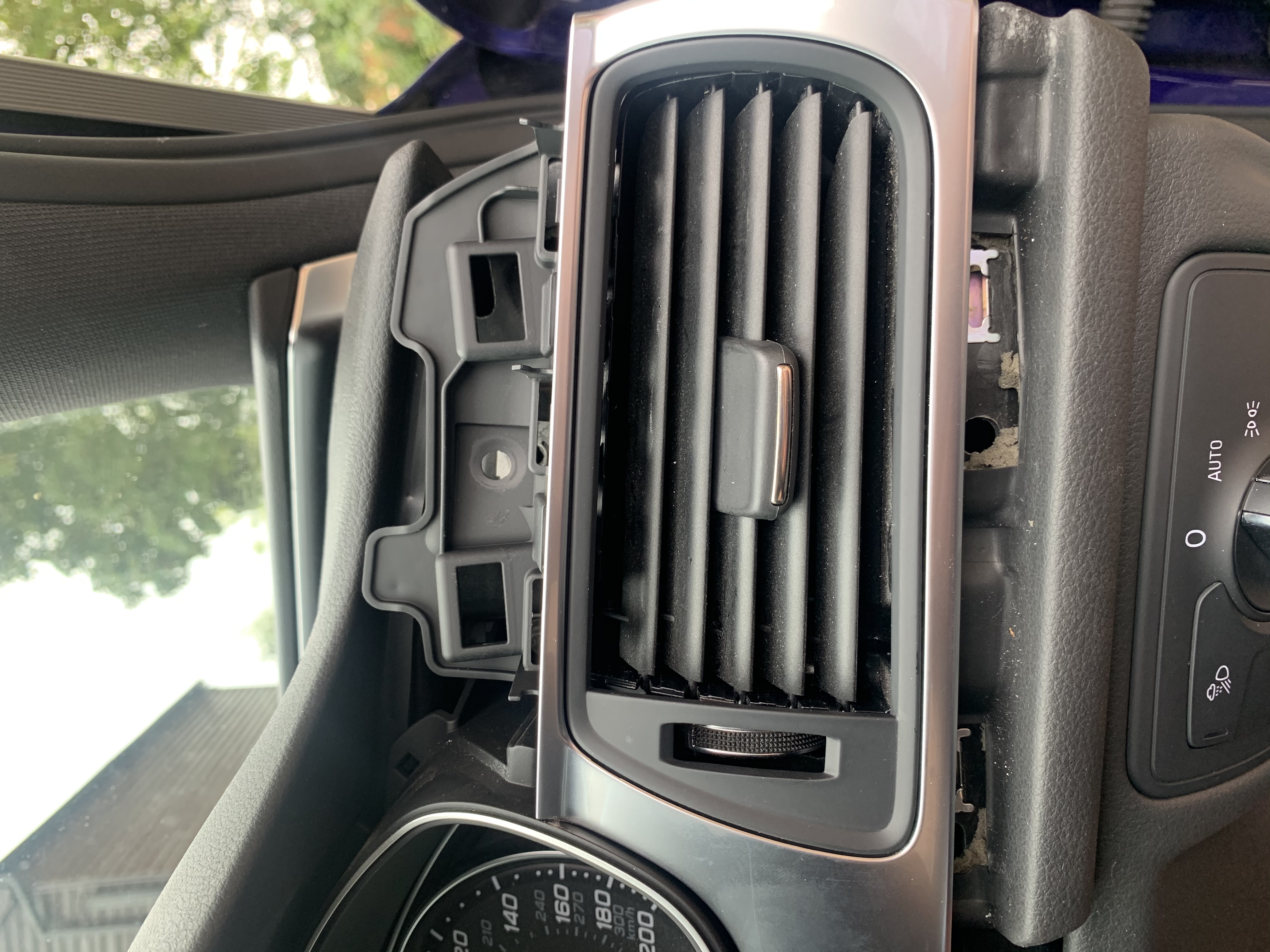

Thank you. I’ve managed to get the top and bottom trims off, taken the bolts out behind them, and removed the fuse cover trim.
Can’t see any other bolts to remove that look to be part of it - but the air vent, is loose, but still doesnt want to come free. Can you point me towards what comes off next?

I feel I’m in danger of taking the whole dash apart but don’t need to - and struggling to see what is still holding the vent in place.
Should the black plastic vent come free in its entirety? Or should the silver surrounding trim come away too?

In your pic of the side panel removed have you removed the top 8mm bolt?
Dont remove the silver trim on its own. Its meant to come off together with the centre vent.
Its got some big metal spring clips which you can see if yo look into the gap from the side.
It should just need a good tug to release it free
RS6 Performance Ascari blue, Carbon Ceramics, Akrapovic, H&R Anti Roll bars
