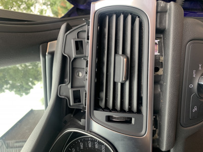

Thank you. I’ve managed to get the top and bottom trims off, taken the bolts out behind them, and removed the fuse cover trim.
Can’t see any other bolts to remove that look to be part of it - but the air vent, is loose, but still doesnt want to come free. Can you point me towards what comes off next?

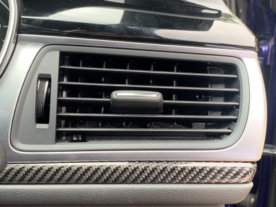

I feel I’m in danger of taking the whole dash apart but don’t need to - and struggling to see what is still holding the vent in place.
Should the black plastic vent come free in its entirety? Or should the silver surrounding trim come away too?

In your pic of the side panel removed have you removed the top 8mm bolt?
Dont remove the silver trim on its own. Its meant to come off together with the centre vent.
Its got some big metal spring clips which you can see if yo look into the gap from the side.
It should just need a good tug to release it free
RS6 Performance Ascari blue, Carbon Ceramics, Akrapovic, H&R Anti Roll bars

Oh and also the silver trim that is above the steering cowl and is connected to bottom section of the vent needs to be separated from each other. Use a plastic pry tool to pry them apart
