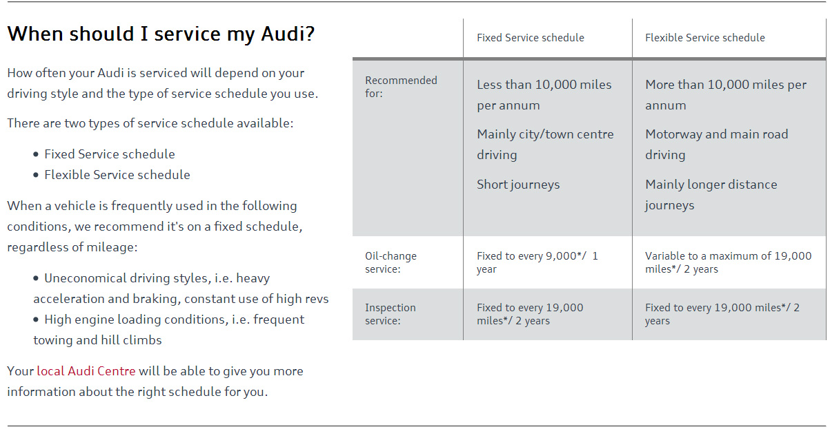

So, onto the cars service requirements.
Audi Engine Service Schedules: Cars can be run on either type.
  • Fixed Service Schedule – Every 12months or 9000 miles, whichever comes first. This schedule alternates between #1 Oil Service and #2 Inspection Service with Oil Change.
  • Flexible Service Schedule – Every 2 years or 19,000 miles, whichever comes first. This schedule operates only one type of service called an Inspection Service with Oil Change (flexible), which is basically an Inspection Service with Oil Change, but uses an Audi approved long life oil.
These schedules can be changed or swapped at each service interval by Audi if asked to, or changed via VCDS if the Independent/User has such system available. The schedule should be selected based only the cars expected type of usage.
As set out in this document below (click to enlarge).
Choosing Service Schedules.

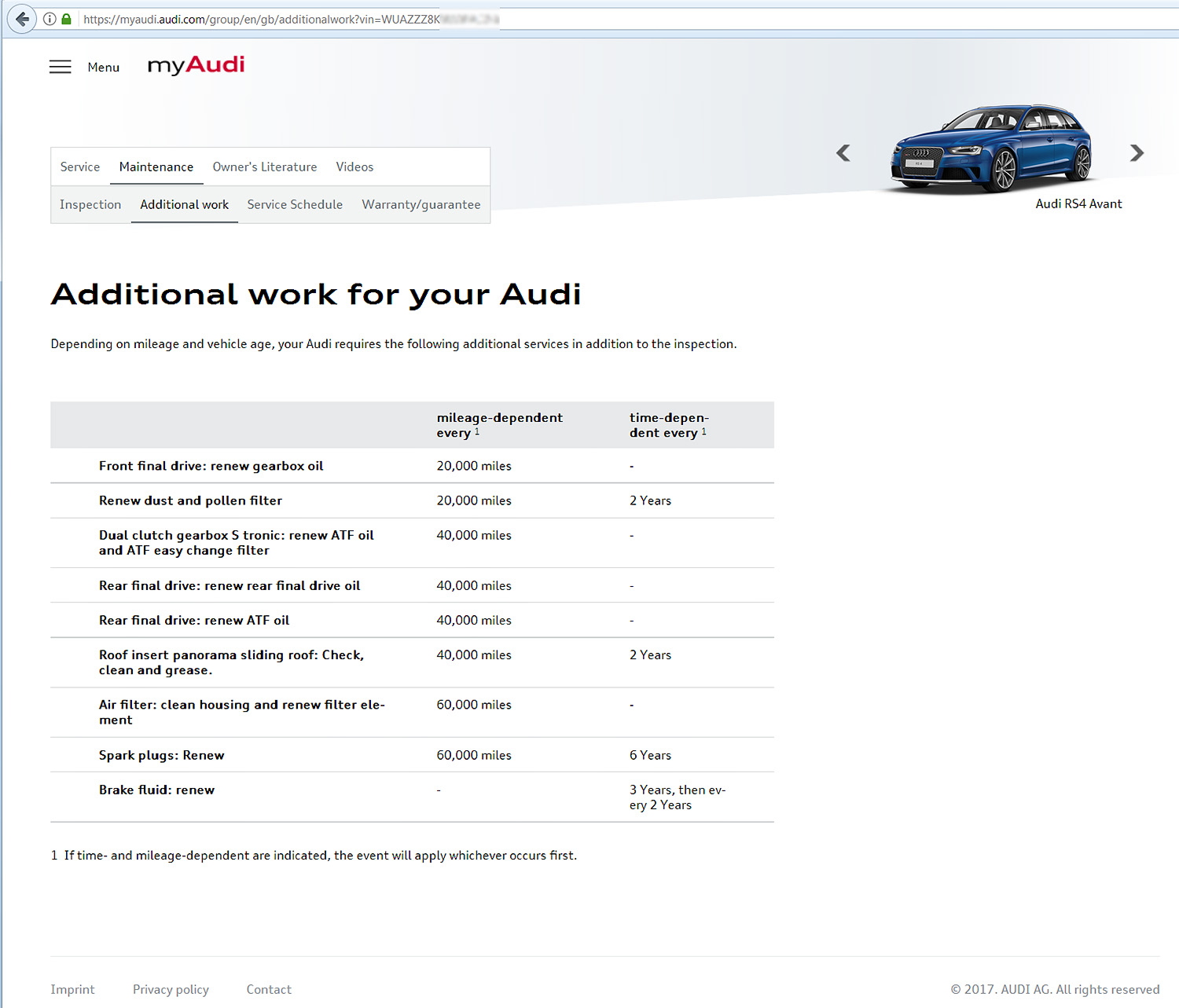

Audi Additional Service Requirements:
  • Front Final Drive: renew gearbox oil – Every 20,000 miles.
  • Cabin interior Dust & Pollen filter – Every 20,000 miles or 2 years. Whichever comes first.
  • Panoramic Roof : check mechanism, clean & grease slides – Every 2 years or 40,000 miles. Whichever comes first.
  • Brake Fluid – First change at 3 years old, there after renew every 2 years.
  • Dual Clutch Gearbox S-Tronic: Replace ATF filter and ATF fluid – Every 40,000 miles.
  • Rear Final Drive : Replace final drive oil – Every 40,000 miles.
  • Rear Final Drive : Replace ATF fluid – Every 40,000 miles.
  • Engine Air Filter : Replace both filters – Every 60,000 miles.
  • Engine Spark Plugs : Replace all 8 – Every 60,000 miles or 6 years. Whichever comes first.
  • Front Brake Discs – Replace at the minimum 32.4mm thickness.
  • Rear Brake Discs – Replace at the minimum 20mm thickness.
  • Front Brake Pads – replace at 10mm (includes backing and damper plate).
  • Rear Brake Pads – replace at 7mm (includes backing and damper plate).
Audi document can be seen online in the owners area, use this link if registered and select the Additional Work tab - https://myaudi.audi.com/group/en/gb/serviceplan
Or you can view the screen print I have taken below, click it to enlarge:

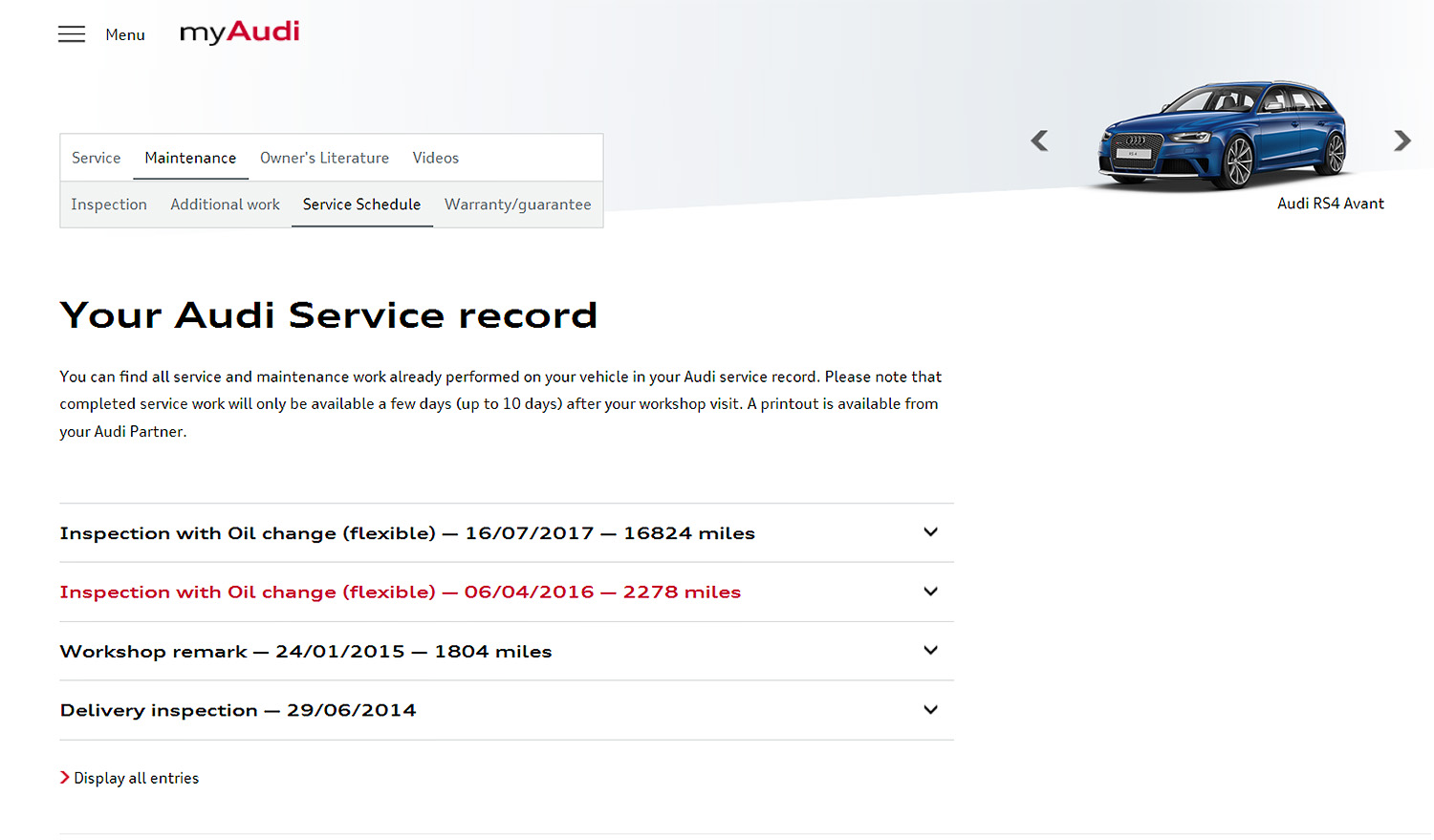

Very useful, what's interesting is the digital service history is useless for potential buyers, if you go online to view, or get a print out it does not detail work done, just dates a mileage.

noddy wrote:
Sun Oct 22, 2017 9:00 pm
Thanks. I've not been in that position but is this, the sort of thing you're provided with?
click to enlarge
click to enlarge
I've just PXed my B7 RS4 for an 8J TTRS and with it I got something very similar to what you've posted. The service log has three services (all variable with about 14,000 miles in between them) but when I went through all of the paperwork I found an Audi service report from earlier this year that details two further services. I find it odd that they wouldn't transfer this information to the service log.
click to enlarge
Same with my purchase, digital history looked light. Contacted dealer, requested stamped service book with individual visits and work carried out. It cost me £13, but I now have what I see as a comprehensive breakdown of service history, with 5 stamps rather than the three shown online.

I can't get a digital service schedule for mine. Is it too old (11 plate)? The service book has three stamps. The additional two are listed on a service record sheet that was printed when the car was with Audi having some other work done. Where did they get that information from?
