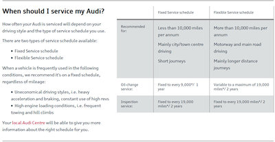

Audi Engine Service Schedules: Cars can be run on either type.
  • Fixed Service Schedule – Every 12months or 9000 miles, whichever comes first. This schedule alternates between #1 Oil Service and #2 Inspection Service with Oil Change.
  • Flexible Service Schedule – Every 2 years or 19,000 miles, whichever comes first. This schedule operates only one type of service called an Inspection Service with Oil Change (flexible), which is basically an Inspection Service with Oil Change, but uses an Audi approved long life oil.
These schedules can be changed or swapped at each service interval by Audi if asked to, or changed via VCDS if the Independent/User has such system available. The schedule should be selected based only the cars expected type of usage.
As set out in this document below (click to enlarge).
