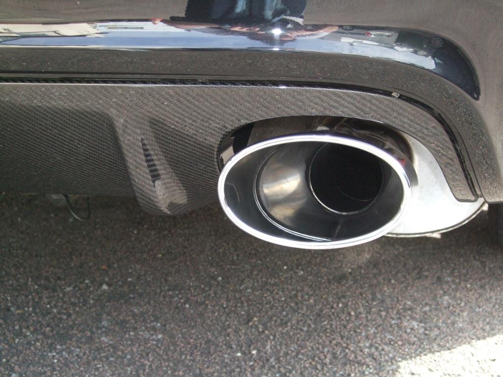

Post by Woly64 » Fri Oct 21, 2016 4:45 pm
I used a whole series of Bilt Hamer wheel cleaner/gunk/petrol all with different grades of wire wool finishing off with a fine grade and some Autosol. Plished everything up with a combination of a shaped dome polisher on my drill together with mt I ended up using a very fine grade wire wool to get everything off the outside and inside. Polished them up using a cone shaped polishing head on my drill and the Dremmel for the awkward places. Came up a treat

Woly, that's quite a finish you have achieved, nice
