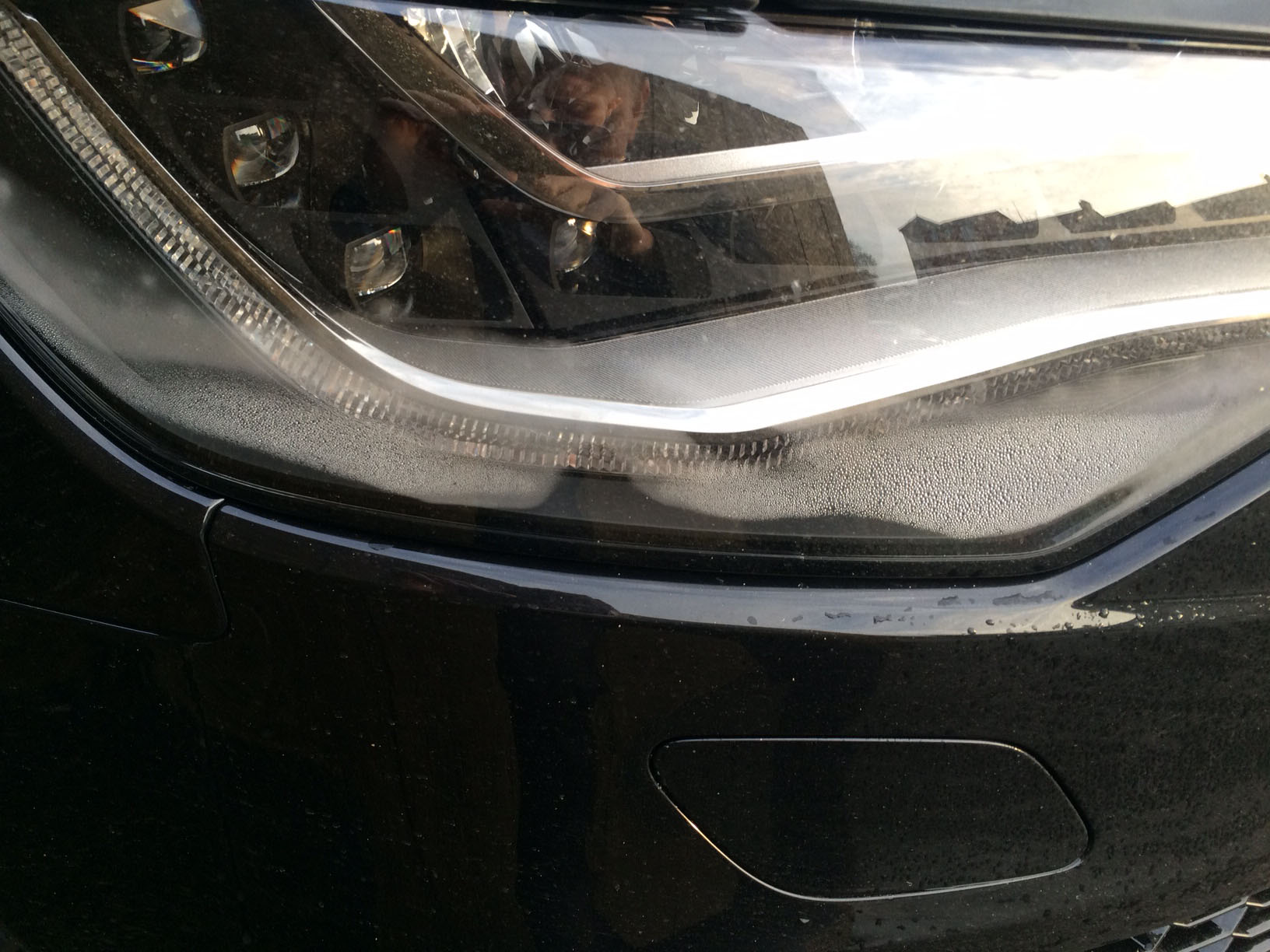

I recently took delivery of a new RS6 and as you'd expect it's terrific. However, there is on thing that took me by surprise - the fact that the LED headlights are very prone to condenstation this time of the year. Has anyone else experienced this issue? Apologies if it has been discussed before. I've had it since day one and has not cleared. Attached is a pic.

I've had this on occasions - notably when the car has been washed using a pressure washer

I have the same problem on mine as you do. I seems to happen after washing but also after driving in damp/wet conditions. The heat of the engine seems be a contributing factor. However, it never happened on my first one but that was during the summer period so that might have something to do with it. I just looked at mine and its not been driven today and no condensation but its raining here. I'm going out in it later so I'll check after that. I'm not overly concerned as its the same on both which indicates there are no cracks in the lights :beerchug:

I have spoken to the Audi dealer today and he says it's "normal". The headlights are vented and so allow moisture in and it's something to do with the difference in temperature between the back of the headlight and the the perspex at the front, which causes condensation. Not a warranty job.

Misting up of the headlights is specifically stated in the owner's manual as being a normal occurrence, so it is almost inconceivable that Audi will swap the units at their cost. The very reason that it is mentioned in the owner's manual is to preempt any possible waranty claim.

I was told the same by my dealer and the condensation goes when the heat from the lamps burns it away. told no problem for electrics, its normal.

The same thing happens on my LED lights- it happens when I have just washed the car. Also saw it 5 or 10 minutes after stopping following a long drive in the rain. My previous A4 and the one before that (B8 & B7) both had Xenons and condensation formed on those lights, as did the 4 or 5 Passats I had before that. It was explained to me a while ago by VW, when I "complained", that this was normal and the lamp housings were essentially self breathing at the rear to help with heat dissipation.
I was concerned that the condensation could lead to mould forming in the lights later in the life of the car. This never happened to any of the light housings while I had the cars. I had my last A4 For 4 years, washed it regularly and the light housings remained pristine inside. So I have not mentioned the condensation on the RS6 LEDs to the dealers as I am pretty satisfied that it is normal. My wife's Q5 does the same, but again the light housings are still pristine.
