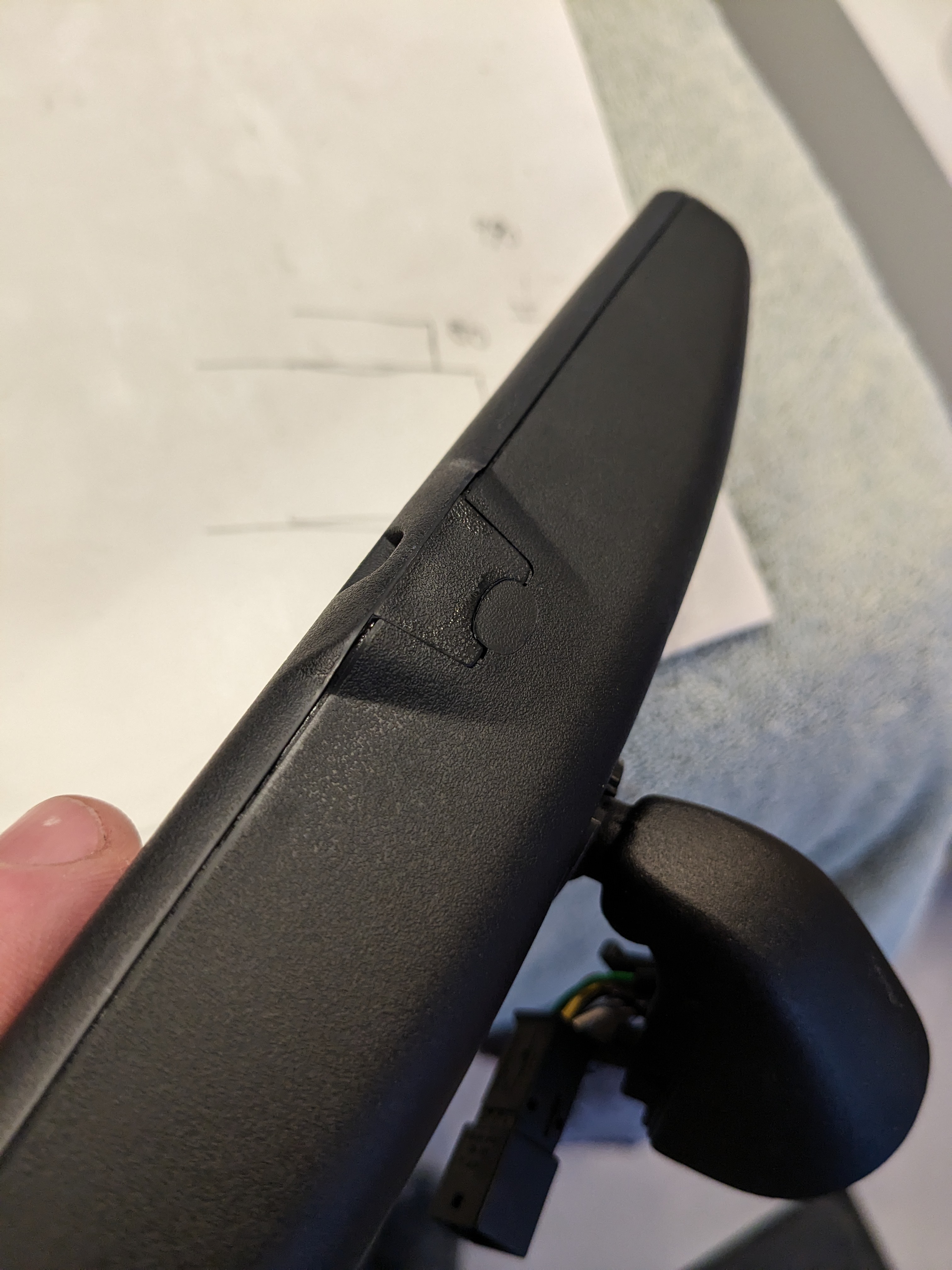

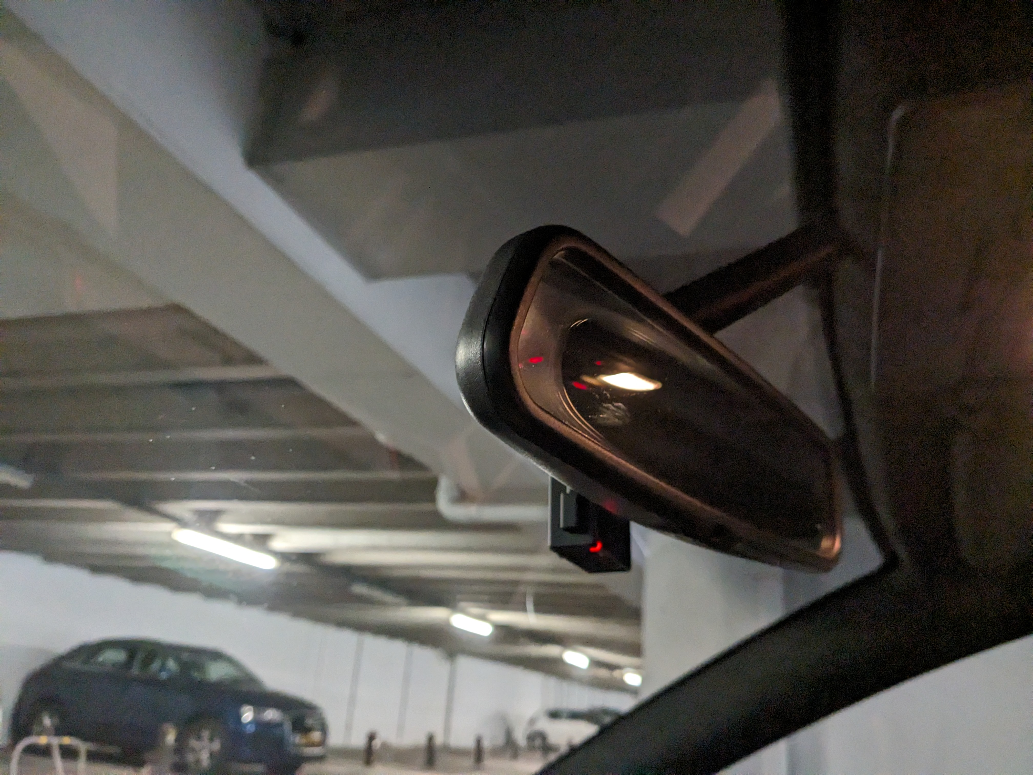

what is that.... my second rear view mirror is leaking again?
this car... at that point i just smiled
this is broken right?
any chance it'll leak while i get the original back to the UK and forwarded on to Mirror John?

https://mirrorjohn.com/How_They_Work.php
John has answered my question:
If you still have the old mirror which has not been repaired/refurbished and notice that the dimming feature no longer works, remove it immediately. In my experience, the order of occurrence is:
1) Dimming feature stops
2) Liquid appears behind glass
3) Liquid Leaks & Ruins interior
The time between these steps might be weeks, months, or years, but I would replace it with the first symptoms.
Seems todays RS6 work is not finished.

i am lucky i took the mirror off... it was getting ready to drop acid onto my clean interior!
