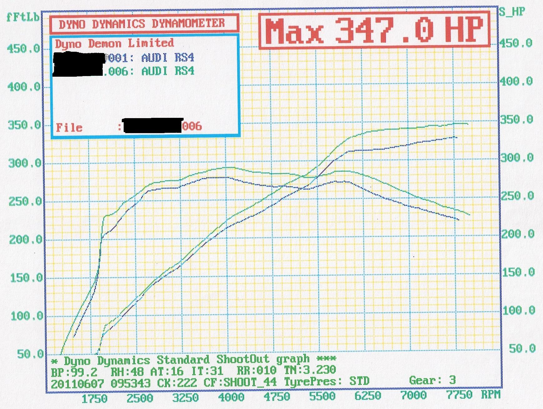

Hi All
So I've had the car back a couple of weeks now and it does feel better, not sure it's any faster but it's a lot more responsive and I'm enjoying it.
The 2nd dyno run after a full service including plugs didn't really show much better results, graph attached with 2 runs overlaid.
I'm wondering if it's worth spending a few hundred and having the engine de-carbon'd? Would I see a noticable improvement or am I just chasing figures...?

Re: Dyno Test - low on power, what next..?
Daz-RS4 wrote:Hi All
Just chasing figures and to be honest, it is not a few hundred, it is several hundred to decoke unless you DIY.
