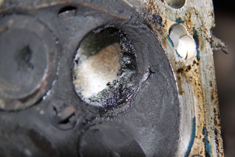

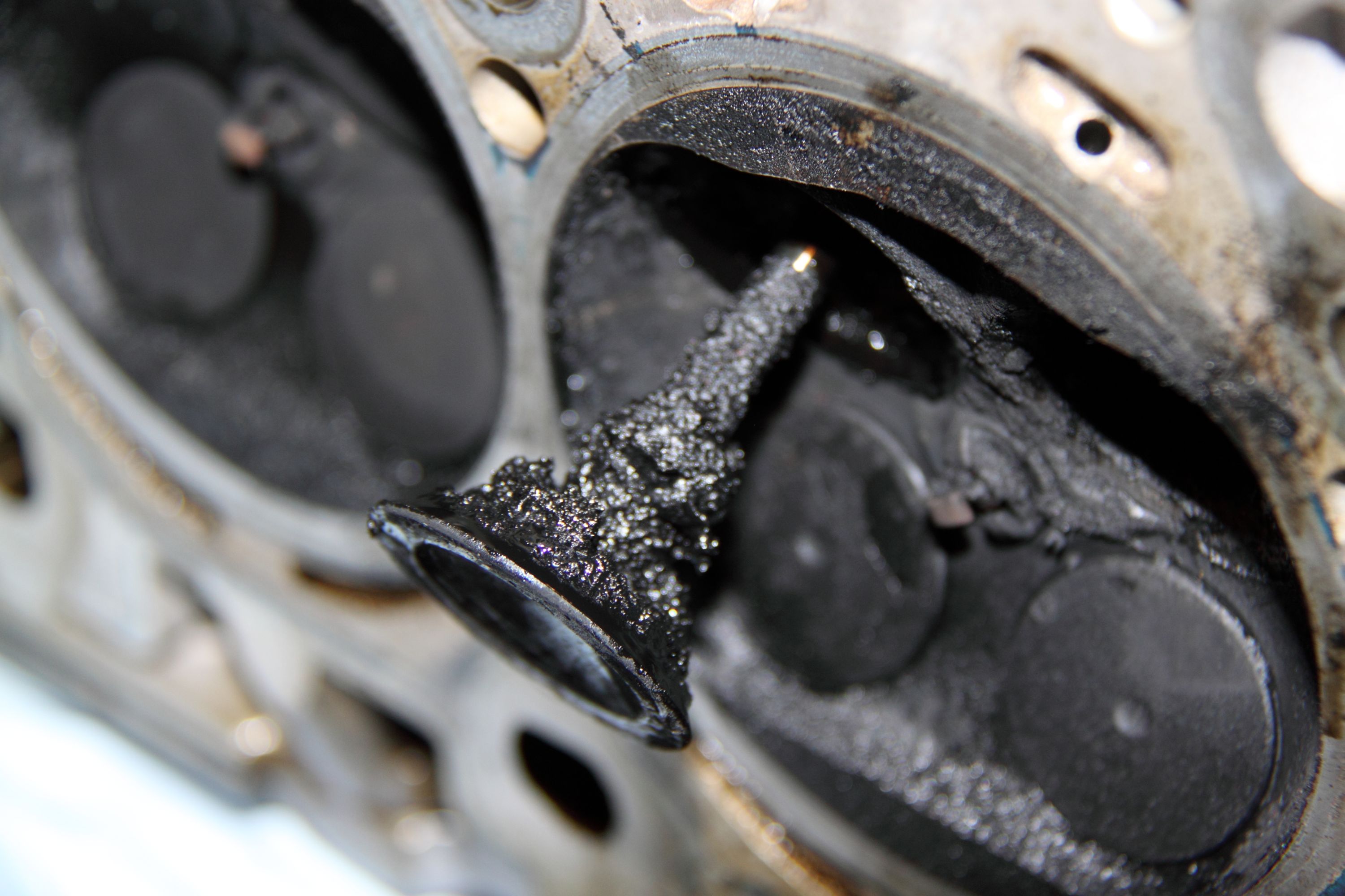

Audi Dealers here in the States have been doing this "induction cleaning" for years, it's good at cleaning minor buildup, but useless for thick buildup seen in our engines. Kind of a waste of money.
The only way to truly clean the deposits is removing the manifold and manually scrubbing everything, or Media Blasting. Which uses a high pressure spray of walnut shells or the such.
Check this recent victim of massive buildup.
http://forums.quattroworld.com/rs4b7/msgs/52391.phtml
I notice Audi paid for this one under warranty

Post by pad125 » Fri Jan 28, 2011 8:30 pm
Let me know when someone has a solution and I wont have to spend thousands getting it cleaned again :audibash:
If someone thinks they have a system to clean this effectively without taking the heads off then I'm in

what mileage ?
pad125
Posts: 564
Joined: Wed Feb 25, 2009 3:11 pm
Location: Shepperton
Post by pad125 » Fri Jan 28, 2011 8:46 pm
44k

ask P_G about his >70k mile uncleaned cars speed relative to the one with the valves posted above...both before and after cleaning the valves (plus the pistons, chamber, etc., new plugs, head gaskets, etc., plus it is 100 lbs lighter than P-G's avant)

With all due respect fella's, power is not the issue here (as much as we all love the kick in pants the RS4 gives us), the issue is restrictive inlet tract. Take your car to the MOT station and ask them to do an emissions test and see how close you are to the limit. I'm guessing its varied but a also a lot closer than is close for comfort. If my car is one off then thank the lord its all a lot of hot air about nothing but if its not be prepared for the worst.
