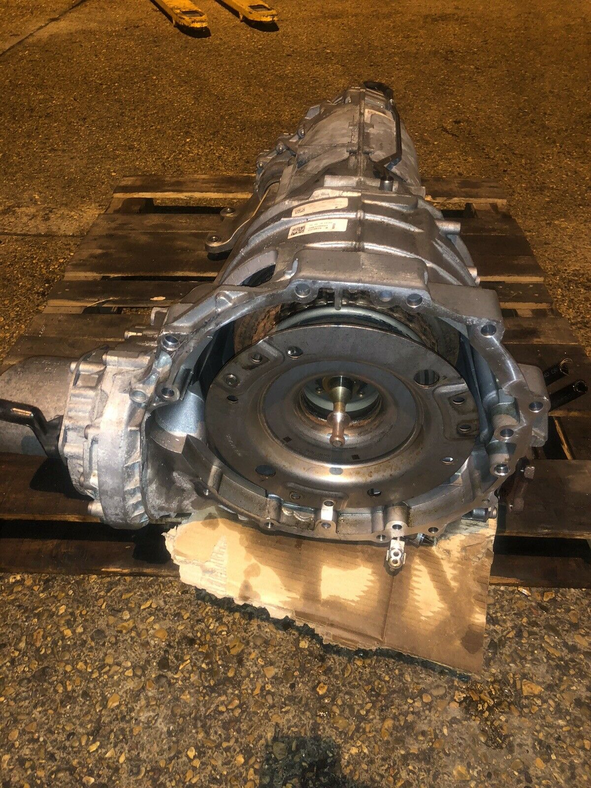

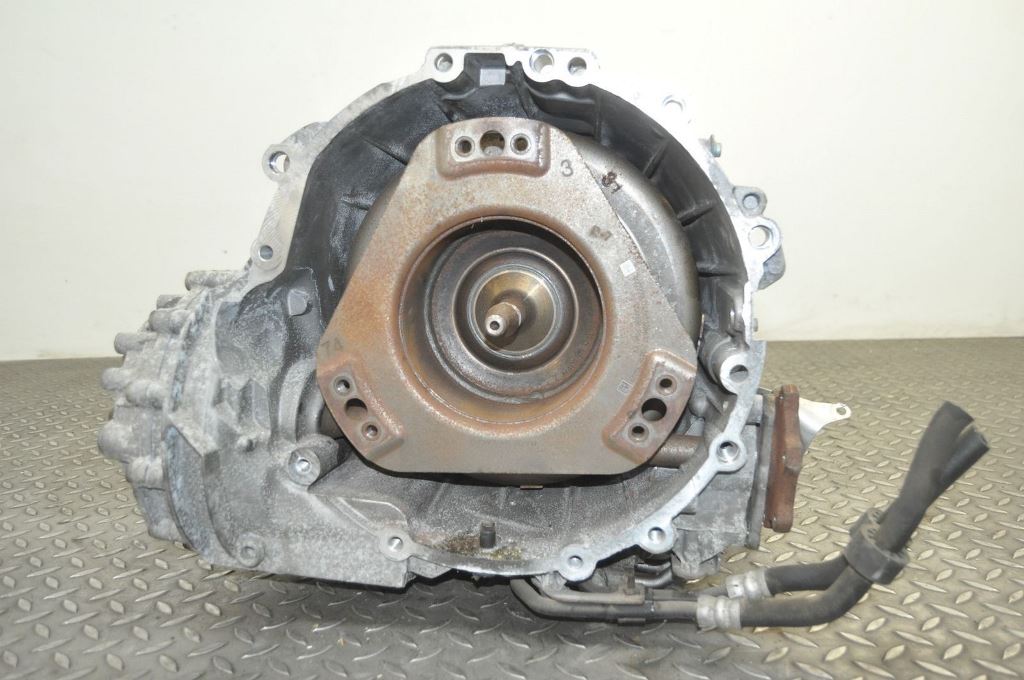

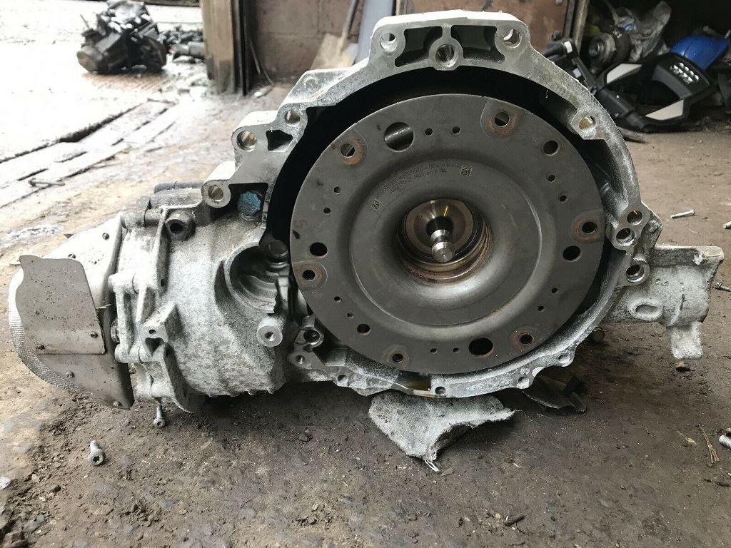

I spent a lot of time looking at the back end of engines and the front end of gearboxes, and noticed that most of the V6, V8 and V10 engines in the VAG group looked remarkably similar, and so did their mating transmissions. Things like the bolt hole positions and the stater motor location all seemed the same. Here's the back end of a V10, and the front end of a 6HP26A:
When the 8HP came along, it looked rather like the 6HP28, with a different casing, a circular torque convertor drive plate, a straight prop-shaft tube, the bell housing is shorter (allowing the engine to sit further back), and the LHS output shaft was moved outboards, so the drive flanges were symmetrical with the centreline, and the front drive shafts could be made equal length. It's fairly clear this won't bolt up to the V10:
However, the 4.0 V8 and the ZF 8HP were fitted to the Bentley Continental GT and Flying Spur mid-life update around 2012, and the 4.0 was based on the V10 - same bore, same stroke, and similar bell housing as it turned out. The rest of VAG moved on, but Bentley ALSO wanted the same 8HP to fit the old W12, which had only been partnered with the 6HP26A before (same as the RS6 C6). Therefore they needed a bellhousing adapter for the new gearbox so the engines could stay in the same position. There were other accommodations to minimise changes, too. Here is the back end of the Conti GT 4.0 engine with the adapter fitted, and the front end of it's transmission:
Notice that the LHS drive shaft is very short, like the 6HP26, and the flex-plate to torque convertor mounting bolts are grouped in three places, not six.

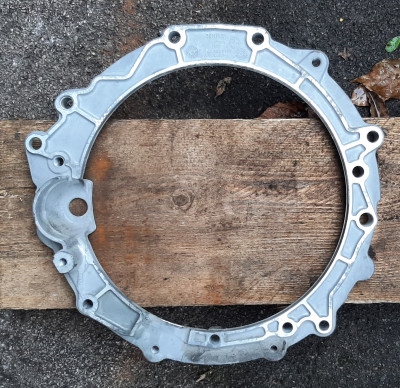

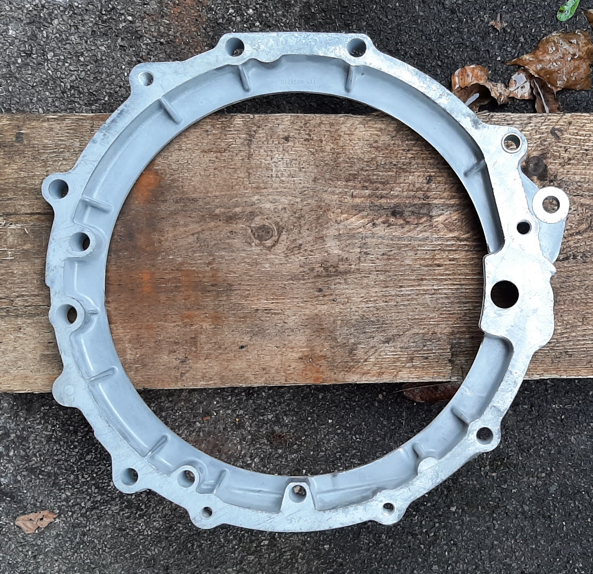

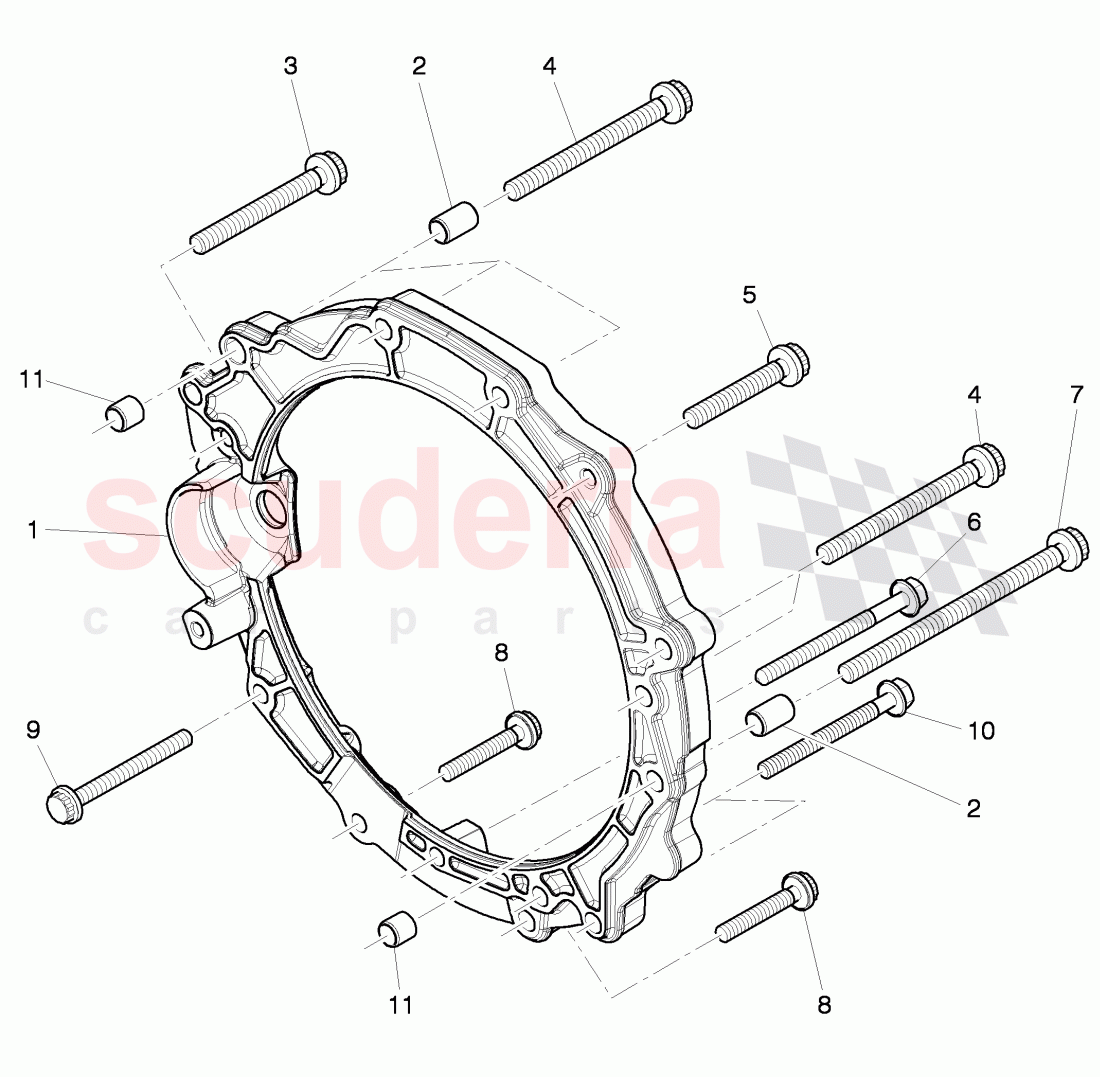

Here's the bell housing adaptor, Bentley part number 3W0 103 546 A:

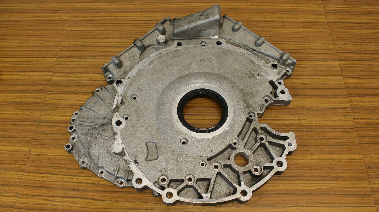

Audi RS6 rear timing cover (provides mechanical interface between 6HP and the back end of the following engine:)

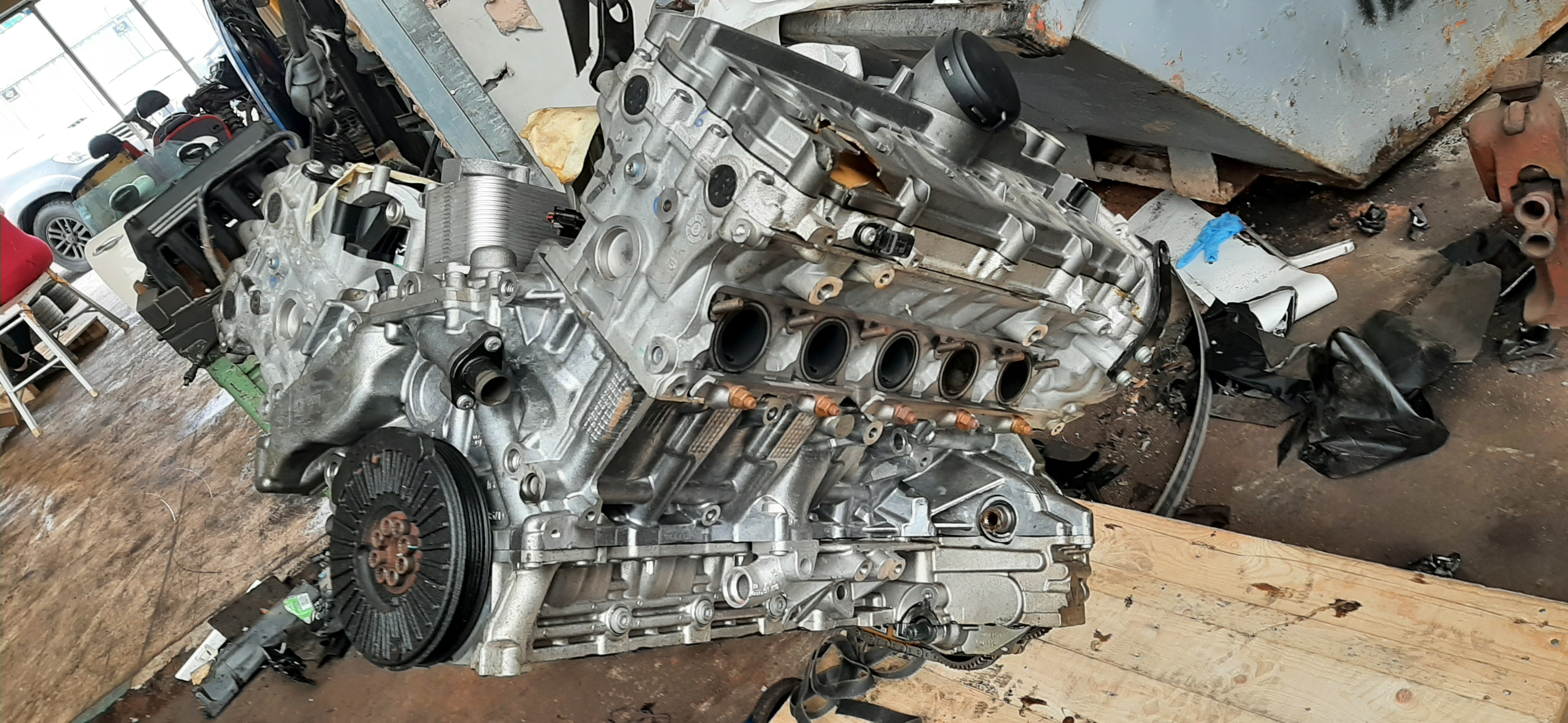

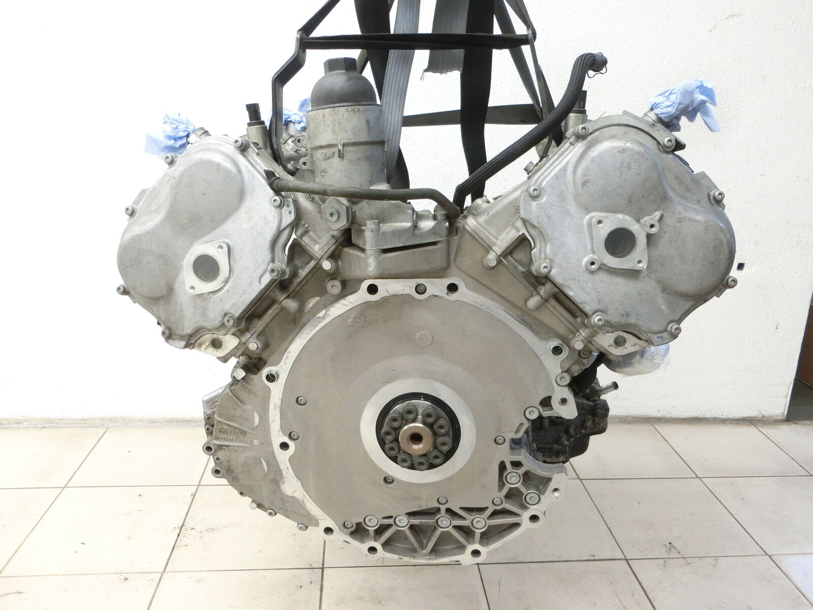

Scrap Audi R8 V10 engine
It got quite exciting at this point. Wanna know what happened when I tried to mate the greatest engine ever made to the greatest gearbox ever made to fit them in an RS6?

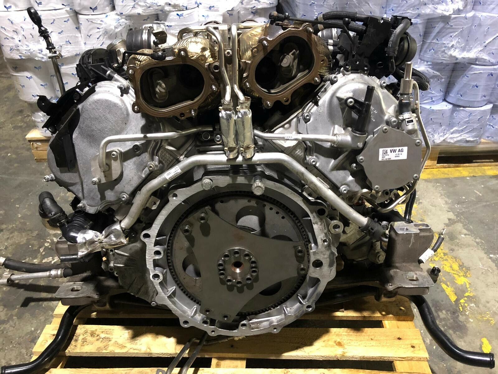

See the pictures on 05 June 2021, comparing the back end of the RS6 and the R8 V10 & Huracan:
viewtopic.php?f=47&t=129086&start=15#p955439
They look very different, but having taken the R8 engine apart, I now have a clearer idea about the differences between them. I'll write it up in the "How high can the V10 rev?" thread, but as far as gearbox compatibility is concerned, the differences are quite simple:
The R8 has a dual clutch gearbox, so the rear timing cover is completely different to match (but is interchangeable with the RS6 timing cover).
The R8 has bearing housings for the prop-shaft to the front axle, and the RS6 does not.
The R8 starter motor and power steering pump are BEHIND the engine, but they're down the side on the RS6 (so a stiffening web is deleted).
There's also a foul between the bell housing adaptor starter motor shroud and the gearbox, but that's a quick hacksaw job, and there's a couple of other minor fouls.
On the upside, with the adaptor in place, the RS6 flex plate simultaneously bolts onto both the R8 crankshaft, and the 8HP torque convertor.
So in short, no, the Bentley 8HP doesn't quite bolt straight up to the Lambo / R8 engine, but .......

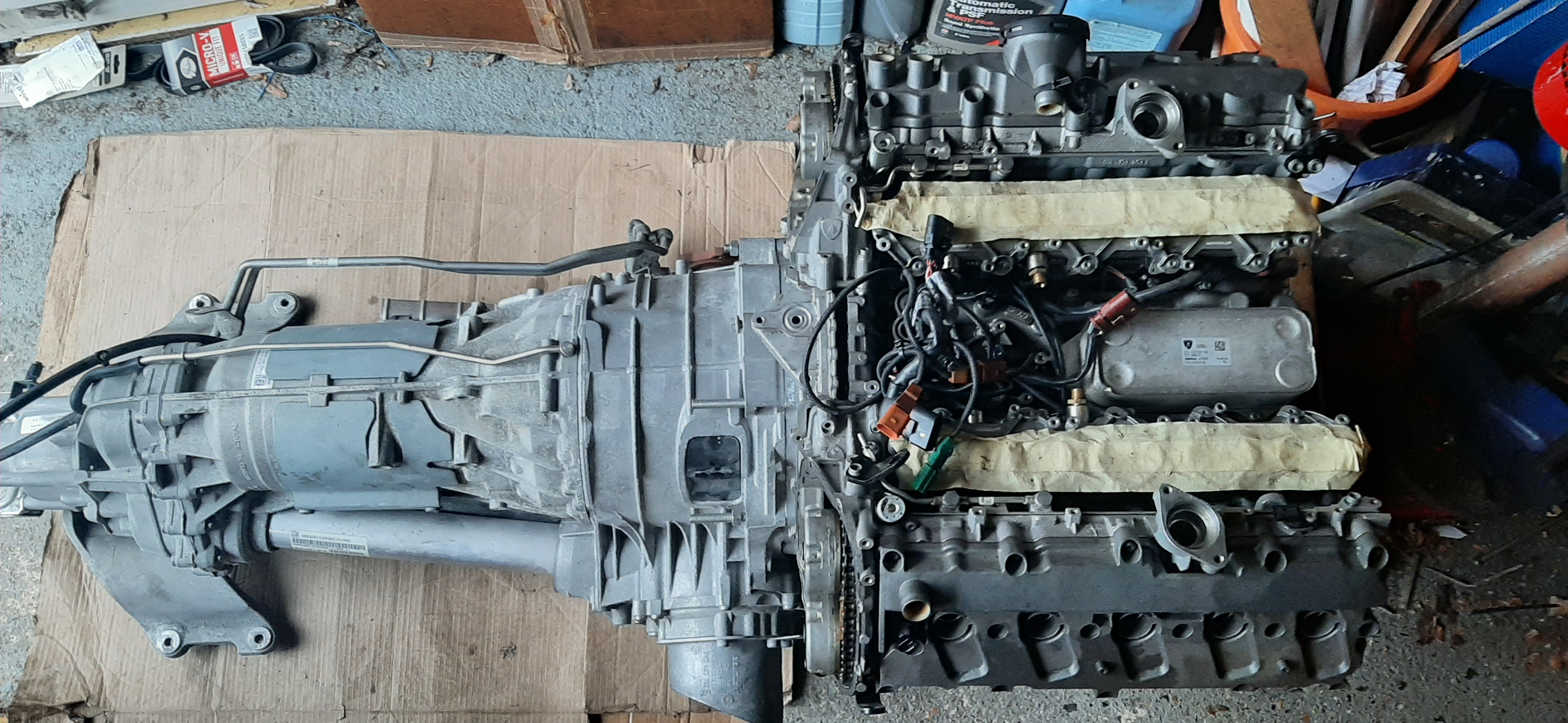

Here's the money shot:
I believe this the first time an 8-speed gearbox has been mated up to a 10-cylinder engine. Long way to go, but very happy with that!
