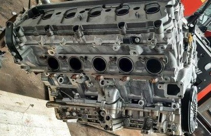

Well, there are lots of pieces to this puzzle, and I just got another one. I thought I'd try to find a scrap RS6 or S6 engine, but it turns out there aren't very many of them.
However I did find an R8 engine, and I've had to find some space in my shockingly cluttered garage.
It's not exactly what I was looking for, but the possibility of having an actual Lambo engine in an RS6 was intriguing. After all, they are the same engine, aren't they?
Nick

Re: 8 Speed ZF8hp from C7 RS7 and RS6 retrofit.
Supposedly the only similarity between both engines is the block. Everything else is different.

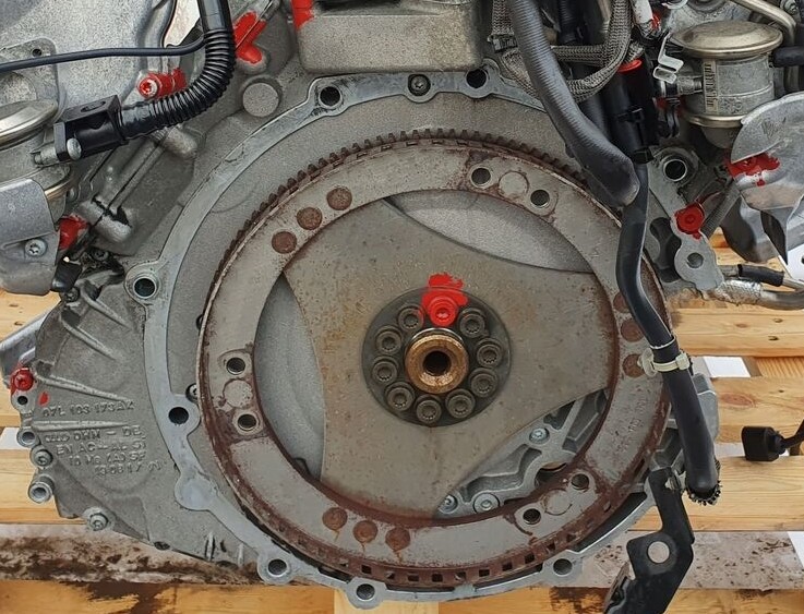

welwynnick
- Posts: 573
What's your source of information? Here's a picture of the back of the R8 V10 engine:
And here's a picture of the back of the RS6 V10 engine:
EDIT: Notice the R8 has the power steering pump in the bottom left corner, and the aperture for the front diff propshaft in the bottom right corner.
Makes you wonder why Audi made a completely different block from the lambo one....then stamped a lambo bull on it....
I'm pretty sure the block isn't the same as the 5.2 but the first gen 5.0 gallardo, but given the displacement difference and having seen countless pieces of information stating that the C6 RS6 shared minimal parts with any 5.2 Lamborghini/R8 I would say it's safe to assume the block is one of the few shared pieces
The oil pump has a bull stamp on it, but I don't know if that is used in any other engines
welwynnick
- Posts: 573
The 5.0 Gallardo block had a bore spacing of 88.0 mm, same as many Audi 4 and 5 cylinder engines.I'm pretty sure the block isn't the same as the 5.2 but the first gen 5.0 gallardo,
All other Audi/ Lamborghini 90 degree V engines have a bore spacing of 90.0 mm, which includes the following:
