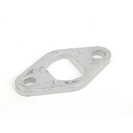

The bar locks the 2 exhaust cams in the correct position. With the crank locked at TDC you then you know the exhaust cams are timed correctly wrt crank.

At the risk of being a pest, could I suggest that the statement above be taken with some additional detail added. The detail actually exists within the greater post but that sentence on it's own may mislead.
The crankshaft pin locks the crank in the necessary position. The timing belt drives the camshafts via two toothed belt pulley's. The pulleys are positioned on the camshaft via a taper so they are infinitely adjustable. The quote above is only true if the crank lock pin is in, the cam mark and the camshaft cap / head mark are aligned and the toothed belt is tight.
Re: RS6 Timing belt replacement DIY
I disagree. The cams have 2 flats on them to allow the precise positioning of the the thrust washer that the locking bar pins fit into. This means that if the cam locking bar is on then the cams are in the correct position.
Correct. I do this infrequently and looking at the parts drawings it showed a round hole. No doubt for simplicity!!
