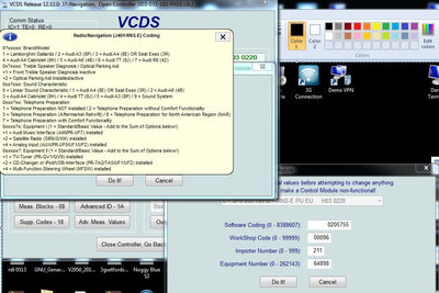

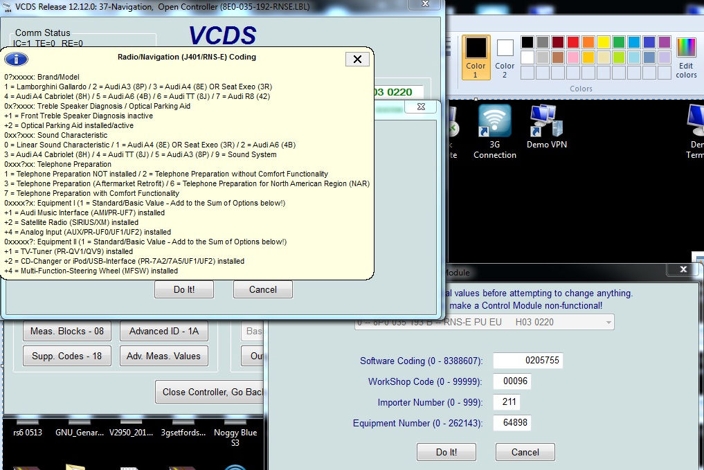

1. I can't stand the metal part on the RS4 standard wheel. I turn in to roads etc one-handed most of the time and for parking etc I do the same. I normally use the bottom of the wheel a lot so the metal drives me mad and I don't use that part of the wheel at all. I am contemplating having the TTRS MFSW wheel fitted, which will include relocating the Sport button to the dash and a new right stalk for all the menu functions. It is strong money (that I should be saving, not spending currently!!!!), is it really worth it? Heart is telling me yes, head is telling me no! I do have a BT kit sitting here that has to be added in too. Do I "have" to do SDS at the same time, will I really use it? Pretty sure I have a H revision 2012 RNS-E
2. I had the time to check the coding on the RNS-E that I put in yesterday and it is way off. I have done a best guess for what the coding should be but can anyone help confirm please. I am going with this so far:
03?91??
1st ? - Treble Speaker Diagnosis/Optical Parking Aid – No idea what the first one is and I have standard front/rear sensors for parking, nothing else.
Sound Characteristic – She has Bose so going with 9 there?
2nd ? – No AMI, no Sirius as not a Yank, no analogue input, so should that be 1?
3rd ? – It has the TV Tuner (not that it is of any use) and it has a cd changer, so should that be 4?
Thanks guys.

I reckon it's dead easy, read the coding/adaptation guide on the Ross-Tech wiki http://wiki.ross-tech.com/wiki/index.ph ... 28RNS-E%29 then write down the values in your current RNS-E and just make them the same in the new one.neilparf wrote:I take it any correcting, clearing and coding is straightforward? Pretty savvy regarding these things... VCDS on its way.
- PetrolDave
- Posts: 7599
Re: New B7 owner, prepare to flame for being lazy!
See http://wiki.ross-tech.com/wiki/index.ph ... 28RNS-E%29 you need 0309114Mr Footlong wrote:03?91??
You also need to set adaptation channel 8 to 255 to turn off GALA (not needed with Bose AudioPilot which is what we have).
- Mr Footlong
- Posts: 4331
Lol, that would be fupping logical and really obvious, should have thought about that thanks, will stick the old lump in tomorrow and see. What I will say is that even before the swap, Vagisil was reporting back that the defunct TV tuner wasn't coded anyway
