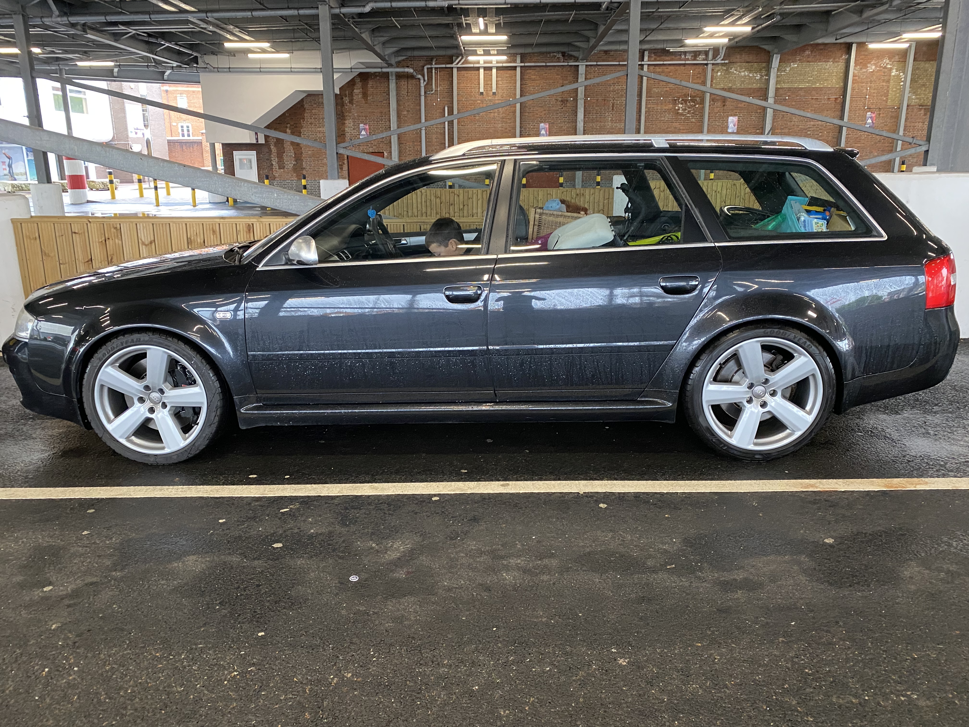

Post by Mɐʇʇ » Sun Jul 25, 2021 5:58 pm
Mine on the Konis earlier today waiting to get on a ferry. You can see it sits nice and level. I wouldn’t want it any lower either.

Nice level indeed, do you remember which ride height you choose for the rears, top, mid, or low?
