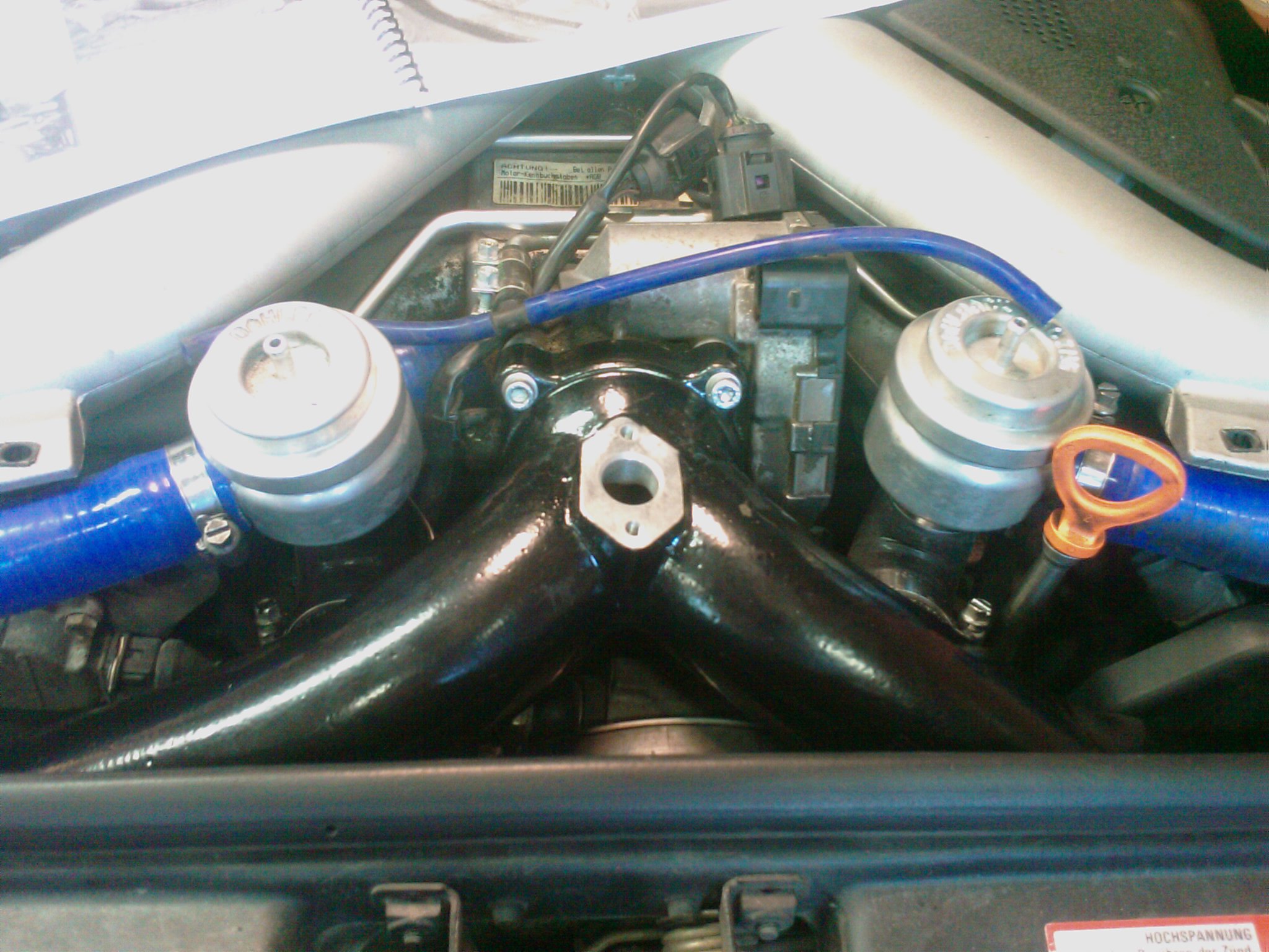

Post by Keihin » Tue Jun 17, 2008 12:26 pm
Installed! But a couple of bumps:
1. Right lower mount point broke off the cambelt shield. Not sure if it's because the round shape didn't line up or the pipe just is to hard to bend until it settles. Seems the fan doesn't touch anyway. Not sure if I will try to replace the cambelt shield.
2. Forge resirc. valves are positioned to high to refit the front engine cover. Will pinch the vacuum hoses if I press it on. Not sure if I should try to cut the hoses or turn them around. Someone told me that they're supposed to be horizontal, not vertical?

Post by Doug_S2 » Tue Jun 17, 2008 12:40 pm
stock is the other way around - you can trim the right angle silicon hoses a bit to make them sit a bit lower

Post by Dippy » Tue Jun 17, 2008 1:41 pm
Every S4 I have seen has the DVs 'horizontal'. I think the point is that the air pressure comes from the bipipe side, and the way Keihin has them now this will be pushing directly against the piston and maybe could force it open???
