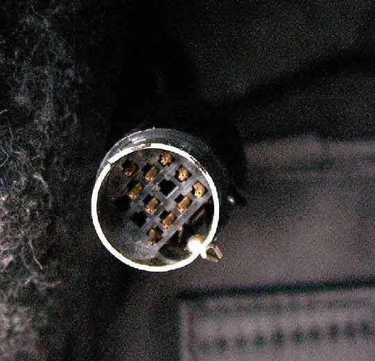

ZeroK66 wrote:I cannot find the cable - all I found was a 4 pin lug - no round connector :(.
I bought my S4 without a factory fitted Cd changer. Previous owner never got one fitted but i did have the cable. Had to root for it behind carpet by rear light. It was cable tied to the chassis and should look like this.

I am 99% sure that if you didn't have a CD-changer when the car was built, you won't have the cable.
It so not too hard to add a cable, but it does take time to fit - maybe 1 or two hours. The worst part of it is trying to remove the B-pillar trim without snapping the lugs (I failed).
However if you also don't have a cage, considering that the damn thing doesn't actually fit there without cutting a hole in the door, why not fit it in the glove box? Running a cable there will be a p-o-p.

Post by s4-99 » Mon Apr 10, 2006 7:07 pm
Thanks Paul for the info and pic. I'll get one and sort out the fitting when it's in my hands. I can see your 3 bolts/screws in the picture, they are at the front easy to get to!!!! Mine are a little more awkward to reach than that from what i can see. I'm sure i'll get there in the end :D

Post by shineydave » Mon Apr 10, 2006 7:52 pm
just unscrew the trim along the bottom of the boot opening and remove. you'll then be able to pull the liner to one side and get to all 5 screws with ease, takes all of 2 minutes
