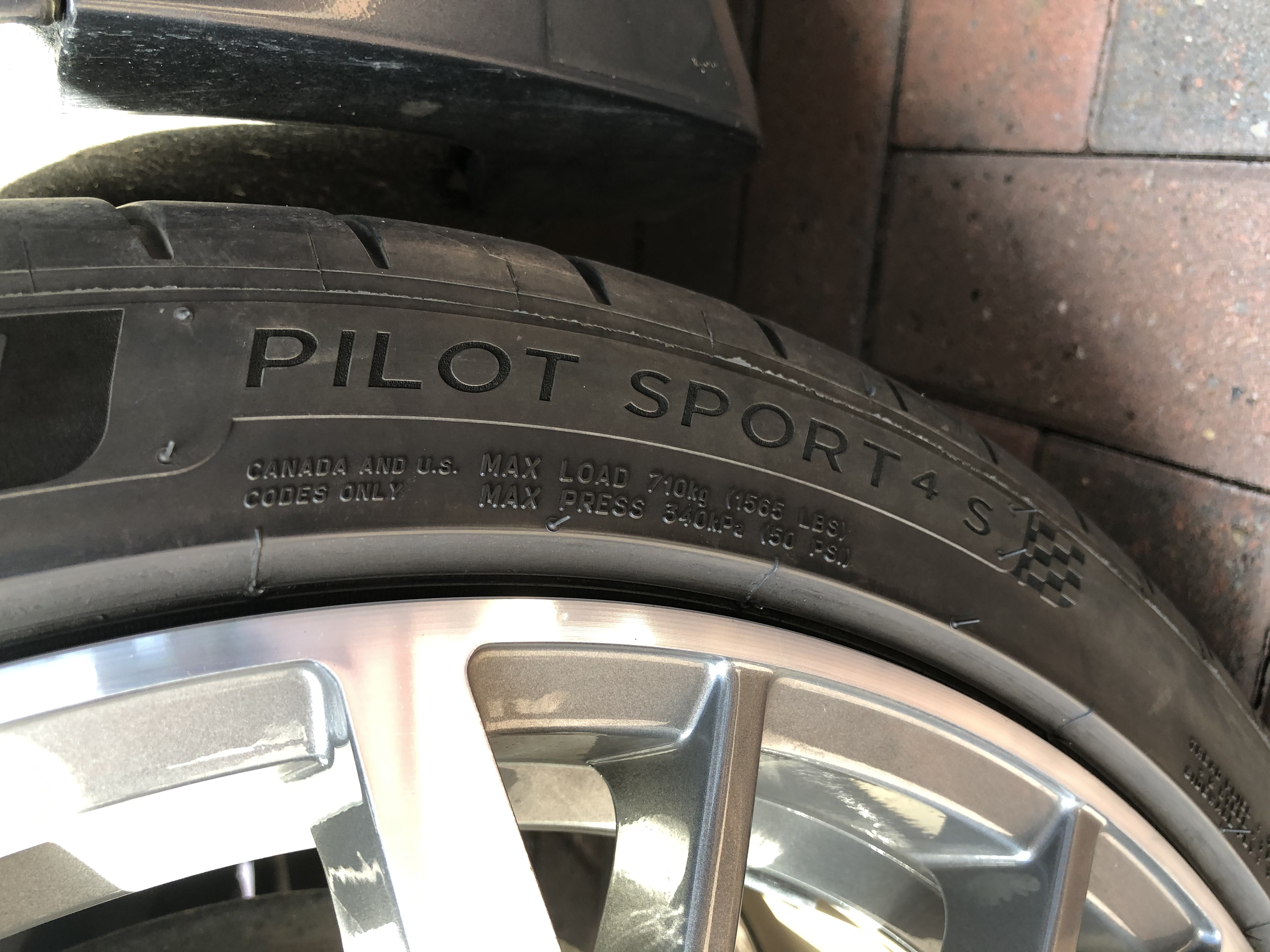

Had me wondering which ones I had fitted so went out and checked. Pilot sport 4S
Currently on 255x35x19
However the 255 does not provide any protection for the rims. The rims are 19x9j et35
When they come up for renewal was considering going to 265.
But I haven’t looked in to it too much as the tyres on at the moment are fairly new.

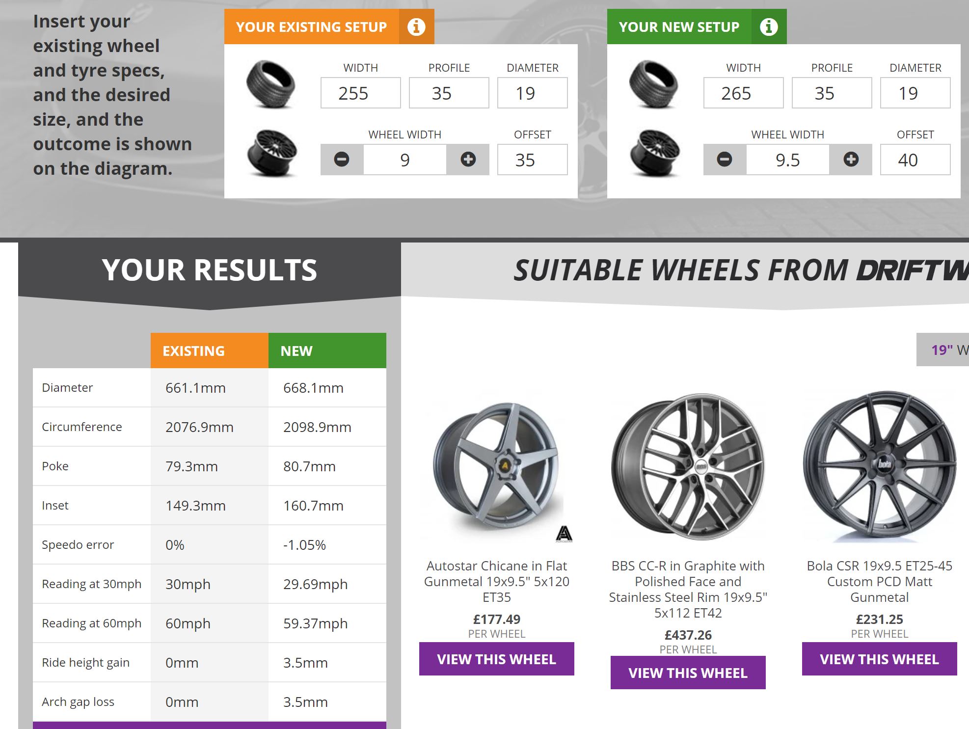

I also have the P-SP 4 S 255/35ZR19 following Shop's advice.
I have a wider rim at 9.5 x 19ET40.
I've also been considering switching to 265 when the time comes.
Interestingly when I check on will-they-fit there is no difference in diameter using the 255/35 tyre on a 9.0 vs 9.5.
In my mind this can't be right?
Also, if I were to switch to the 265 I'd get the below difference.
Would this in any damage the vehicle?

Exactly. Also have to remember the knob on the front suspension upright and clearance.Shoppinit wrote: ↑Wed Apr 14, 2021 3:37 pmI wouldn't. It'll change your rolling radius. Just avoid curbs.steve2003rs6 wrote: ↑Wed Apr 14, 2021 3:14 pmThe rims are 19x9j et35

Many thanks guys. Will definitely retain the existing set up.
