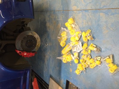

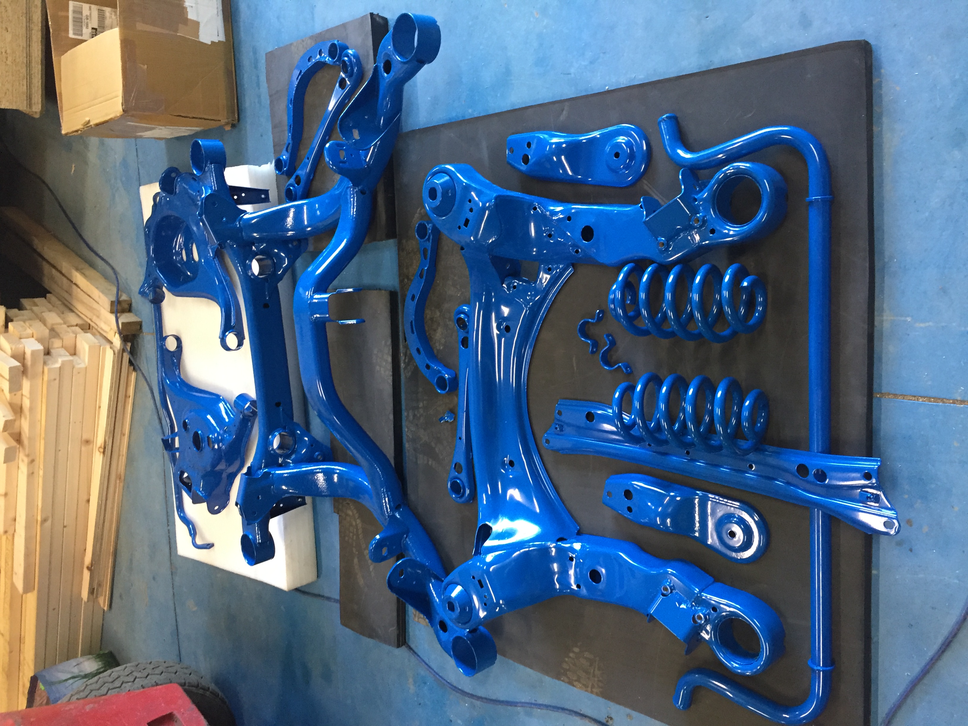

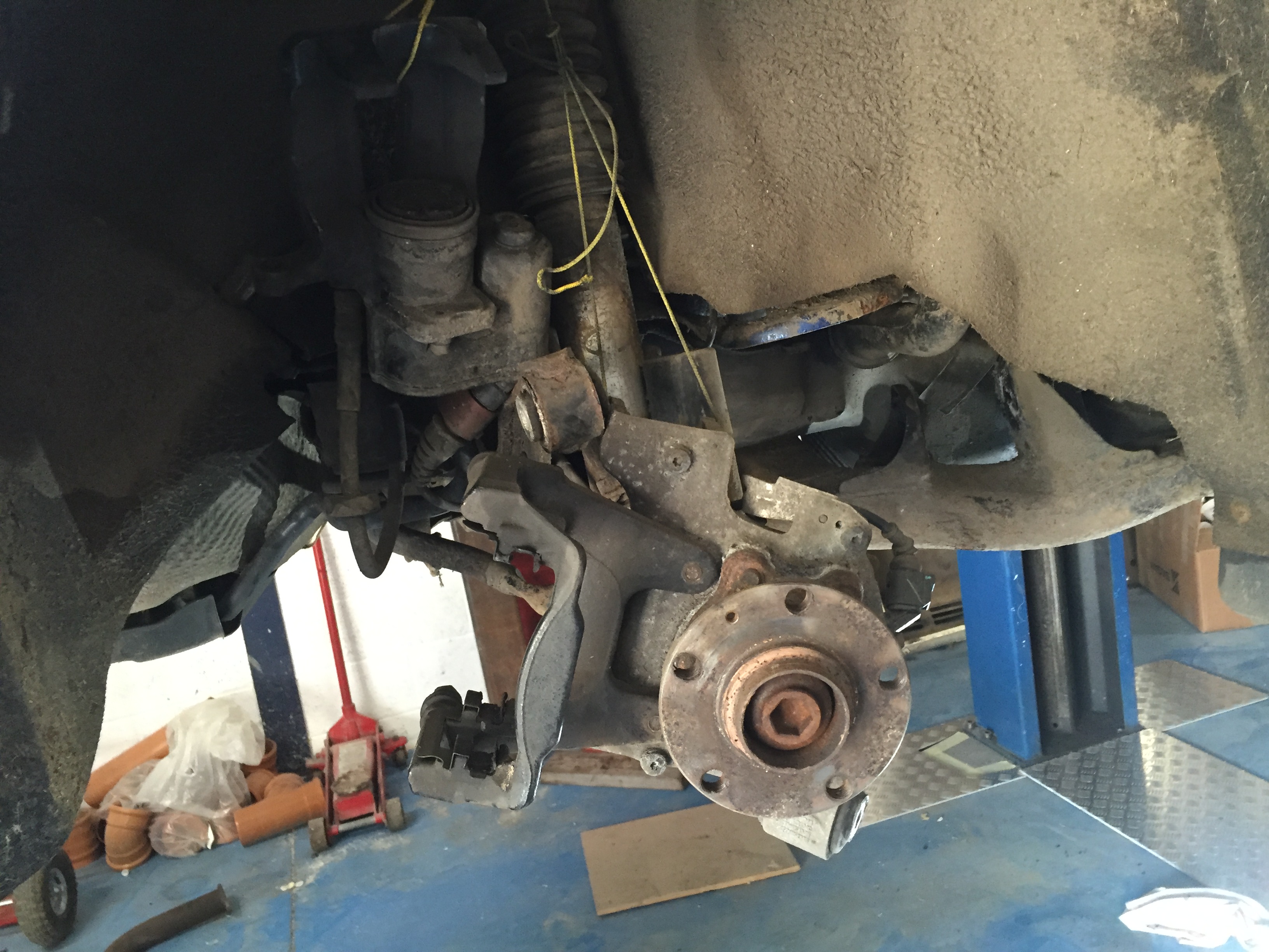

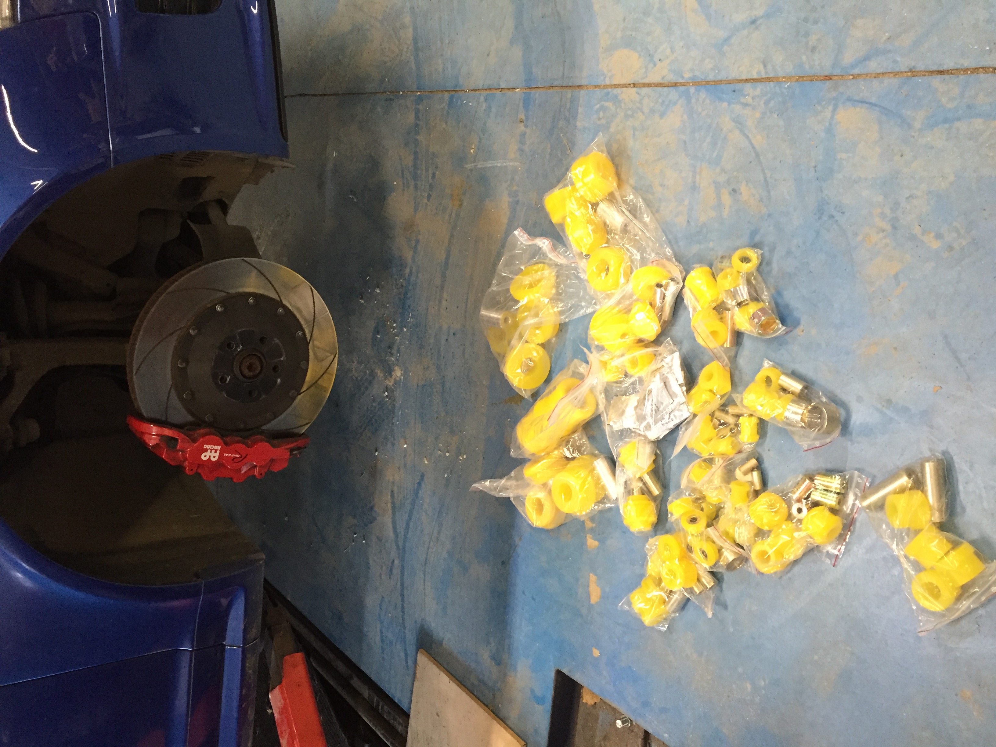

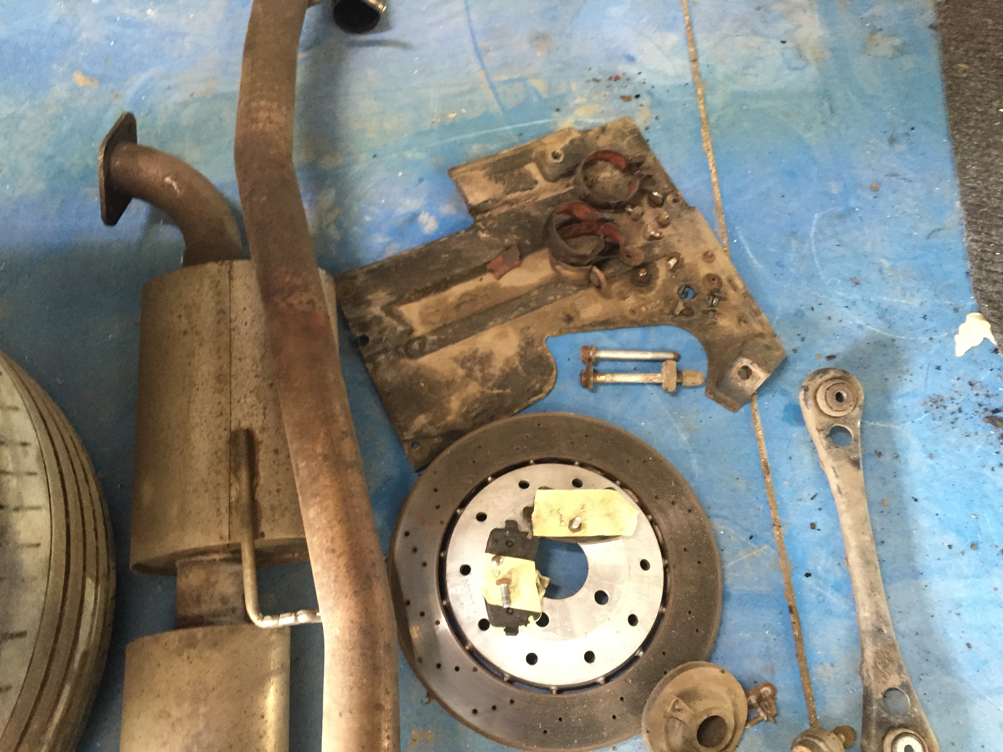

her'es an update - car on ramp and suspension coming out, around sailing and work, may take a few weeks

yes - but it aint a small job. all and it mean all the suspension has to come out to replace the bushes, so powder coating everything whilst it's out... me thinks a nice blue to offset those nice red AP racing calipers you like Ian
I will need to get tracking set once back together up again
wondering if any other tweaks are worthwhile seeing i have it all in bits?
? spring change
? stiffer a/roll bars
? spring change

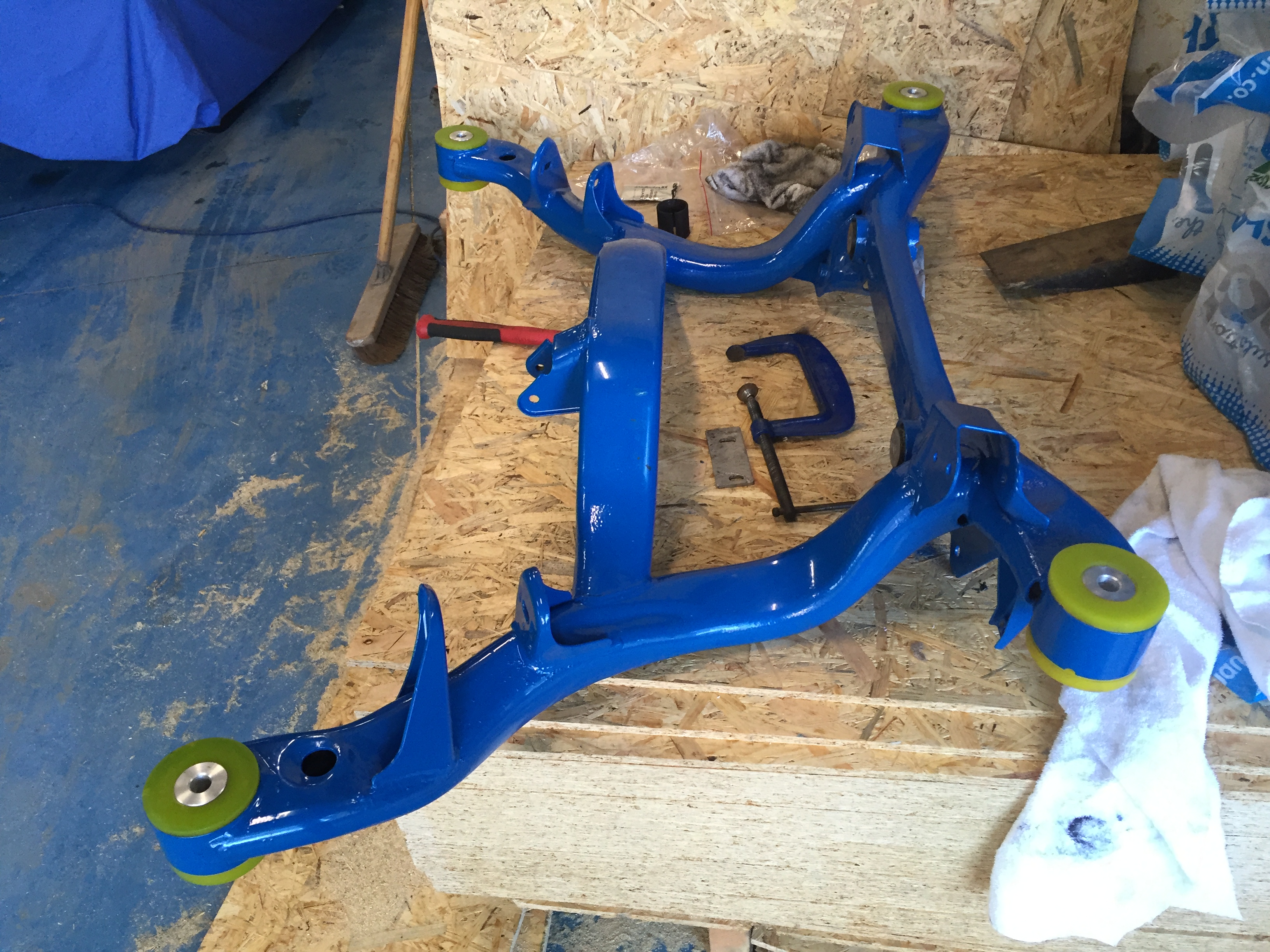

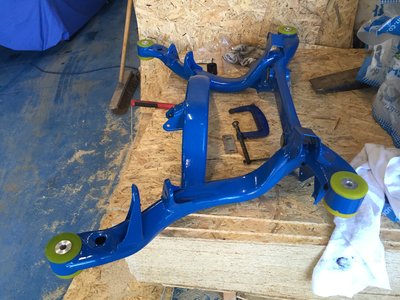

an update - been sailing too much
bushes are going in - so far simple enough
went a bit blue on the sub frames
