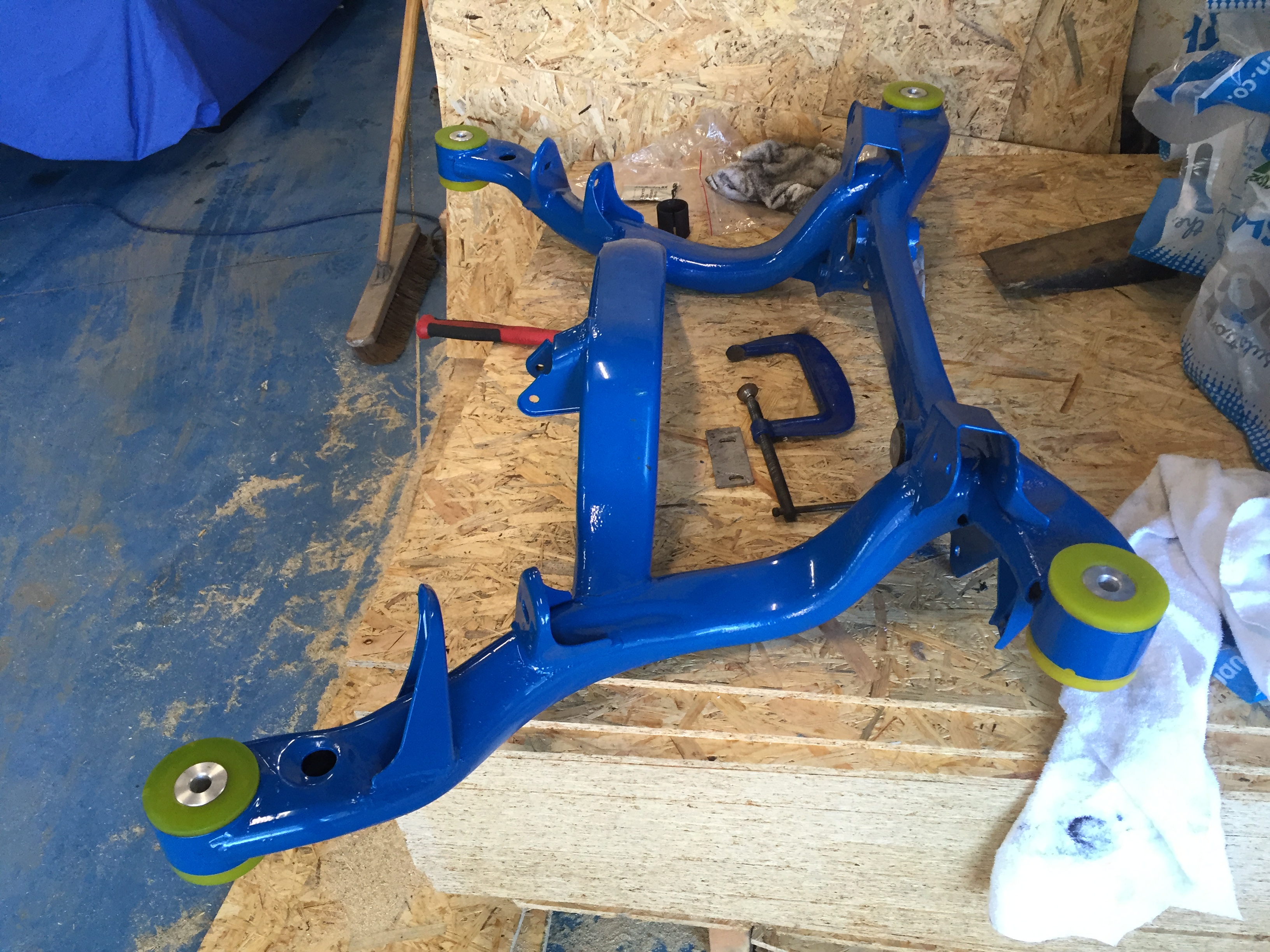

Post by RossH14 » Mon Jul 17, 2017 6:36 pm
an update - been sailing too much
bushes are going in - so far simple enough
went a bit blue on the sub frames :-)
