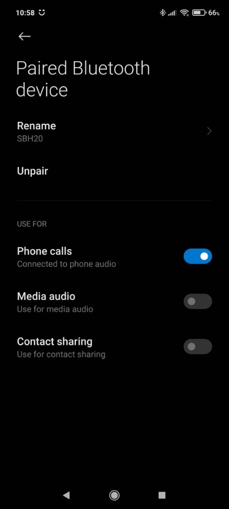

Have you made sure you've given access as per the attached (android).
It's in your Bluetooth menu. After you've paired with the headunit, click on it in the list of bluetooth devices.

Yep it has access for calls.
