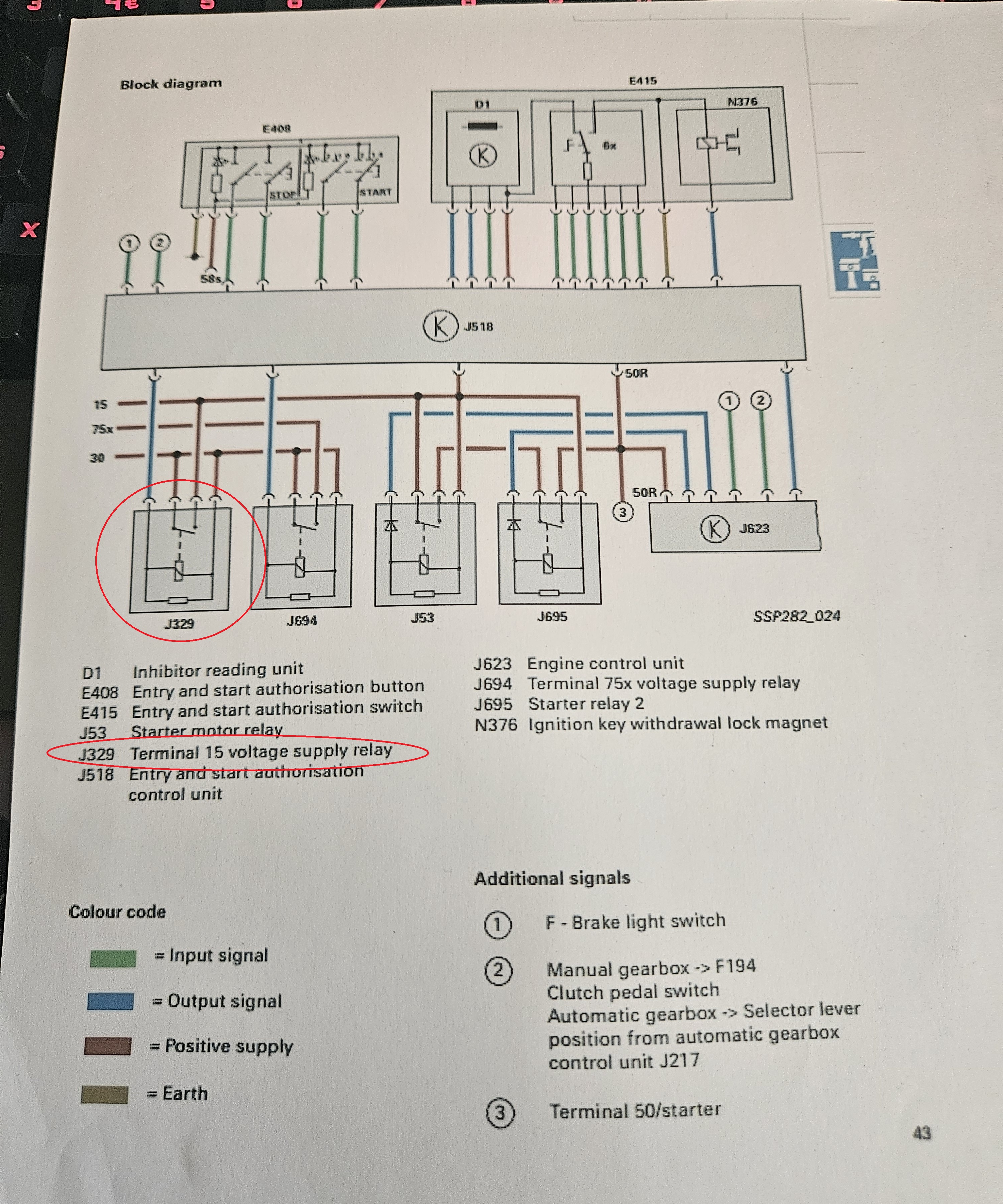

I still want to identify the feed for measuring block 3 (terminal15 supply) as I not 100% I have found and fixed the issue so want to make sure I now where the supply is if I have any future issues. I did find a wiring diagram online which showed that the relay block under the dash as the relay that supplys voltage to terminal 15 , J329 , which is the supply for Term15 which is what I belive Measuring block 3 is referncing.I belive its the far left relay out of I think the five relays.
So when I get a cjance I am goiung to get measuring block 3 up on VCDS and remove relay j329 to see if the referenced voltage dissapears.this will at least confirm where the supply comes from for term 15 if I need to do anymore testing down the line.

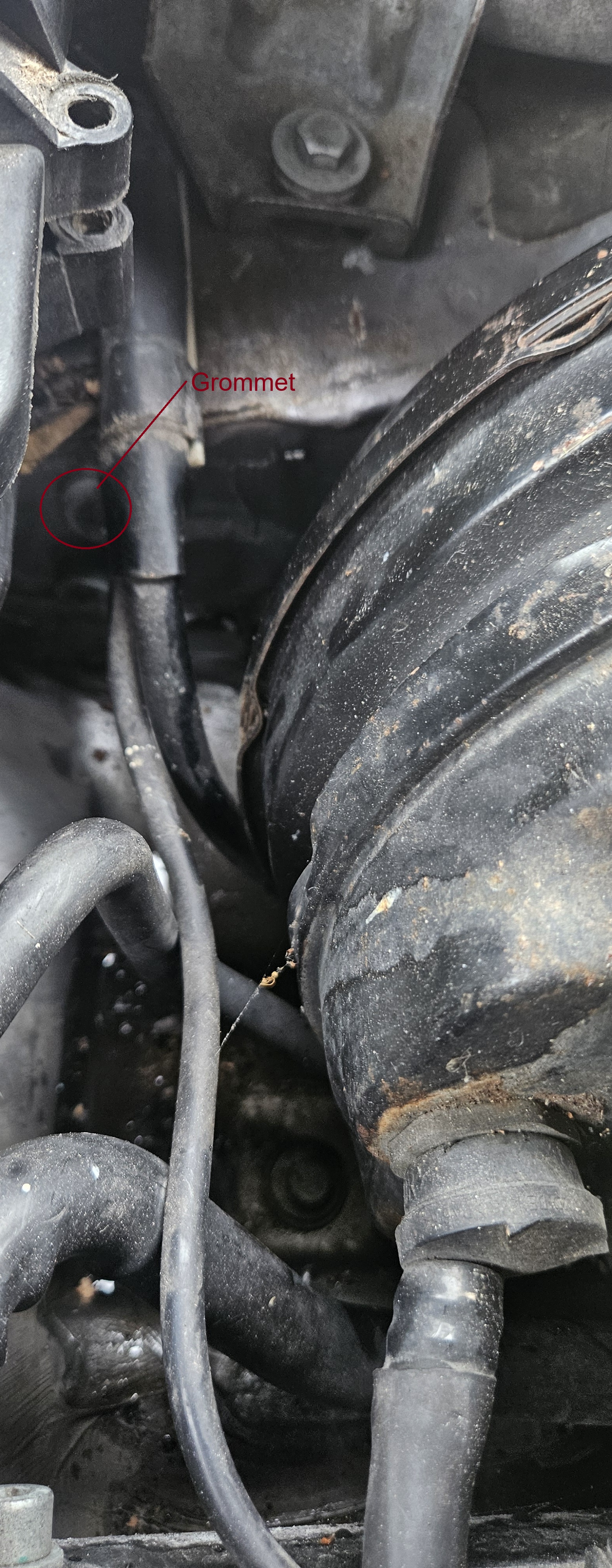

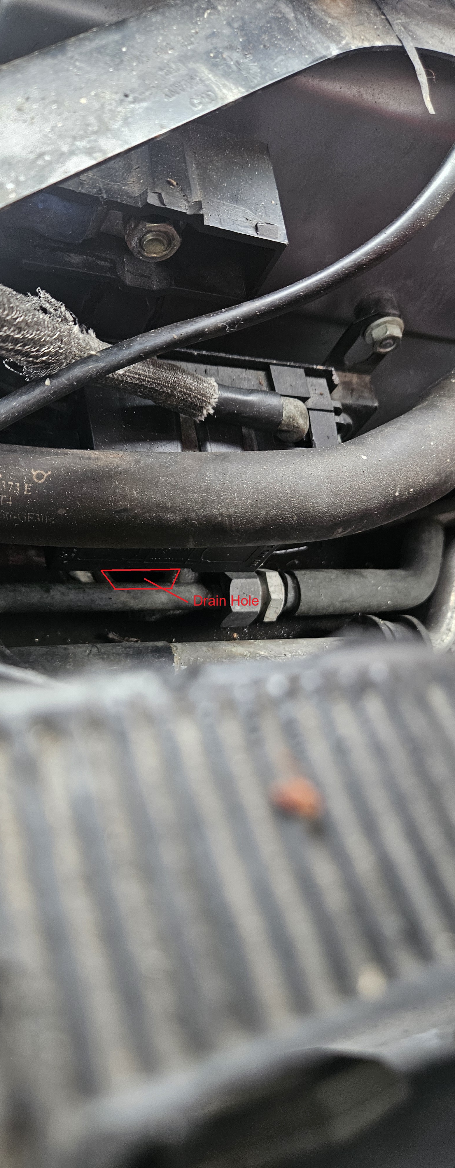

Regarding the water ingress it was a combination of a few things , the scuttle panel not seated onto the bottom of the windscreen , this was letting water into the central scuttle area where the Coolant resevoir lives , then I found the central drain under the main fuses was blocked so the central scuttle area was inches deep in water ,upon sticking a pick into the drain there was a bit of resisitance then the water poured through the drain and onto the floor beneath the car, then there was an open grommet next to the ECU housing , so when the central scuttle filled up the water it just poured through the open grommet into the drivers footwell.
Drain hole
open grommet location

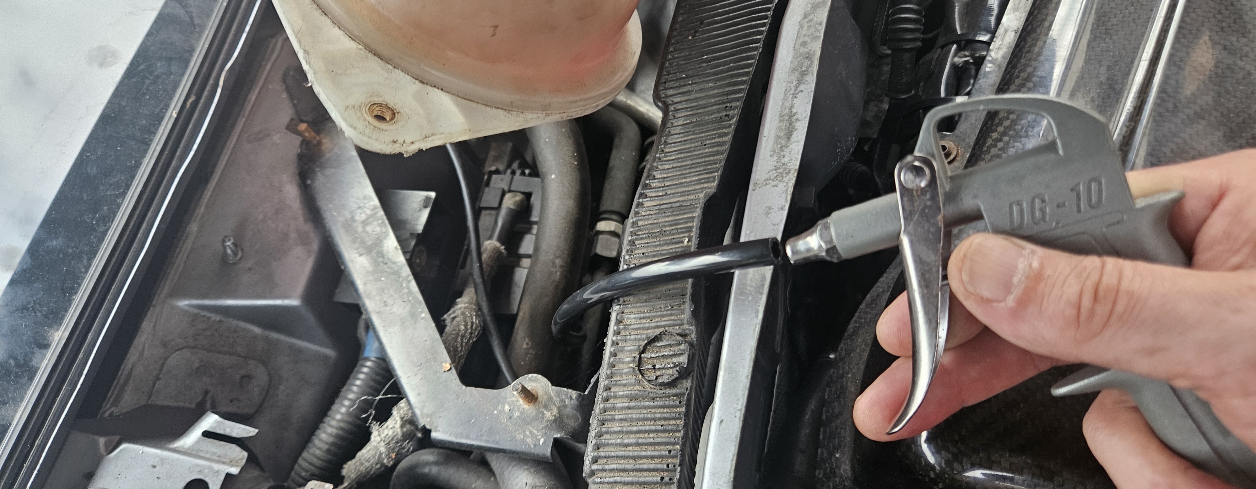

putting a pipe down drain hole to the blow through with airline
I had the entire scuttle out last year and cleaned the drain out at the time but within 12 months its blocked again , the RS6 usually lives under a car cover so I have no idea how its getting blocked so quickly.will have to make rgular checks now to check the scuttle drain.
Drain hole
