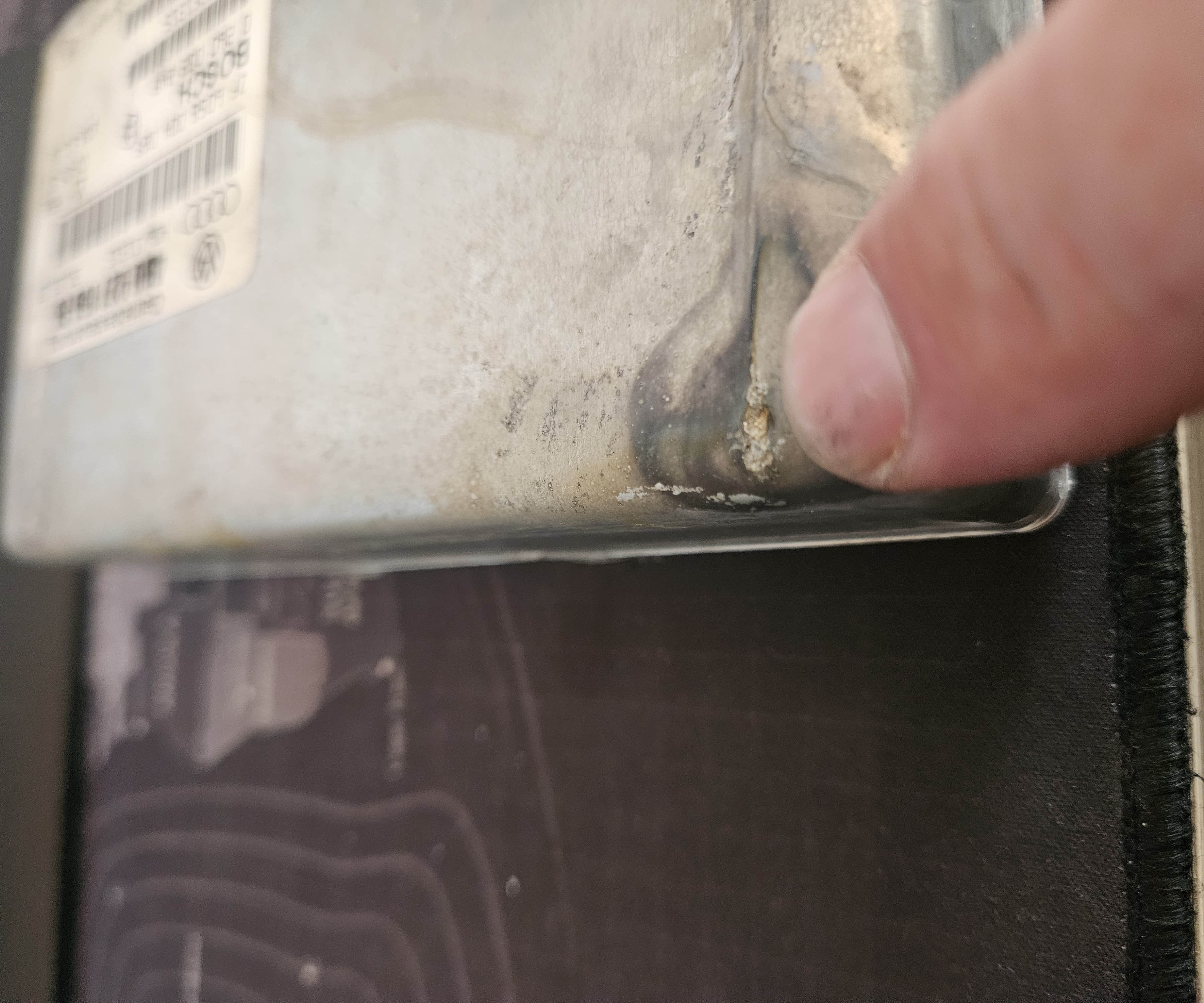

As if by magic ,passenger well ,bone dry ,drivers side foot well ,soaking wet ,water poured out of plastic box that TCM sits in , think I was just in time ,I can see where a power cable has been arching to enclosure which I think was throwing the short to ground code.
Inside of TCM is dry .just some green corrosion on connector pins but internals look fine
Will clean everything ,dry out foot well ,refit and test and will report back

Post by Shoppinit » Wed Jun 25, 2025 3:24 pm
What do I win?
If it were me, I would wash the lot with isopropanol to get the water out and let it dry thoroughly. And clean those contacts as well as possible with a tooth brush and isopropanol. Same for the mating connector.
Obvs the leak needs to be sorted.

Post by Shoppinit » Wed Jun 25, 2025 4:19 pm
I'm seeing a lot of corrosion on the PCB. You *definitely * want to clean that off and hope that it hasn't weakened the solder joints.
