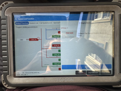

Just had a chance to run a diagnostic scan at a friends who had the software and kit.
This is the error im being met with…..
Not sure if anyone has seen before
