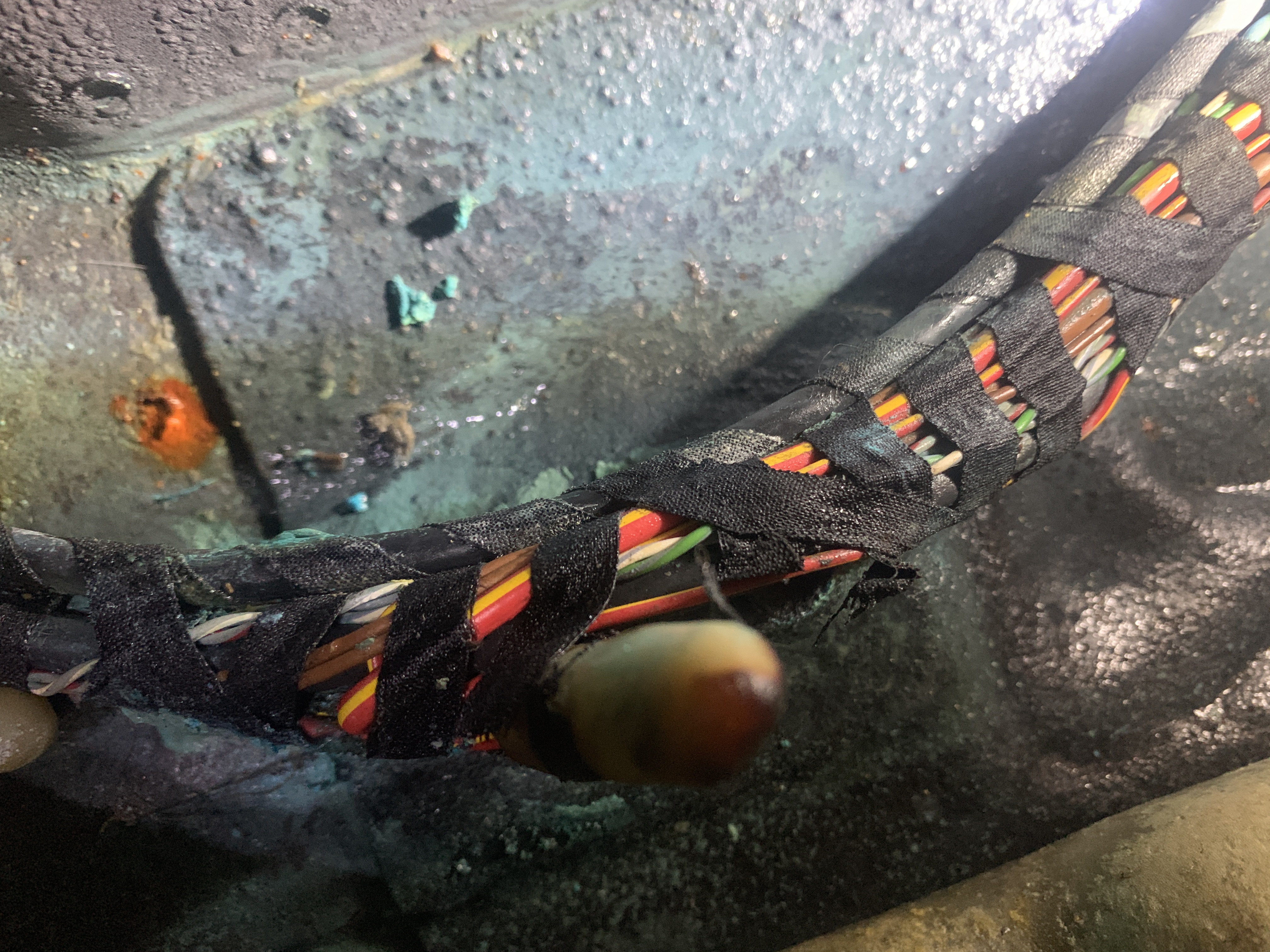

Sounds similar to the issues I was having. Although I have RNS-D. There were about 7 wires terminated in one bullet looking crimp if I recall, passenger side uk car along the transmission tunnel. Below the inner seat runner. Was green full of verdigris. Chopped out and reterminated and got sound back.

Many thanks guys especially Nobbsy and 111marc111 bang on diagnosis. What a <beep> design exactly like the old Sharan I had :audibash:

What a shameful bodge from Audi.

Without the help from here I would of spent days ripping the car apart trying to find it. I never would of thought to take the seat out and look for wiring along the Transmission tunnel.

I have sound now but still no radio reception on any frequency, Anyone had this before. Anyone have a wiring diagram for the diversity system? I was hoping the wiring fault I found would resolve this problem to but alas not.

All fixed, RNSE aerial converter was faulty.
