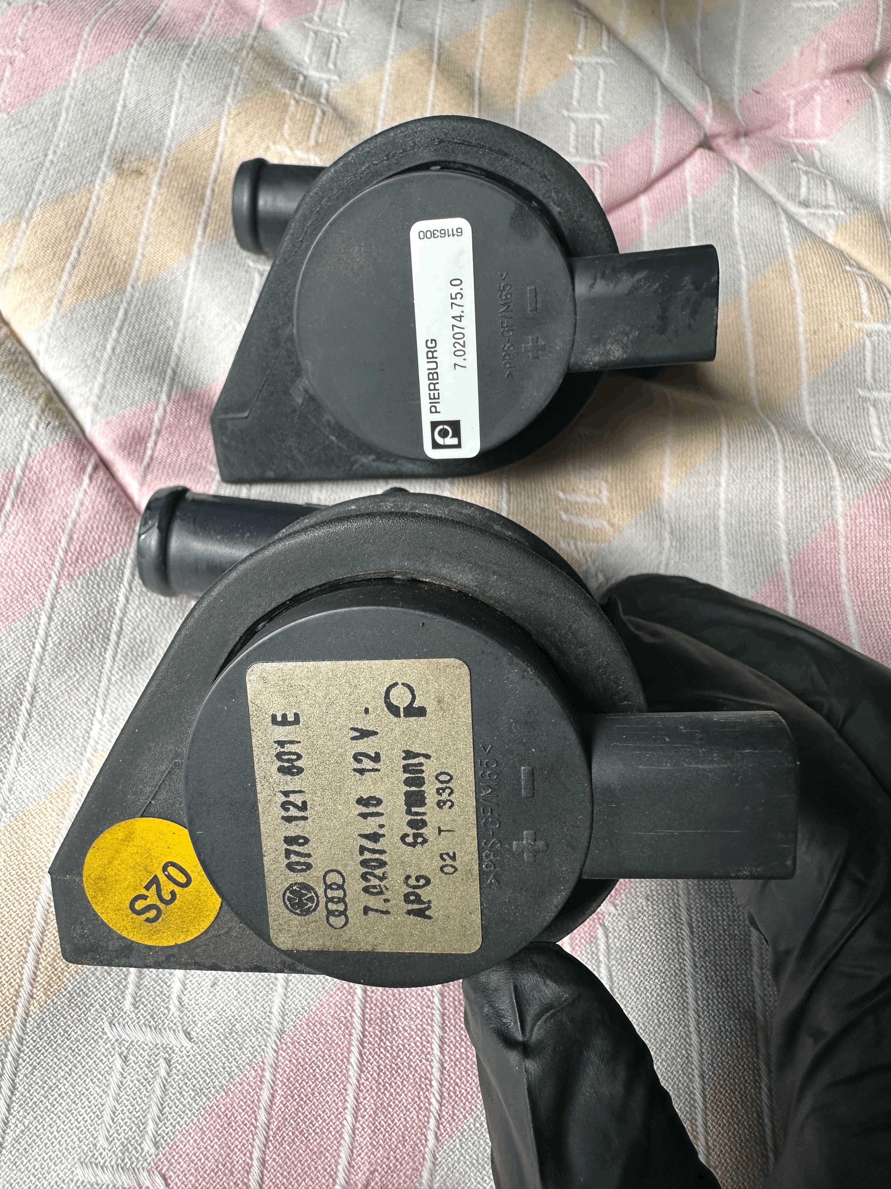

I cross-referenced the pump from many pictures to a Pierburg 7.02074.75.0 from the C6 RS6 and some other newer Audi models. I can confirm it works perfectly.

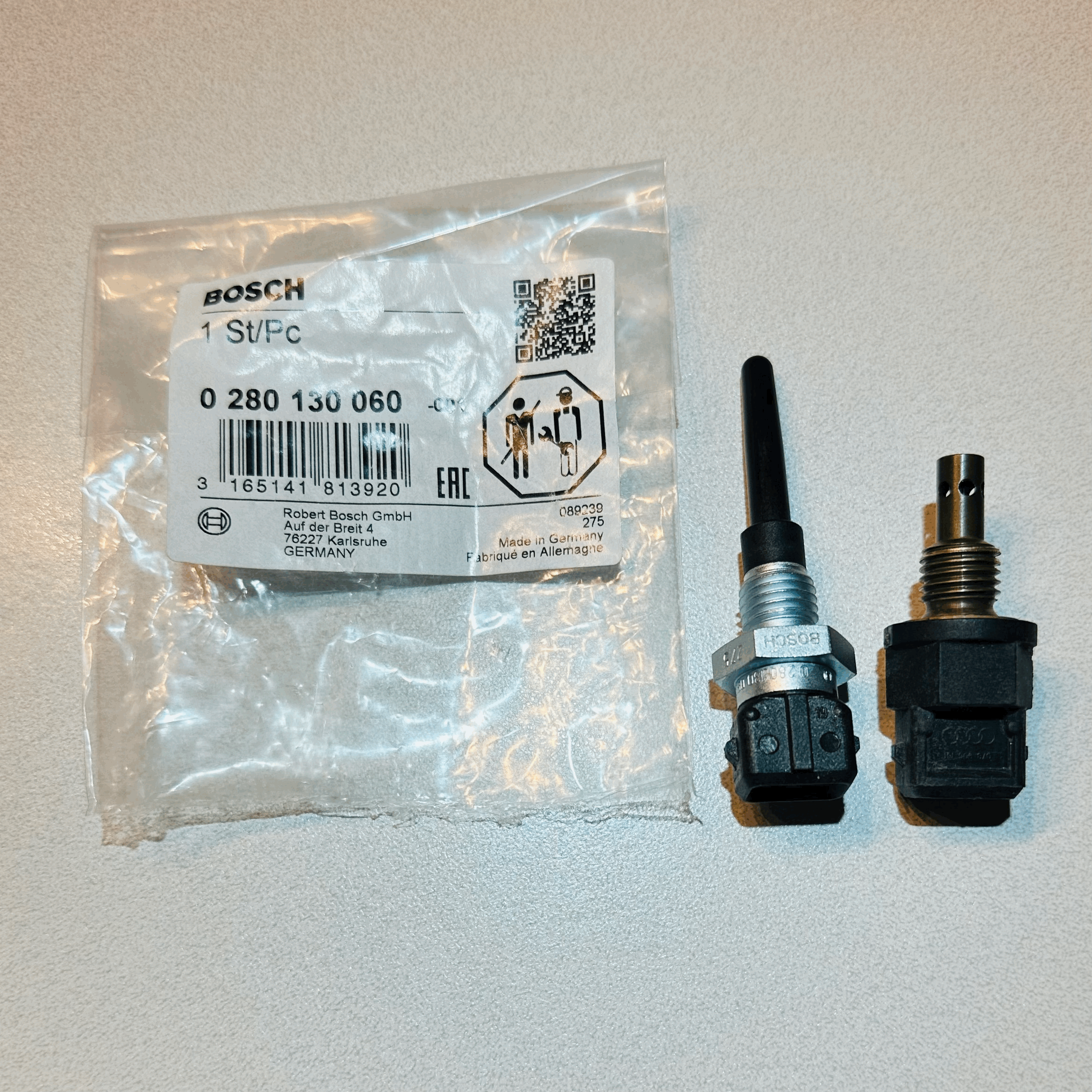

I contacted Bosch about the IAT and they gave me part number 0 280 130 060 and I can confirm this is fine also, even though different.
Buy whichever SJP you like, I bought Stark brand, but they are all pretty much the same.
