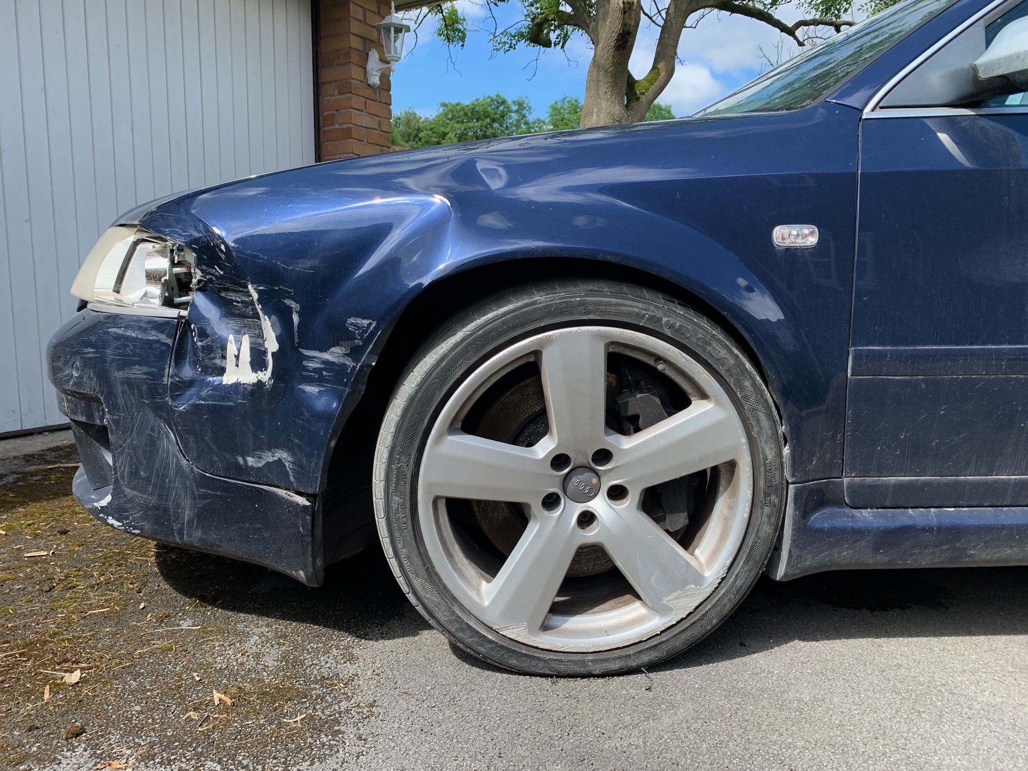

Re: Slow/stiff steering
I am also suffering with a similar issue. Mine was involved in an accident which pushed the wheel back into the arch. Replaced the damaged arms and it looks to sit nicely now. However it makes a whining noise when turning left and right and is more prominent on full lock. Trying to work out if its the rack, pump, belt. Also I have the ABS & ESP lights on which when scanned return the dreaded 'brake pressure sensor' code. Interestingly, when turning the steering wheel the 'fault in brake system' warning symbol then flashes up. Look forward to hearing what they say about yours when you get it back.
Hi,
Mine made the same noise when I was close to full lock both ways.
It was stiff to turn the wheel even with the engine off. Sadly looking at the damage your car has had and what the guys at the steering rack rebuild place said, it's common for the rack body to bend.
Mine was bent. Luckily the bodies from lesser A6 C5 models are all compatible, and the inner parts were fitted into a replacement body. I have not had a chance to fit it yet. But it's certainly very smooth to turn the rack by hand compared to what it was like after removal.
If you want any more details regarding getting the rack out message me and I can give you some pointers. It's a real pita.
